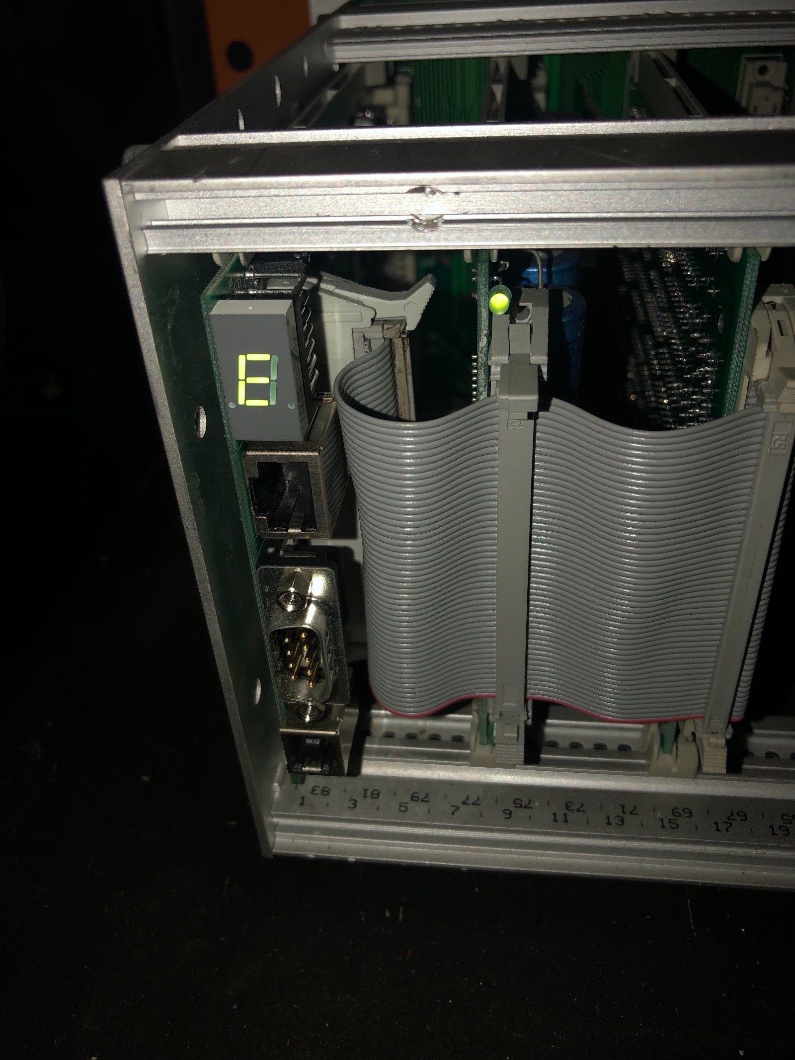

The machine is running a Eurostep controller card and has been USB upgraded at some point.
I have tried to identify the EPROM but may be missing something, as the boards do not look like any I’ve seen on other posts…
There is a USB lead coming from the MINT card, to a small device, and it looks like it is missing a 8-15v dc power supply, I assume 12v, I’m wondering if this device is common/needed to power the usb to the pc.
The led cycles through, spelling PESto… of PE5to… maybe this means something to someone?!
The parallel port and 3.5” disk drive have been cut off, so I’m hoping to get the usb system working!

That all looks good.
The PCB is a USB isolator & does not require a power supply. It protects the control card if the spindle motor flashes over.
It looks like you will need VR CNC Milling V5 & depending on what you are planning to do or already have design wise, QuicCAM 2D Design & QuickCAM PRO.

It seems the ‘device’ is essentially a surge protector for the PC.
(Unless someone can correct me!)

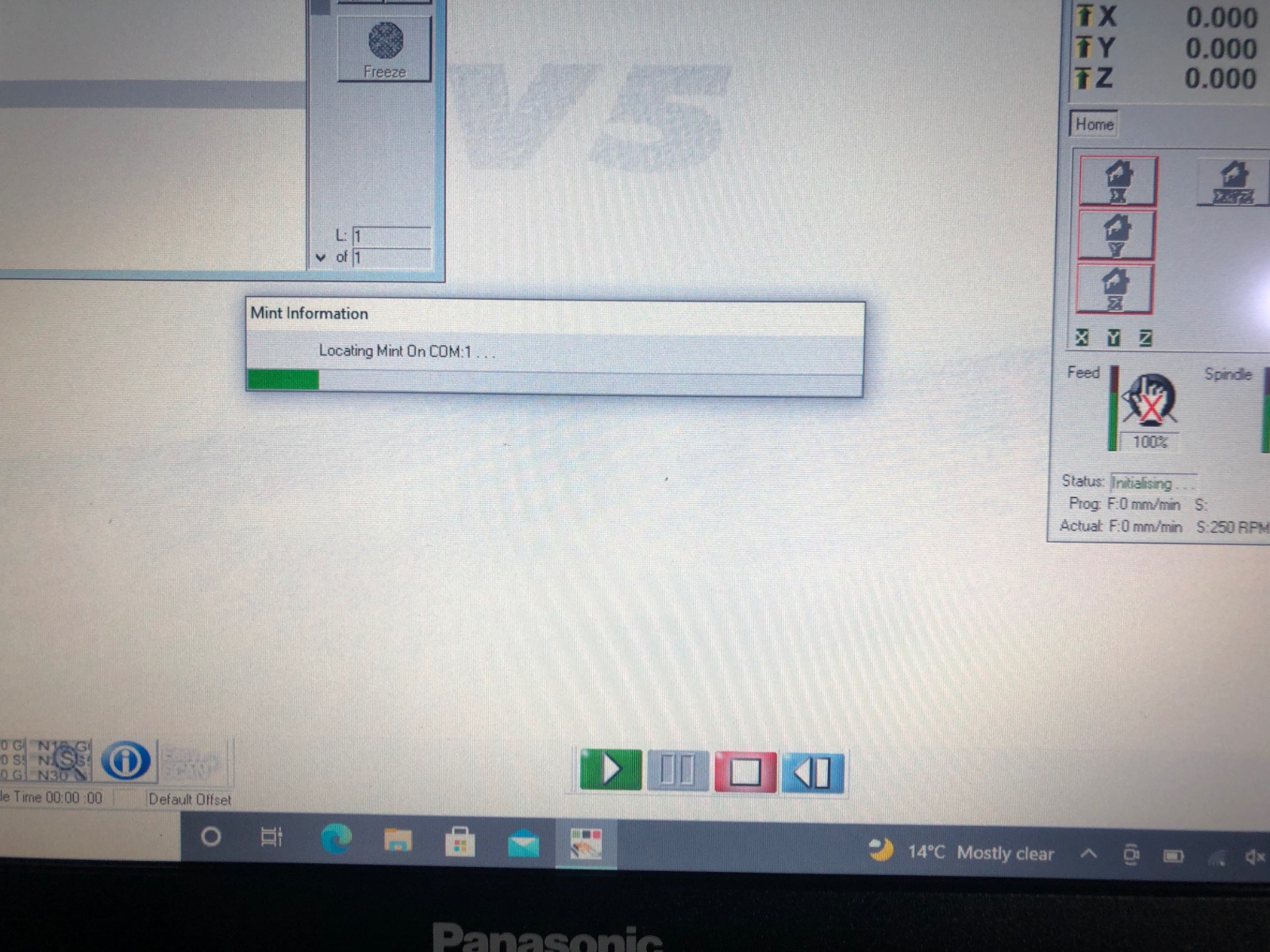

Tried with a 12v psu, but no difference in connecting.
Have run through the machine types and getting closer…
Looks like it maybe a pc issue now?
Need to make a usb look like the com1 port…? Maybe!

Re: QuickCAM License Cost
The small red board shown above is a USB Isolator. These have been fitted to Triacs to prevent damage to the control card in the case of the spindle flashing over to earth. If the motor has had a stall and has flashed over internally then some of the earth current will travel to earth through the USB bort and ground through the computer. If a machine has had a spindle stall it can write off the communication through USB so to prevent this happening again we fit the iscolator. It would normally indicate that the spindle motor is probably in need of a refurbishment.
