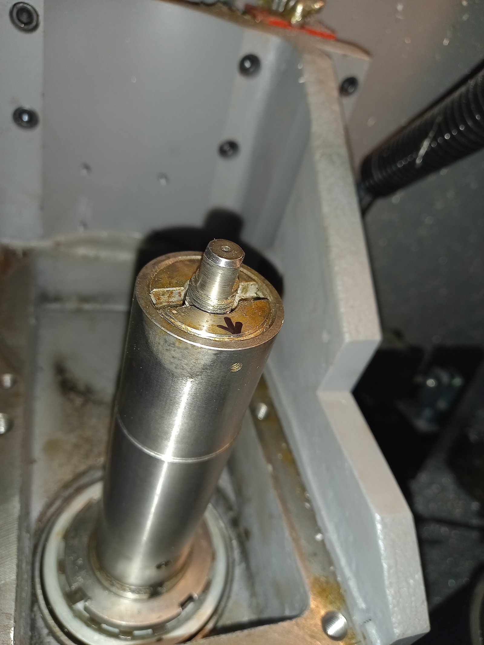

On replacing mine
Bearing on vmc1300 2009 7208ba snr
Go very easy and don't use hammer on anything
