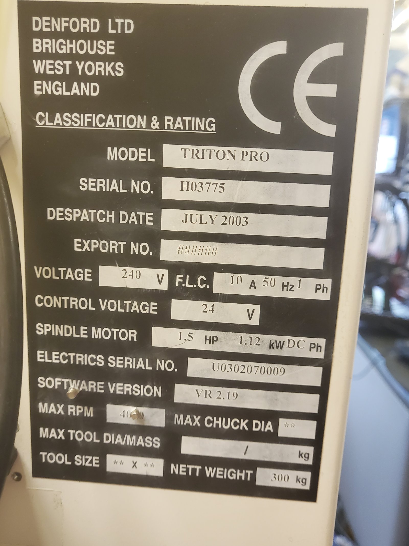

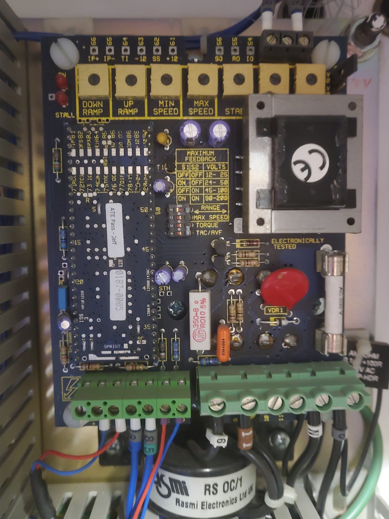

Can you confirm the serial number of the machine & what spindle drive is fitted.
Re: Triton pro questions - need help

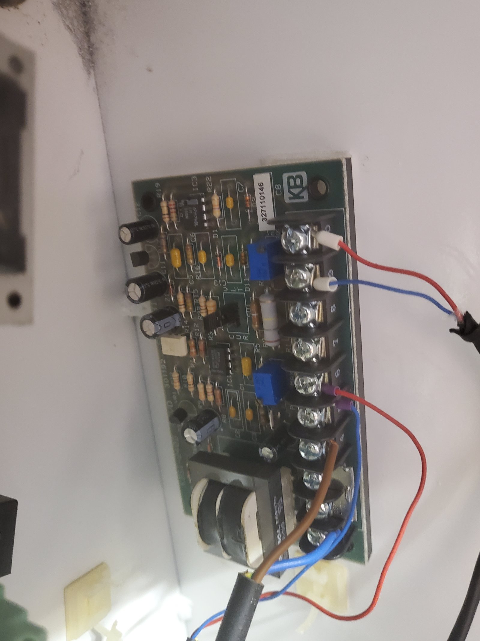

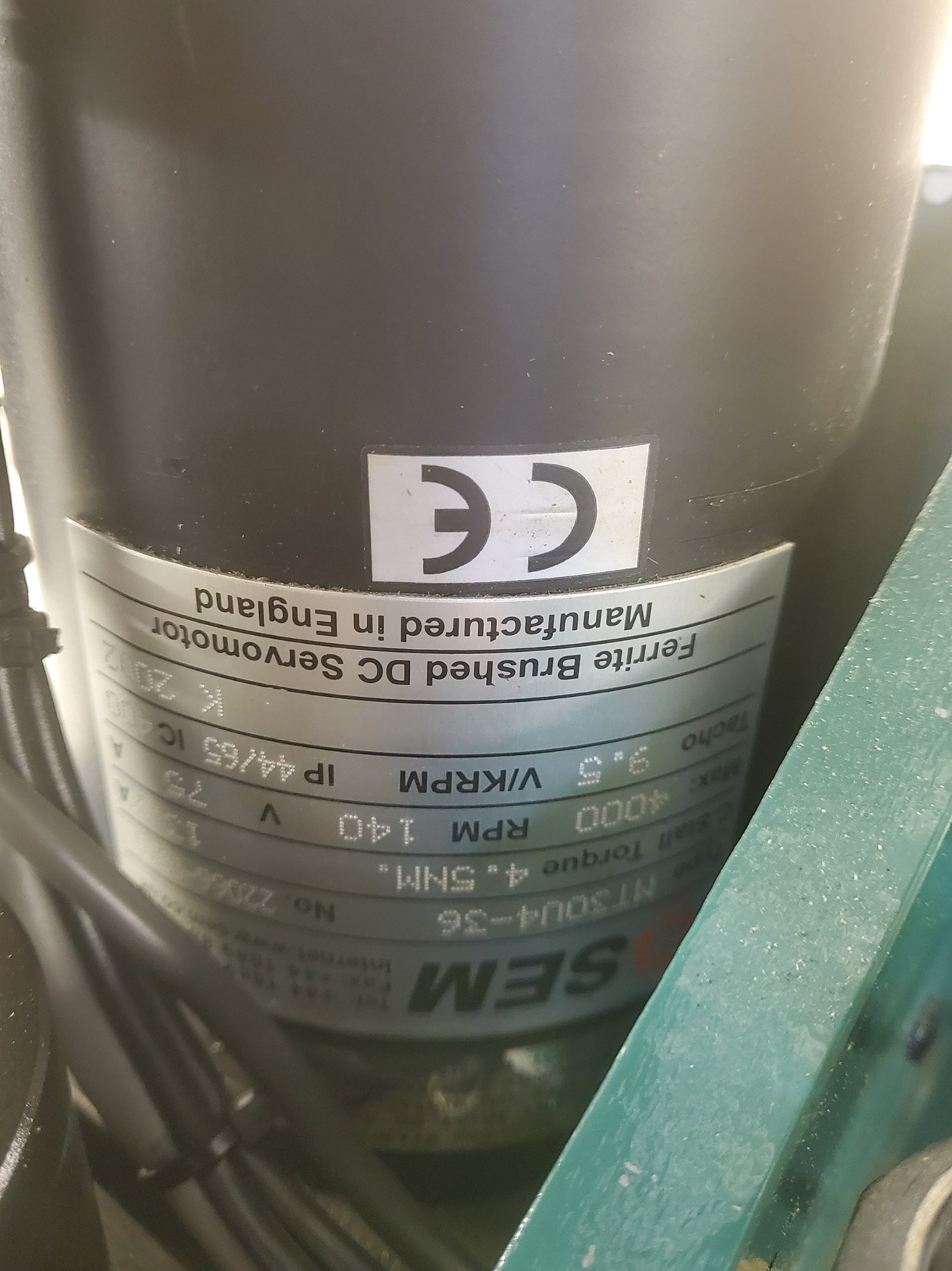

Hi, thanks for the reply. Attached photo's as thought it was more precise?
There is a KBSI240D inbetween drive and motor, recommended by centroid (control is acorn)
spin motor.jpg (393.54 KiB) Viewed 24521 times
spin drive.jpg (467.39 KiB) Viewed 24521 times
data badge.jpg (370.09 KiB) Viewed 24521 times
kbsi 240d.jpg (282.01 KiB) Viewed 24521 times
The DC Sprint drive will does not have a reverse input so you will need to add a spindle reverse relay & invert wires 9 & 11. Make sure the spindle is not running when you change direction though.
