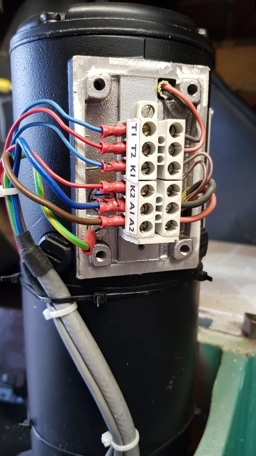

I have taken the cover off the spindle motor
not sure what wires do
they are marked from top t1 then t2 then k1 then k2 then a1 and the bottom one a2
t1= blue (thin) t2 red (thin) K1 Blue (thin) K2 (thin) a1 blue (thick) a2 Brown (thick)
measured a1 and a2 @250rpm 61-62vdc (varies) then @4000rpm 70-73vdc (varies) seems really high.
as I increase the speed to 4000rpm it doesnt seem like it is going at 4000 rpm seems much slower
and varies. If it was a petrol engine I would say "its hunting " so to speak.
not sure if I have got the correct wires to test but as the a1 and a2 are much thicker thought they may be +and - , just guessing as I dont have a diagram .
any help would be greatly recieved.
Alex

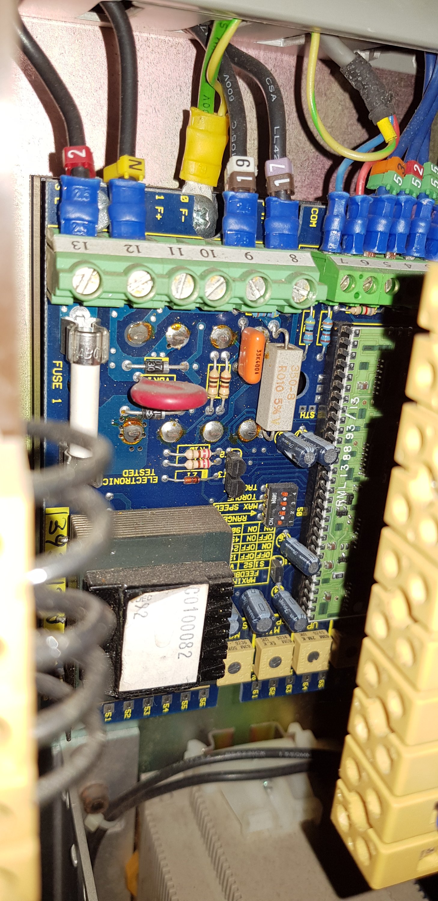

You could try adjusting the Stability pot on the Sprint 1200 spindle drive.
Re: Triac PC spindle motor speed varies by its self

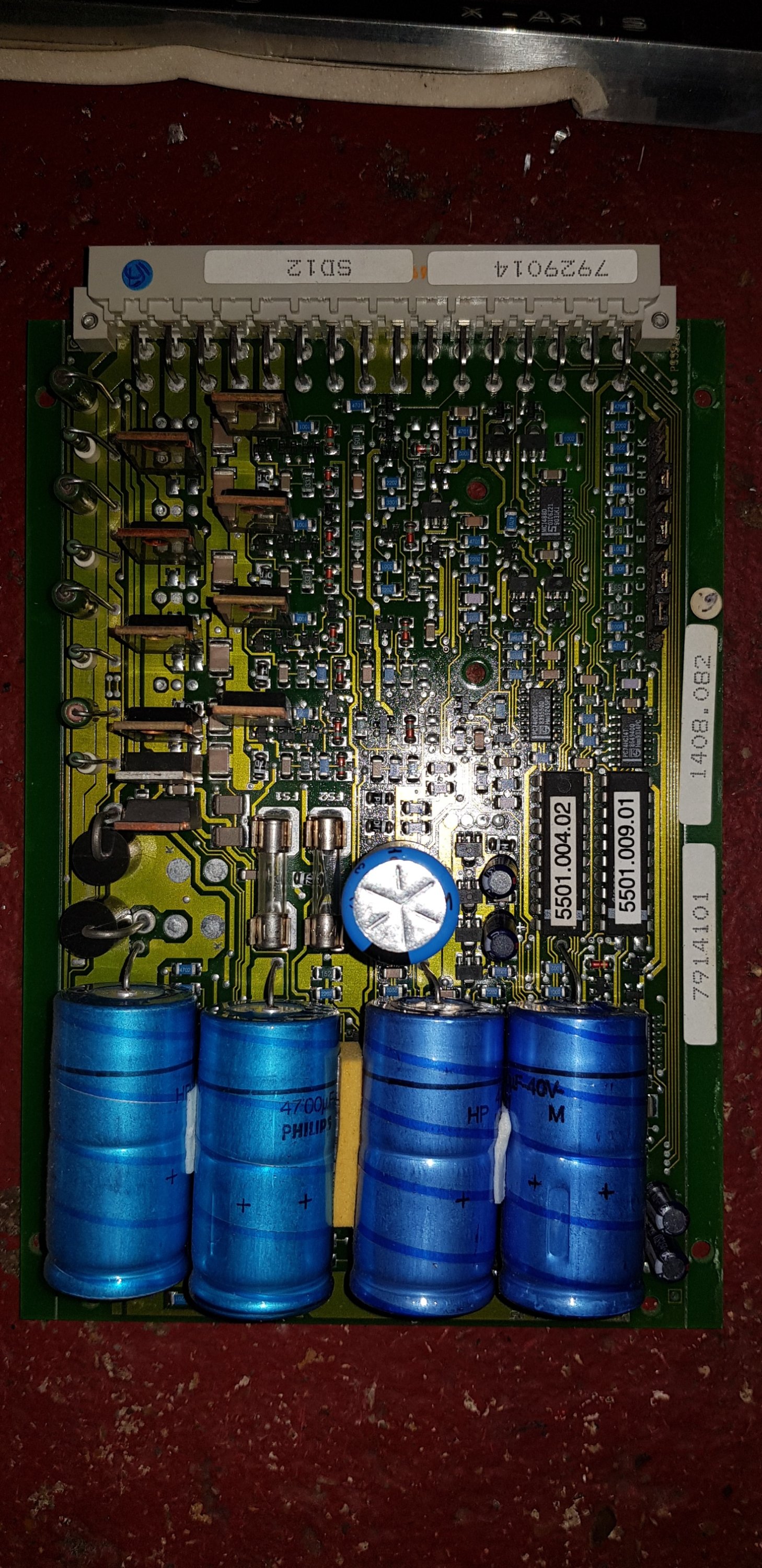

Do you know which pair does what, and what the voltage should be ?
denford driver pic1.jpg (596.02 KiB) Viewed 158754 times
denford driver pic2.jpg (563.93 KiB) Viewed 158754 times
denford drive motor.jpg (186.23 KiB) Viewed 158754 times

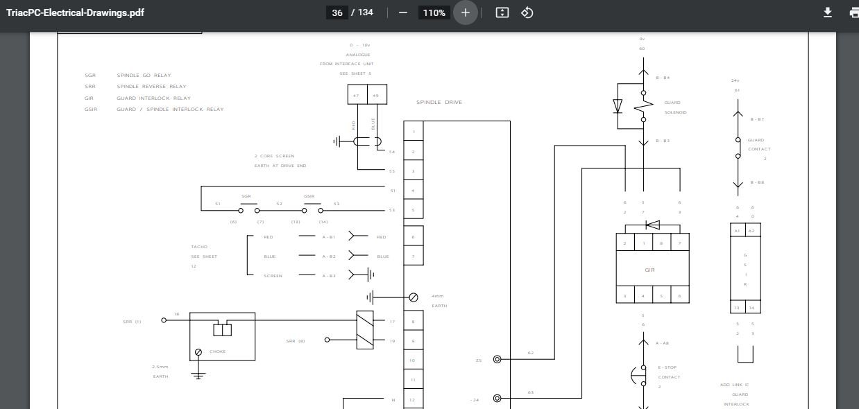

Not sure if this will help but I uploaded the drawings for a sprint controller, may not be the same though viewtopic.php?f=46&t=4778

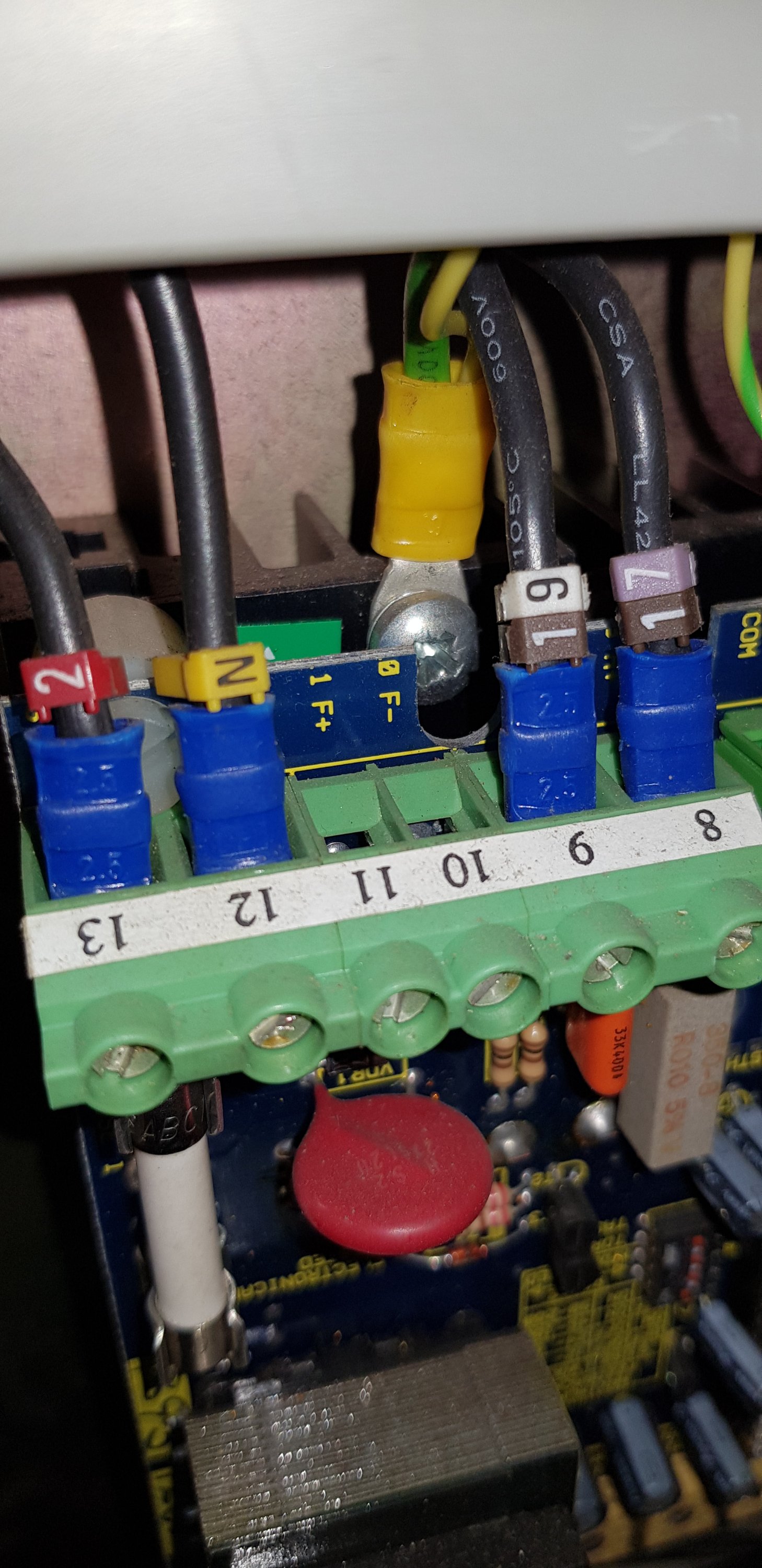

Please send a larger picture of the spindle drive.
Download electrical diagrams
file:///C:/Users/soddy/Downloads/TriacPC-Electrical-Drawings.pdf
View page 36
Wires 54 and 55 are the analogue
spin drive.JPG (46.2 KiB) Viewed 158749 times
Wires 17 and 19 look like the motor DC
Steve wrote: ↑Fri 21 May , 2021 13:34 pm Please send a larger picture of the spindle drive.
View page 36
amaxlegend wrote: ↑Fri 21 May , 2021 18:24 pm The voltage on those Pins 54 (-) and 55 (+) at 250 (slowest speed ) is 4.6 -4.78 DC , fluctuates
the voltage on the pins at 4000 (highest speed ) is 6.7 - 7.32 DC , fluctuates
It doesnt get near to 10vdc on full speed
wonder why that is ?
regards Alex

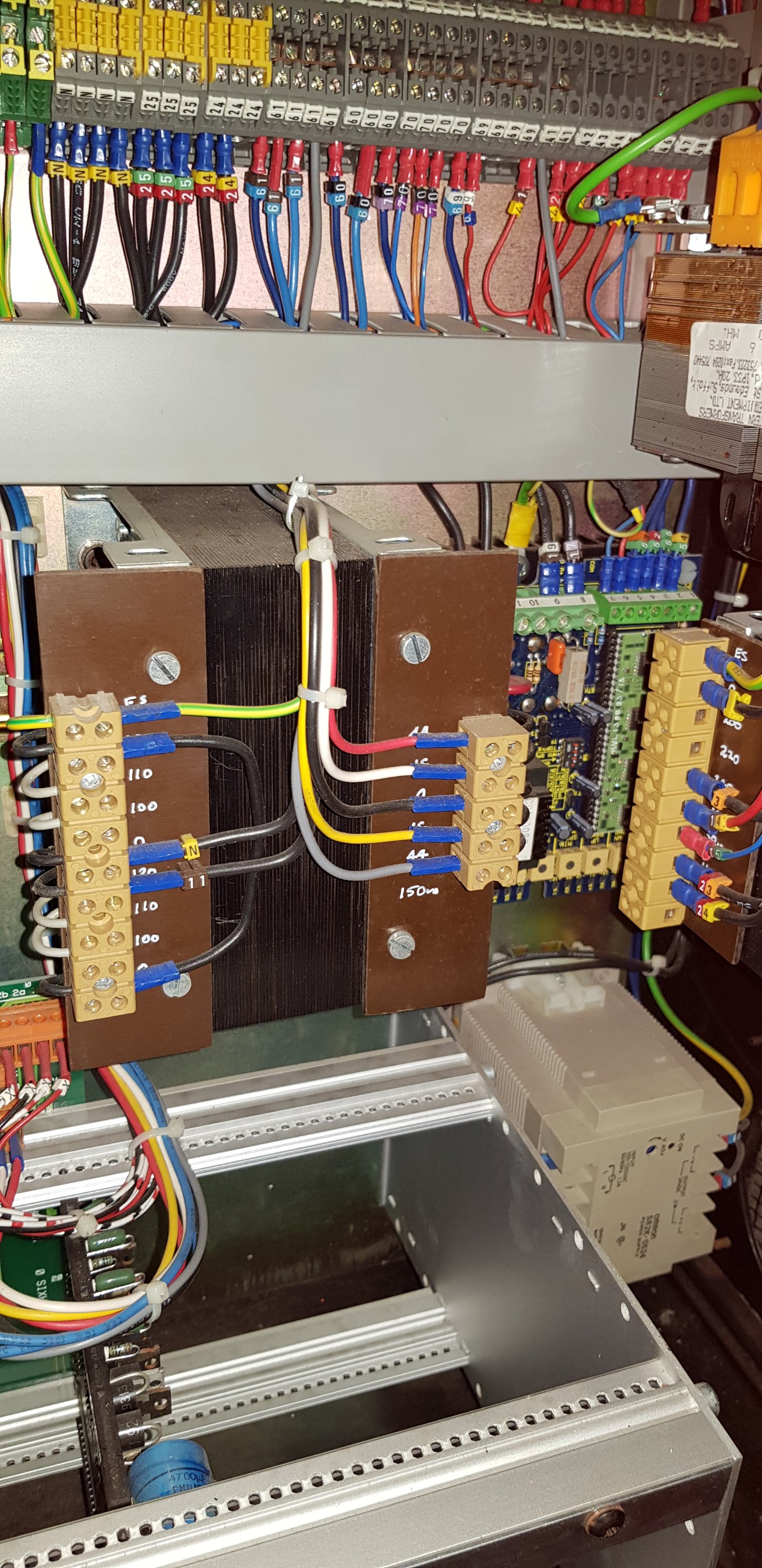

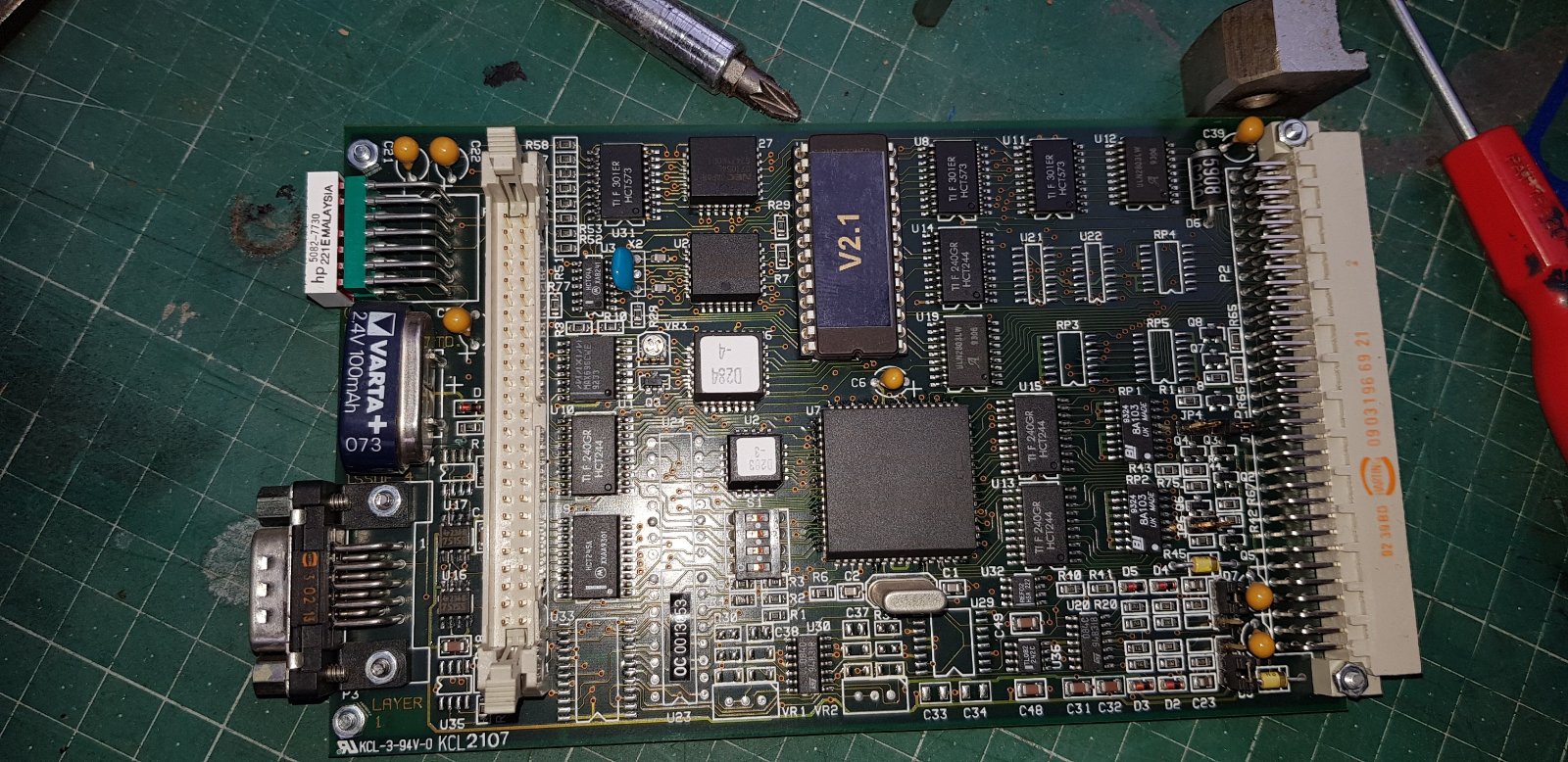

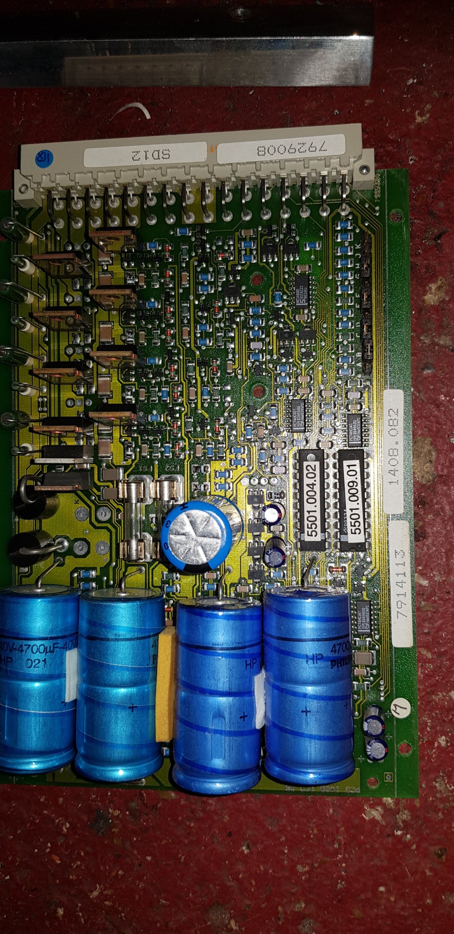

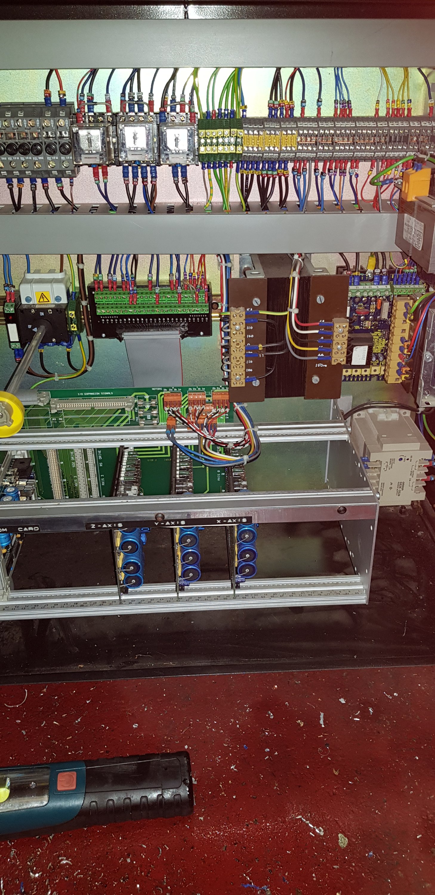

Can you supply photos of the inside of the electrical cabinet It sounds like the spindle analog card has failed.
Steve wrote: ↑Fri 21 May , 2021 19:10 pm Can you supply photos of the inside of the electrical cabinet It sounds like the spindle analog card has failed.
inside case and board pics for triac
spin drive.JPG (46.17 KiB) Viewed 158741 times
b1 denford.jpg (381.58 KiB) Viewed 158741 times
b2 denford.jpg (973.98 KiB) Viewed 158741 times
b3 denford.jpg (889.01 KiB) Viewed 158741 times
b4 denford.jpg (860.64 KiB) Viewed 158741 times
b5 denford case.jpg (955.53 KiB) Viewed 158741 times
b6 denford case.jpg (809.95 KiB) Viewed 158741 times
b7 denford case.jpg (863.08 KiB) Viewed 158741 times
b8 denford case.jpg (863.08 KiB) Viewed 158741 times
case denford.jpg (977.36 KiB) Viewed 158741 times
triac spindle.jpg (948.41 KiB) Viewed 158741 times
Hi Steve whats the solution . is there a replacement available or can you replace a component ie what needs fixing or replacing
Do you have the wiring diagram for this machine that you can send me.
regards Alex
