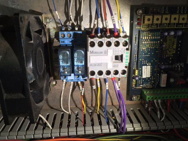

I have a problem with my Micromill 2000 estop. The pin (a25 on the 96 way connector) remains permanently low. When I turn on the machine with the key, the front red light comes on, there is the sound of a relay clunking, and I get power to the Baldor board. But I am having troubleshooting because I cannot identify which relay is which, and my machine doesn't seem to closely resemble any pictures I have seen
Here is a picture of the back. There are two small relays and then the bigger white thing looks like a relay

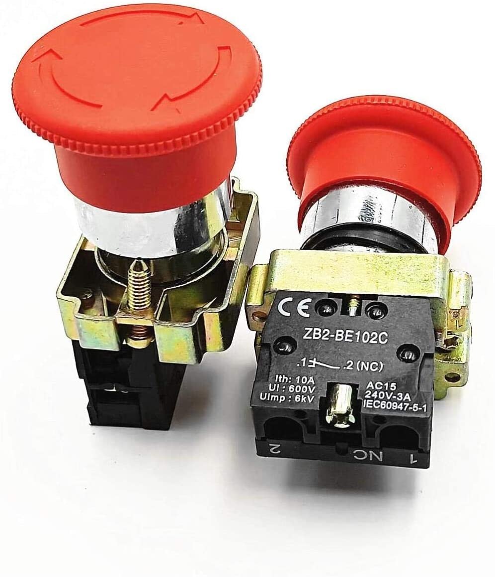

I have not heard of a larger relay below the machine, but I can say if I were trying to identify the issue, I would start by fixing your estop button. the 2 switches that are not physically connected, are the estop button's. they should be attached to the estop button like so:
not the same switches or estop button, but you can see how the switch is mounted to the bottom of the button.
Estop buttons are normally closed, so if the wire is damaged, the stop will activate (failsafe) seeing as your switches are flopping around, its possible that one is damaged and breaking that loop.

It would be helpful to know which relay is which. In the photo, I assume the big white relay is the main relay. But there are also two small blue 24V relays to the left of that relay. I assume one of them is the spindle guard relay? But which, and what is the other one?

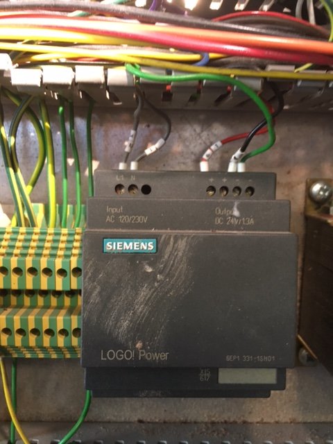

My overall aim is to replace the Denford control circuitry (which is fried) with new generic drivers, while retaining the power circuitry and safety features. This means that I want to find both the right ESTOP input and also the 24DC supply that I can use for the new drivers.
In the PDF, there is a 24 AC input on TB11, and I have that. It comes from the transformer via the big white relay. I'm not sure what this is AC supply is for or why it goes to the control board. But in any case I need the 24 DC input. On the PDF this is shown as being available on TB10 but on my machine there is no DC input there. There is a PSU on the chassis with a 24 DC output, here
but the wires coming from it are rather thin and don't seem to lead to any of the board connectors, which makes me wonder whether this unit is actually being used to drive three steppers. Basically I am confused because I cannot find a document that shows the wiring for the machine I have actually got.

The Emergency Stop Relay is the relay directly to the left of the Sprint 400 spindle drive.
