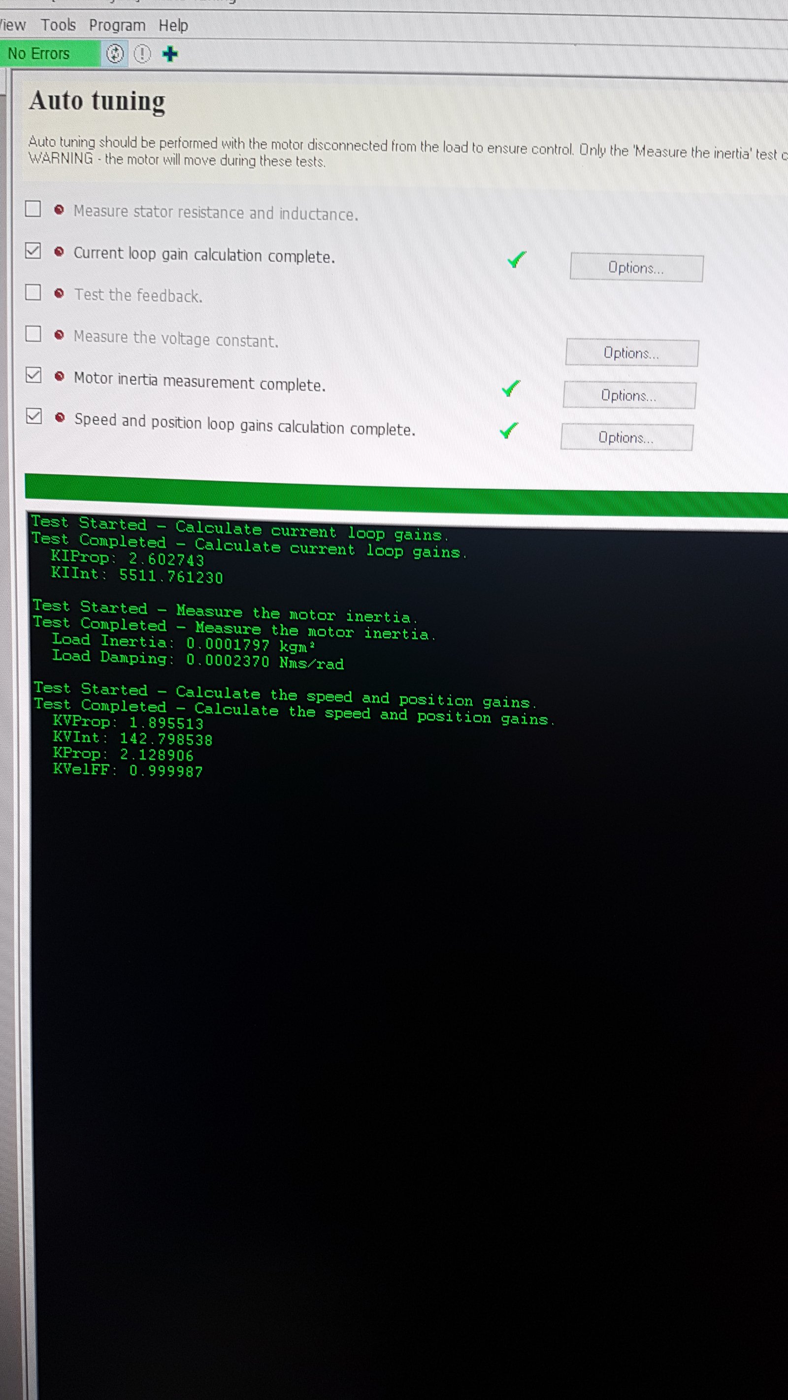

I'm in the process of configuring the servo drive and servo motor in the Mint Work Bench environment. There is a problem with the auto-tuning configuration;
(I will give some details)
-Windows 10 operating system
-Work Bench / Build number: 5860
-Servo drive. FMH 2A06TR-EN23
-Servo motor. BSM 80N-375 AF

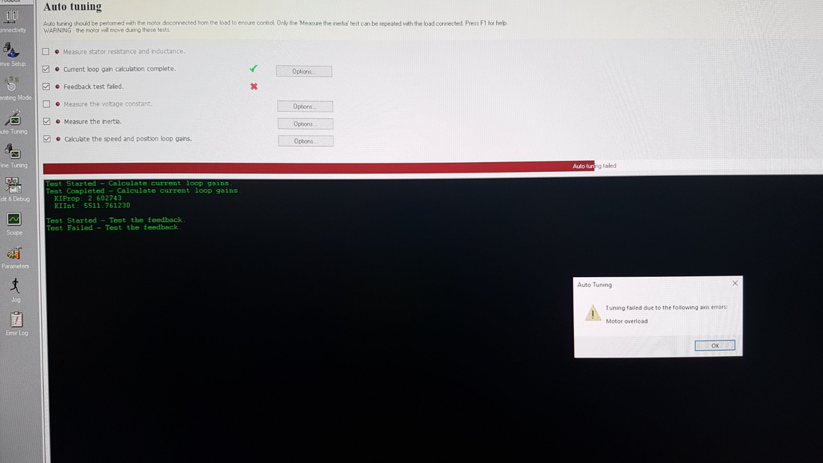

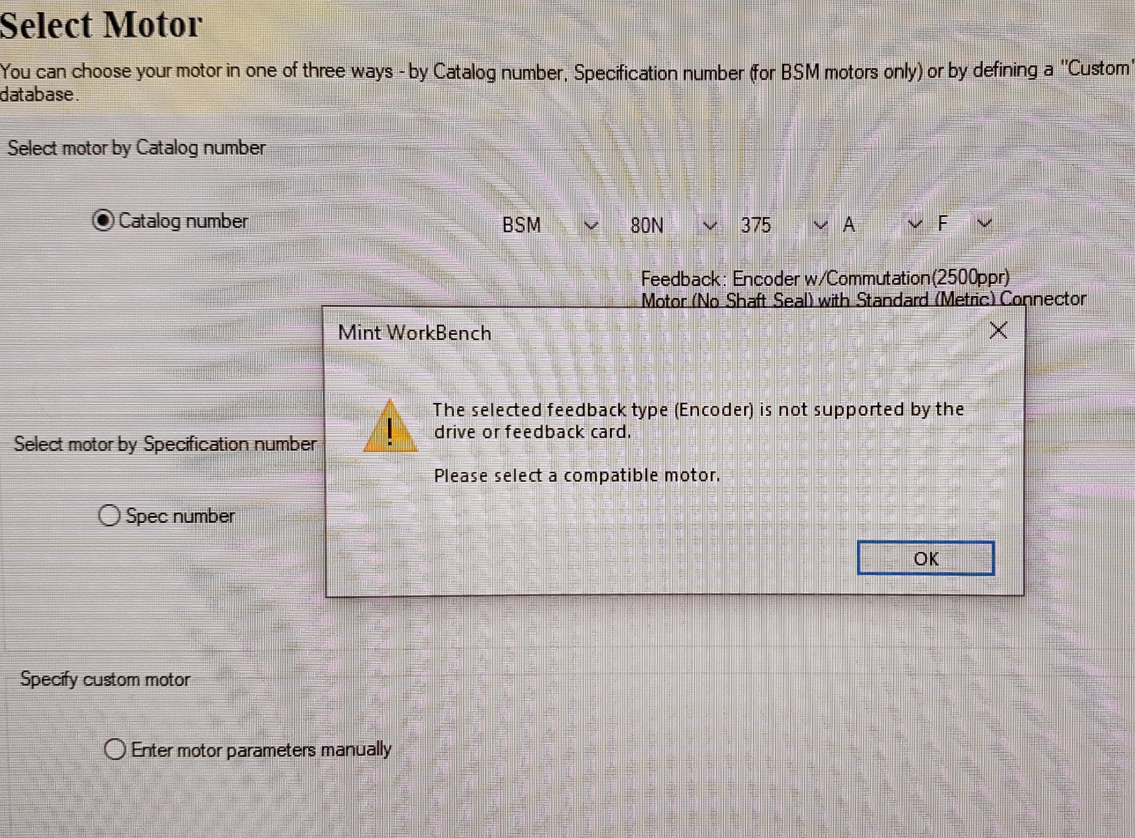

Mint workbench informs that the motor encoder is not supported by the controller. I also fail
Feedbact test. In jog, the motor runs irregularly at lower revs, an overload fault occurs.
Overload error is very common. Status Led 8 or 5
I would like to ask for help and advice.

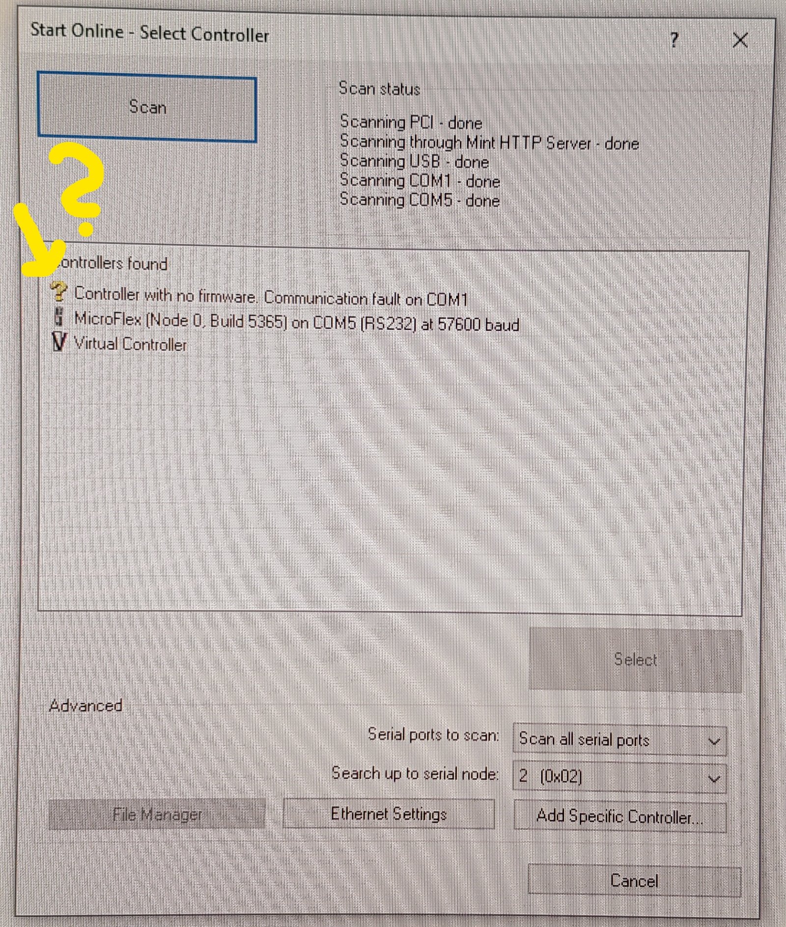

What firmware and how to properly upload it to the controller. I will provide more specific details when making contact.
is it the fault of the wrong software
should I ignore this message
