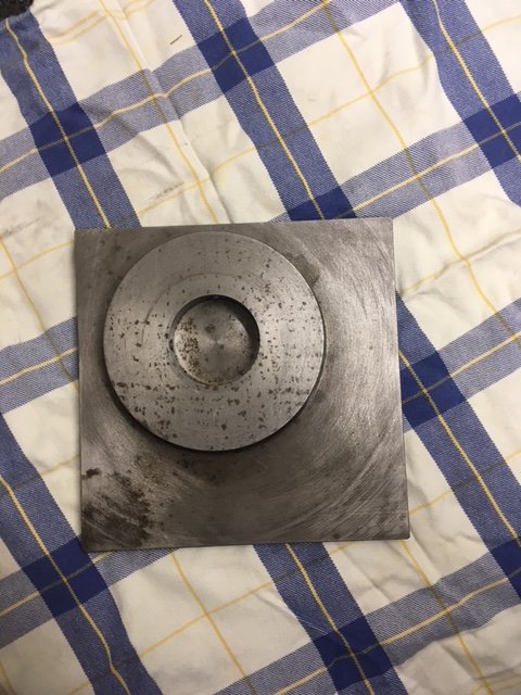

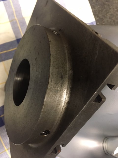

I have a boring table that came with the lathe which I believe is a Denford item, used it for the first time and whilst drilling from the headstock it rotated a bit and ruined the job !
The table replaces the top slide and fits over the upstanding dovetail spigot on the saddle, two hex grub screws push angled slugs onto the dovetail spigot - same as the original topslide except there are only two set at 90deg, not 3no as per topslide (90+135+135deg set out). I had tightened them as much as normal as I didn't want to damage the spigot surface etc but it rotated under moderate pressure - have to feed using leadscrew handwheel.
I can't find a drawing of the table to see if it should have a third fixing - anybody have a similar item / drawing ?
The catalogue pic shows a similar table but it has extended screws beyond the edge of the table.

Yes indeed, the further away from the pivot centre the greater the forces trying to rotate the table. If you had your drill hole centred on the pivot it would not turn at all.

Agreed, I was only a bit off centre due to angle plate fixing holes etc but enough ! - as its really not secure enough currently to use at all.
Looked at drilling the third hole today and understand maybe why it was left off - it would fall pretty much on the long diagonal so need a really long drill bit - approx 6 1/2" which I'm pretty sure will be longer than long series - so will need to make a drill extender of some sort and something similar for the tap.

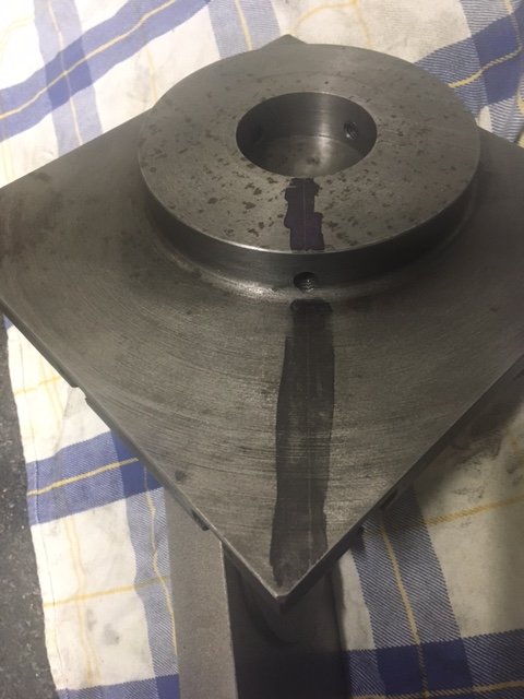

Well to close this one, I've added a third fixing to match the topslide i.e 90/135/135 deg set out.
As I thought drilling it was rather difficult as it was on the long diagonal - I don't have access to large machines etc but found the top slide was the correct drilling height for the dowel hole !
So clamped it to the slide, made an extended centre drill and found a long series 7.9mm drill (165mm long) that was just long enough !
Very restricted access for tapping the long 3/8" Whit thread.
