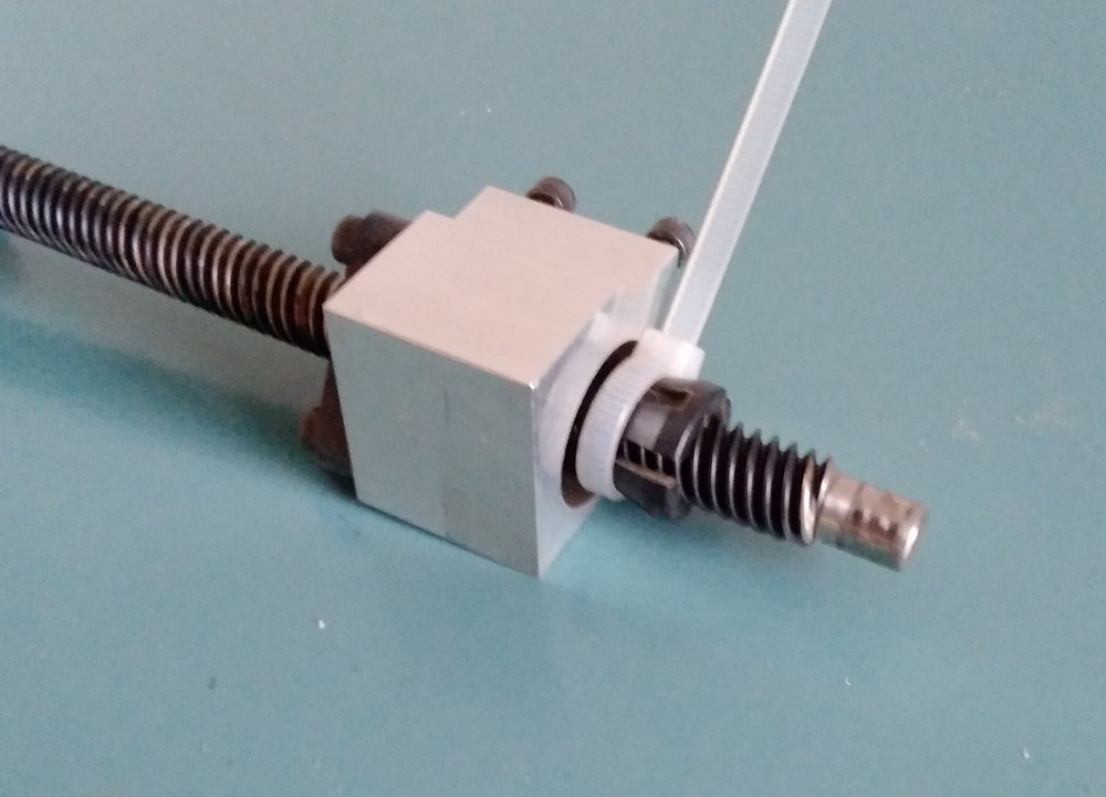

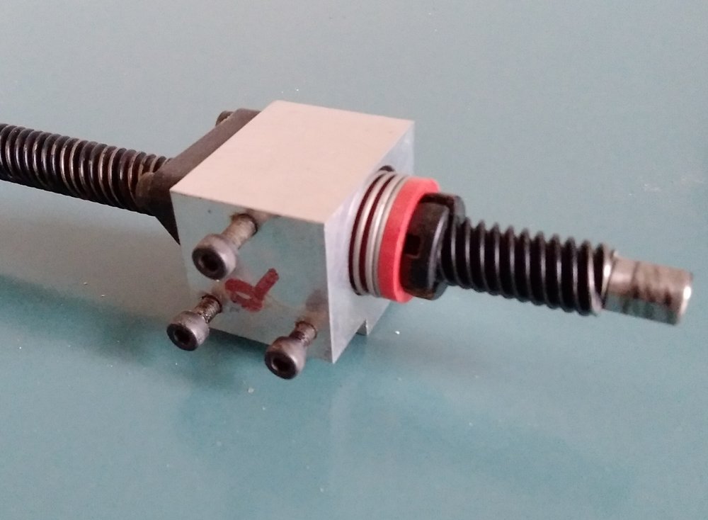

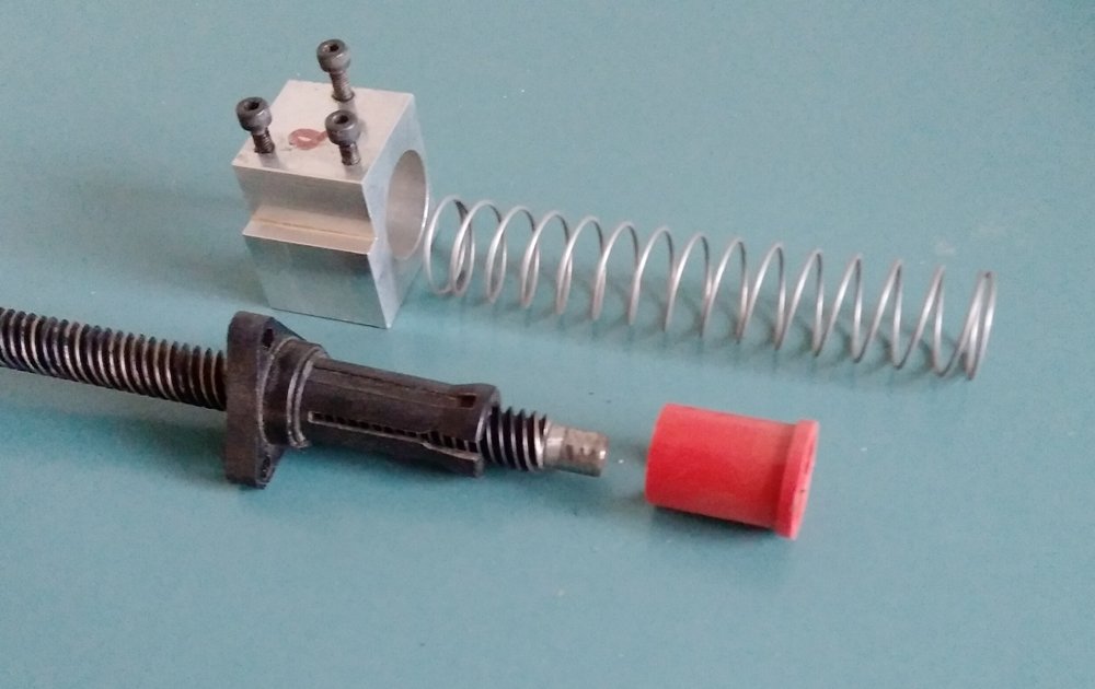

Thanks for your response Martin. You gave me confidence to strip the unit right down to the nut. I checked for play in the leadscrew en route but it was absolutely secure. It's difficult to imagine that nyloc nut coming loose. Here are a couple of pics of the nut:-
On dismantling the lead nut it became apparent that the black plastic threaded collet could not take any further adjustment to compensate for wear. The reason it had reached its limit was because the red outer sleeve had come to the end of its possible travel. However the collet is still capable of further tightening and this is how I intend to achieve it:-
Neat eh? And at no cost :lol:
There is still the minutest bit of backlash apparent and so I will swap it with the Z-axis nut which is in pristine condition. The worn one will have an easy retirement in the ZZZzzz.... zone where it will enjoy assistance from Mother Earth in the form of gravity.

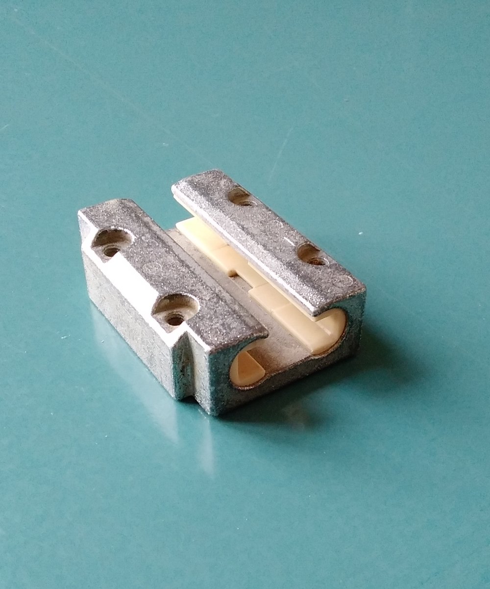

Regarding my other source of play, all 8 sliders on the X and Z rails are worn. Here is one of them:-
20210129_134857 (1).jpg (151.72 KiB) Viewed 33417 times
They no longer appear in the Reliance catalogue so I assume replacement plastic inserts are not available so that just presents me with a challenge. I will make my own. To that end I have a metre of 8mm nylon rod on order. I'll take a few pics as I do the job and present them here in due course.

Have you looked for carriage equivalents elsewhere. I just saw this range at Igus and it looks similar https://www.igus.co.uk/product/930 . The Igus material may be more suitable than nylon which can be annoying to machine.
Re: Cutting Accuracy
DavidB wrote: ↑Tue 02 Feb , 2021 16:50 pm Brian,
Thanks for that tip David. They are the actual manufacturers of my guides and can supply me with replacements at a reasonable cost. I need 16, there's 22 in the UK so I'm in.

1. Replacement of X and Z guide plastic inserts with self-made nylon ones. Replacement inserts from the manufacturer proved to be not so reasonable and would have amounted to nearly 10% of the value of the machine.
