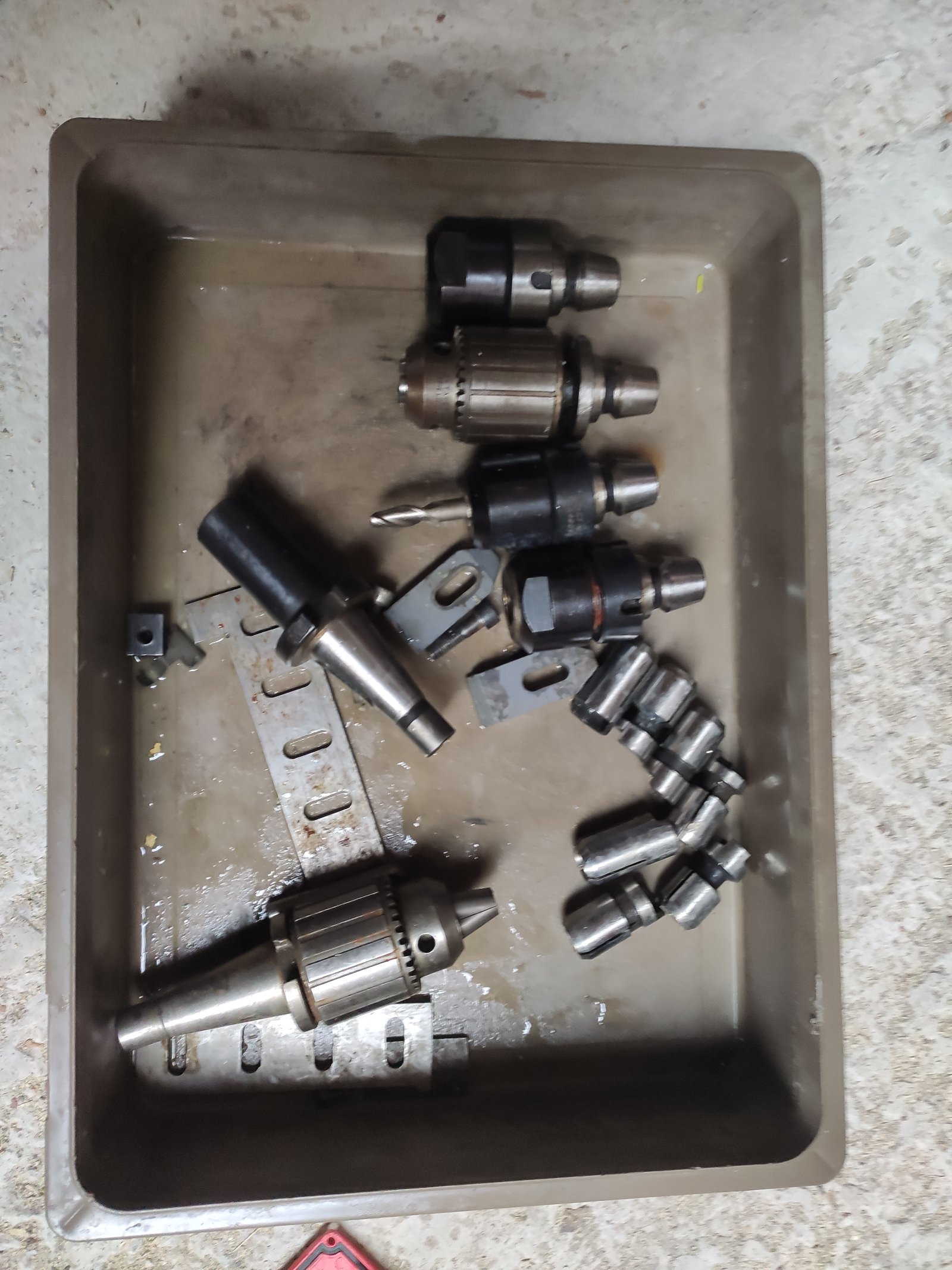

Also the tools in the pic are they the easychange tools??

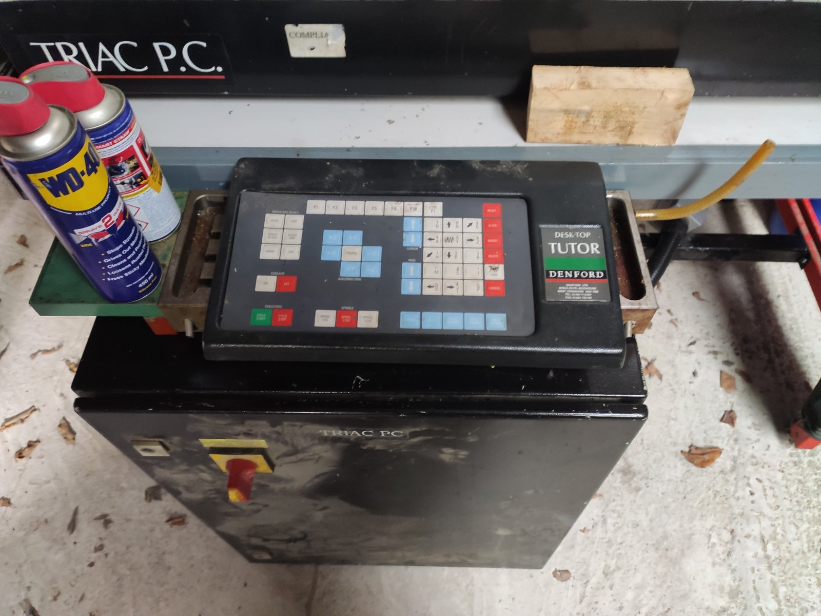

Denford tutor console came with it also I think they are a basic serial so would be easy enough to get working down the line.

The tools you have are the Coventry Easychange tooling which is the same as I have.

The tutor keyboard is serial, I've connected it to the PC in the past and had characters come up on a terminal screen when keys were pressed.
