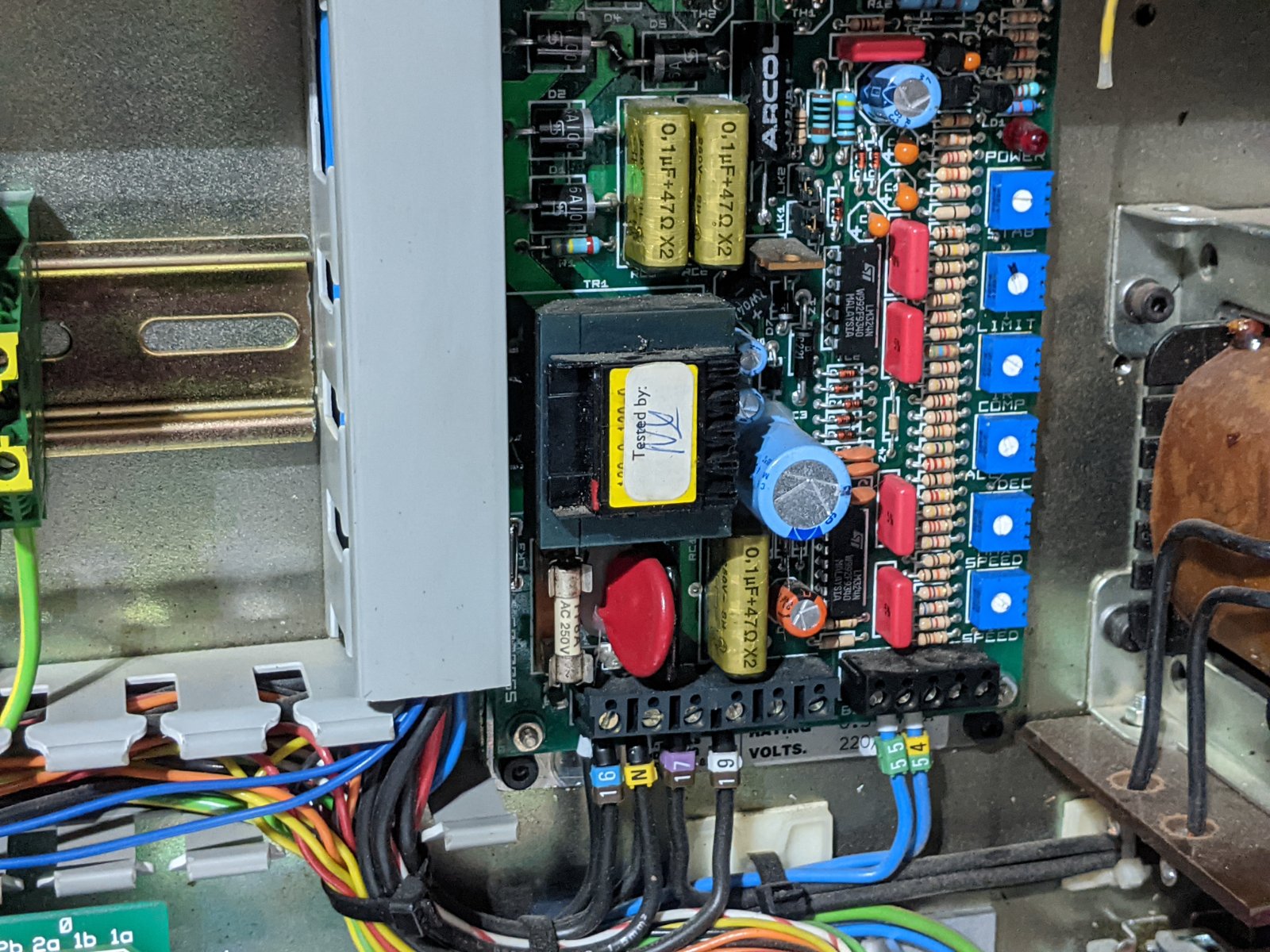

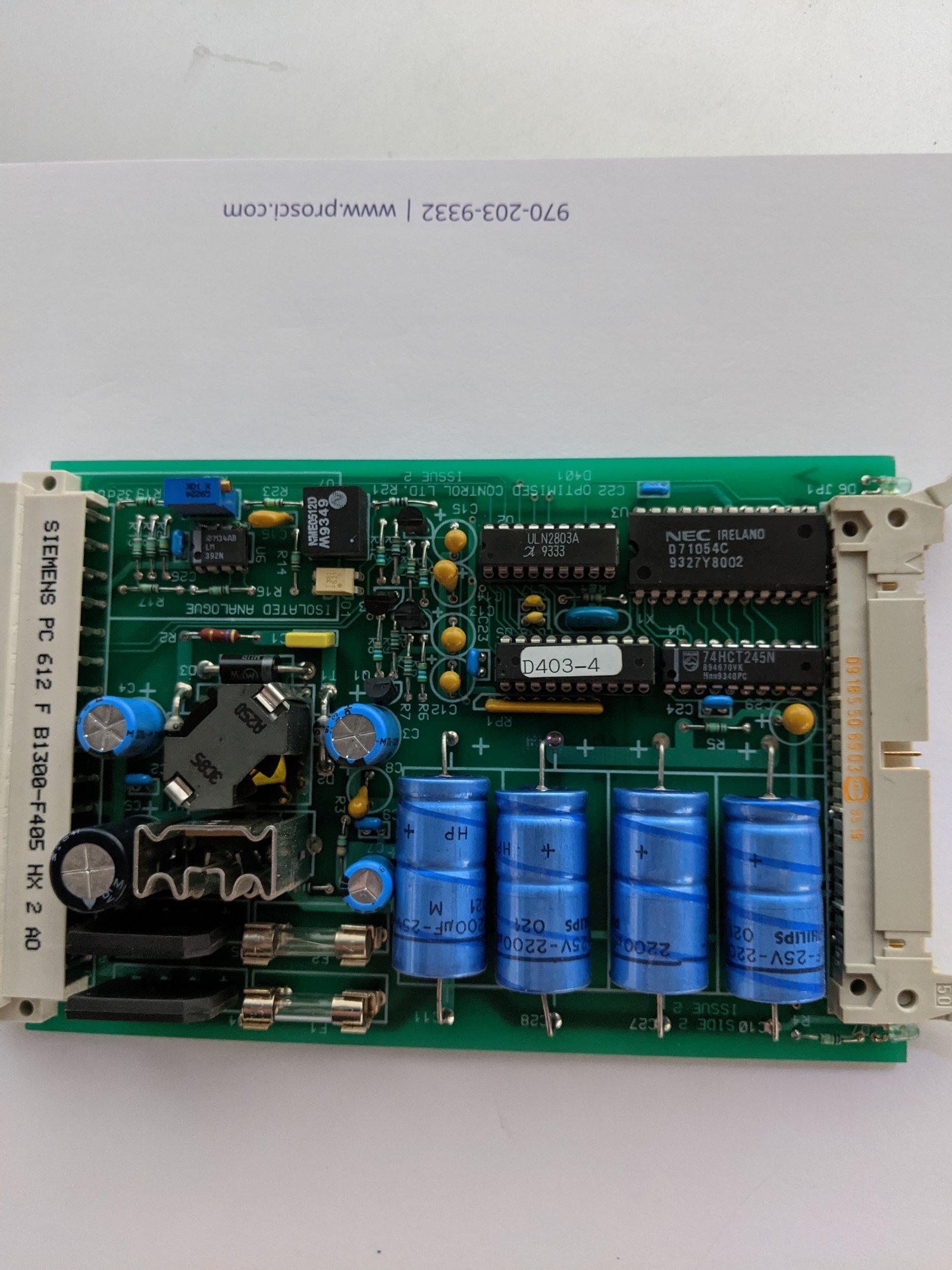

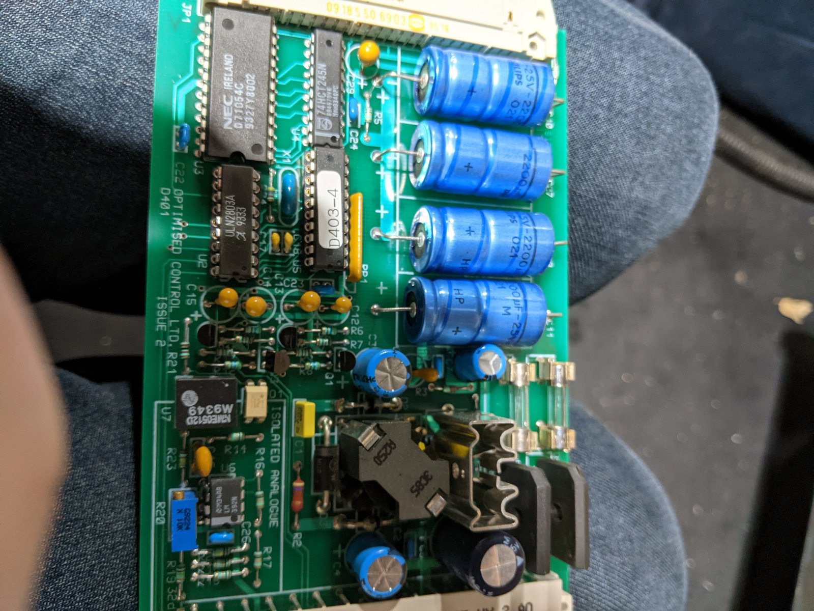

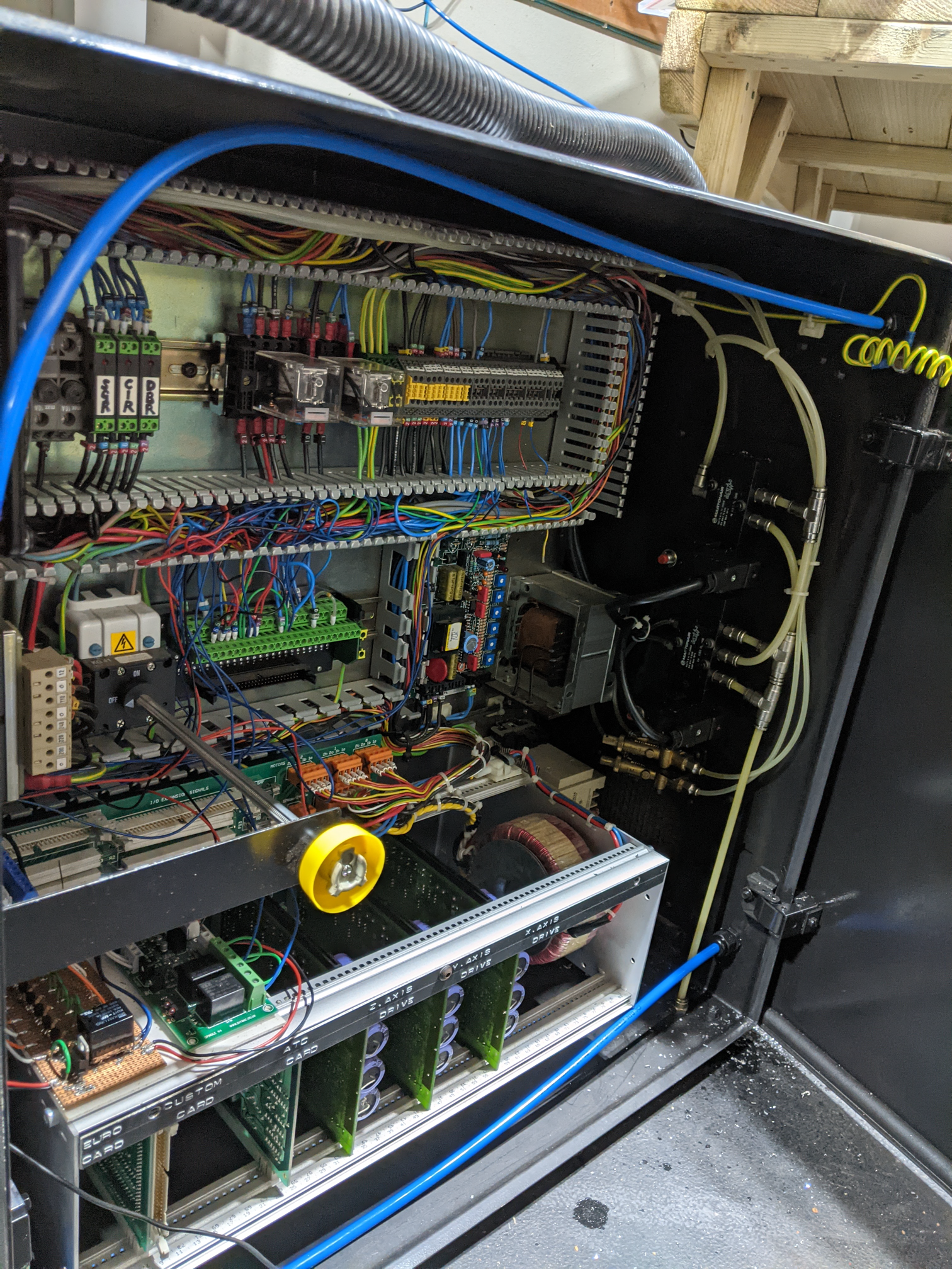

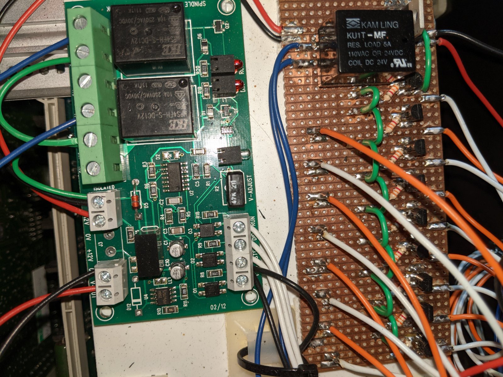

I have just purchased a starmill pc. I wondered if someone could point me in the right direction the machine has been converted to run on mach3 and the chap I purchased it from has added a 4 axis . two questions what is the custom card for in the pics. I am also looking to add a fog buster to the machine and I do see that this had the capability, as per the original drawings on the forum shows its an option , fuse 5 would have have been available. so I take it I dont have the capablity on this machine

Re: Custom card and Fog buster question
Can you post some better pictures of the custom card and its companion. From the little shown the custom card looks to be Vero board with transistors interfacing to the 25 way D but it's not very clear, the companion card looks off the shelf with some relays and may have a frequency to 0-10V isolated supply to connect to the Sprint? motor control board speed input, a good photo may help identify it. You need to figure out if you have any unused outputs that could be used to turn the fog on/off, or maybe it could be tied to the spindle motor running, I think the lube system on my Triac runs that way.
HI David

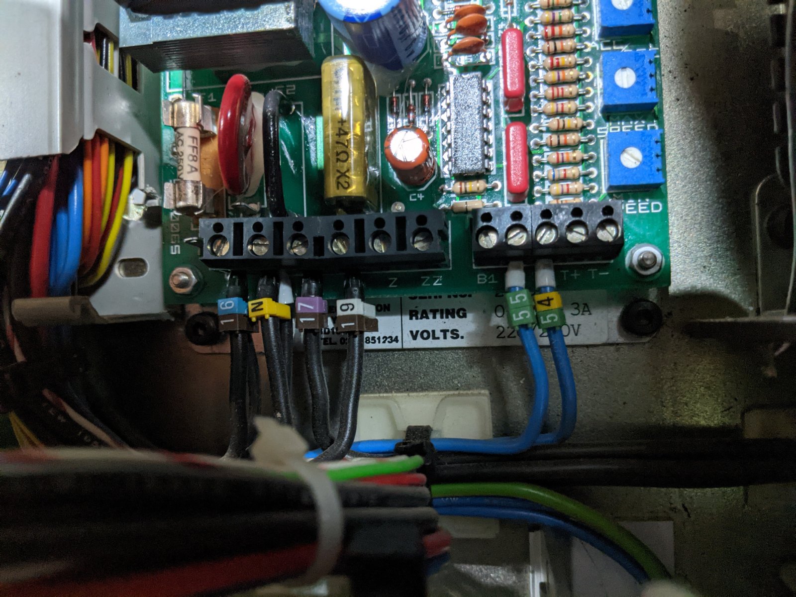

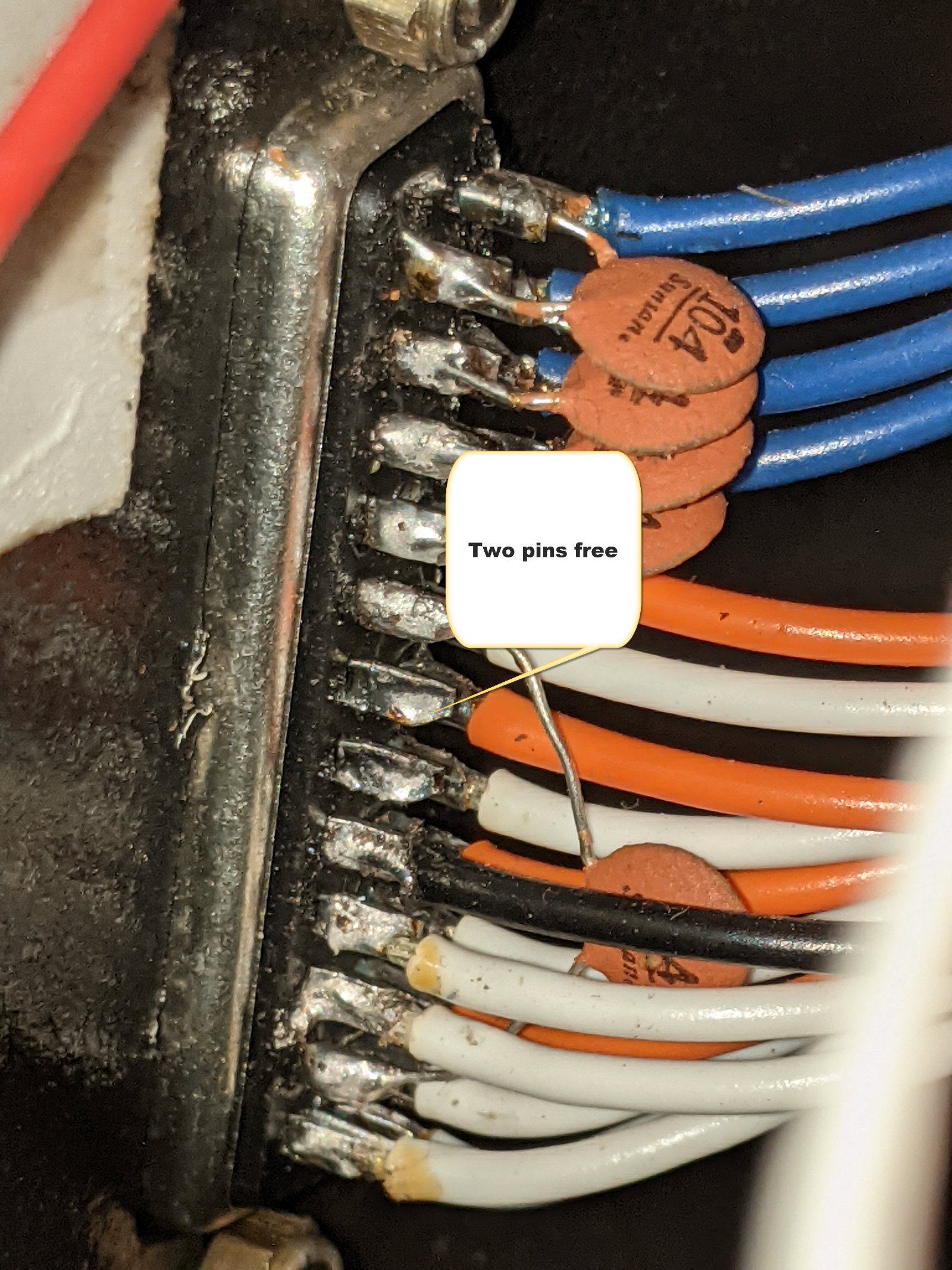

Added more pictures. from the parallel port pins I can see 2 free pins available took a close up of the pins and annotated, Also based on what you said could i just then connect to SGR terminal also annotated on a picture
Thanks :)
Manny,
From https://en.wikipedia.org/wiki/Parallel_port#Pinouts and your image both those unused pins appear to be grounds. You should be able to check the pin assignments in Mach3 and see how they match the pin usage on your 25 way D to find out if there are any output pins left available, I think they're on the side with white/orange pairs being the step/dir signals. If SGR is the spindle control relay then whichever switches it on should be good if you use it the same way, many are supplied a permanent 12V/24V and the other terminal pulled to ground to activate it with an open collector drive, you would need to check which way it's used.

From looking at starmill-pc-electrical-diagrams.pdf 61 is +24V and 79 is connected to OUT0 of the original control card likely connected to one of the ULN2803 drivers on the original board so if the wiring is the same you could do that, just check the new switching device is good for the extra current of the relay you choose.

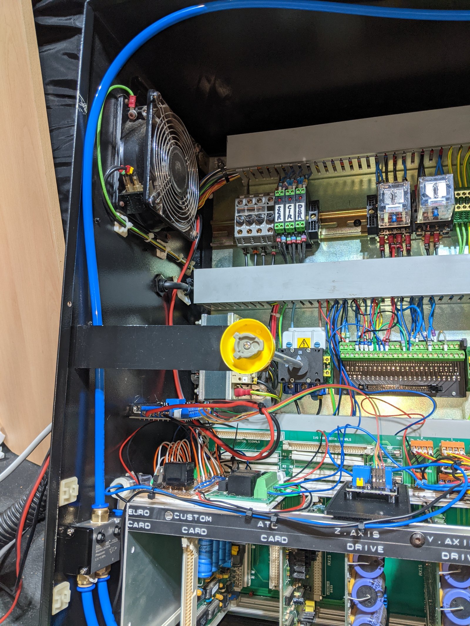

HI Dave are you talking about the this picture that shows the circuit board with the two relays that show the HPS4FH-S
The chap that converted added the 4 axis which this drives. I presume the relay I had the arrow on is ok to connect to .. Excuse the silly questions a lot to learn :) Thanks for being so patient :)

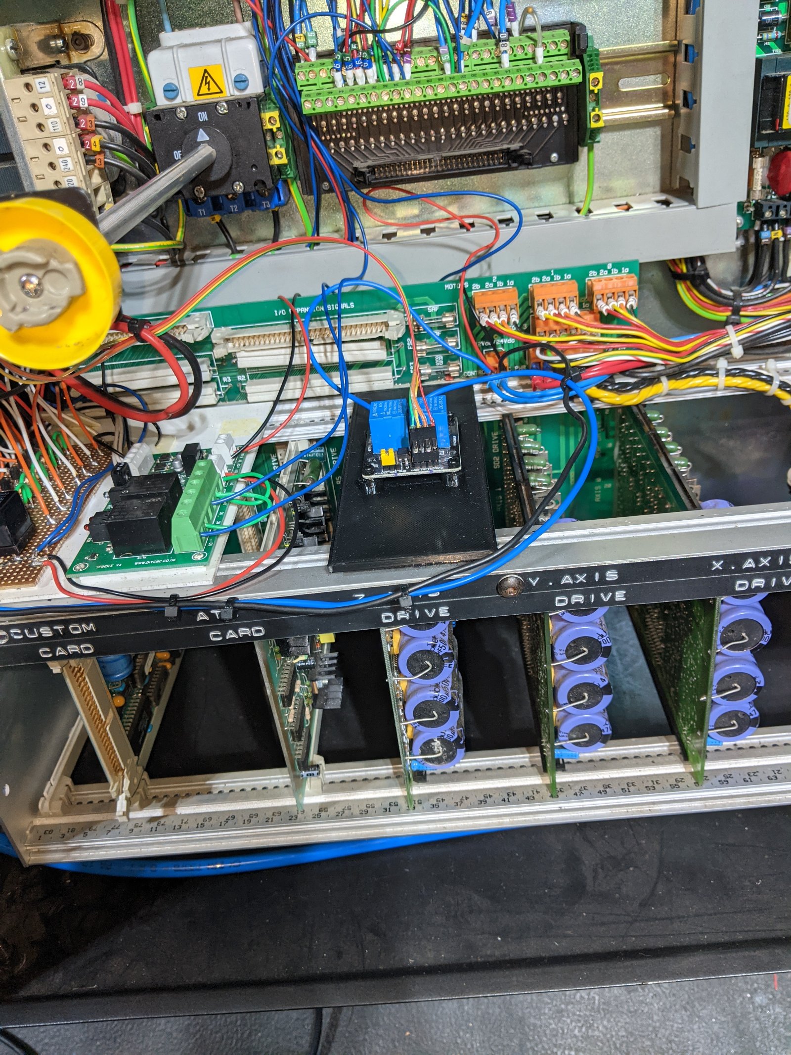

So decided rather than mess with the existing wiring I bought a break out board and an additional PCI parallel port card , excuse the wiring mess it just testing before I hook up to the main unit. So I now have the touch probe working, in mach 3 AND also able to control the mist via the coolant option in mach 3 (M8 and M7)
SO now I just need to hook it up to the 5v out put on the main board and a 24v supply on in the control panel
SO from what you said David thats 61 for the 24v dc and 69 for the 5v

I didn't mention 69, connection 79 is connected to ground when the SGR is powered and not when unpowered. 61 is connected to +24V. Good you've got the extra IO so I expect you can run everything. Which BOB is that?
OK I checked the wiring diagram PDF and it does show that 69 is connected to +5V, IIRC that's produced on the custom card.

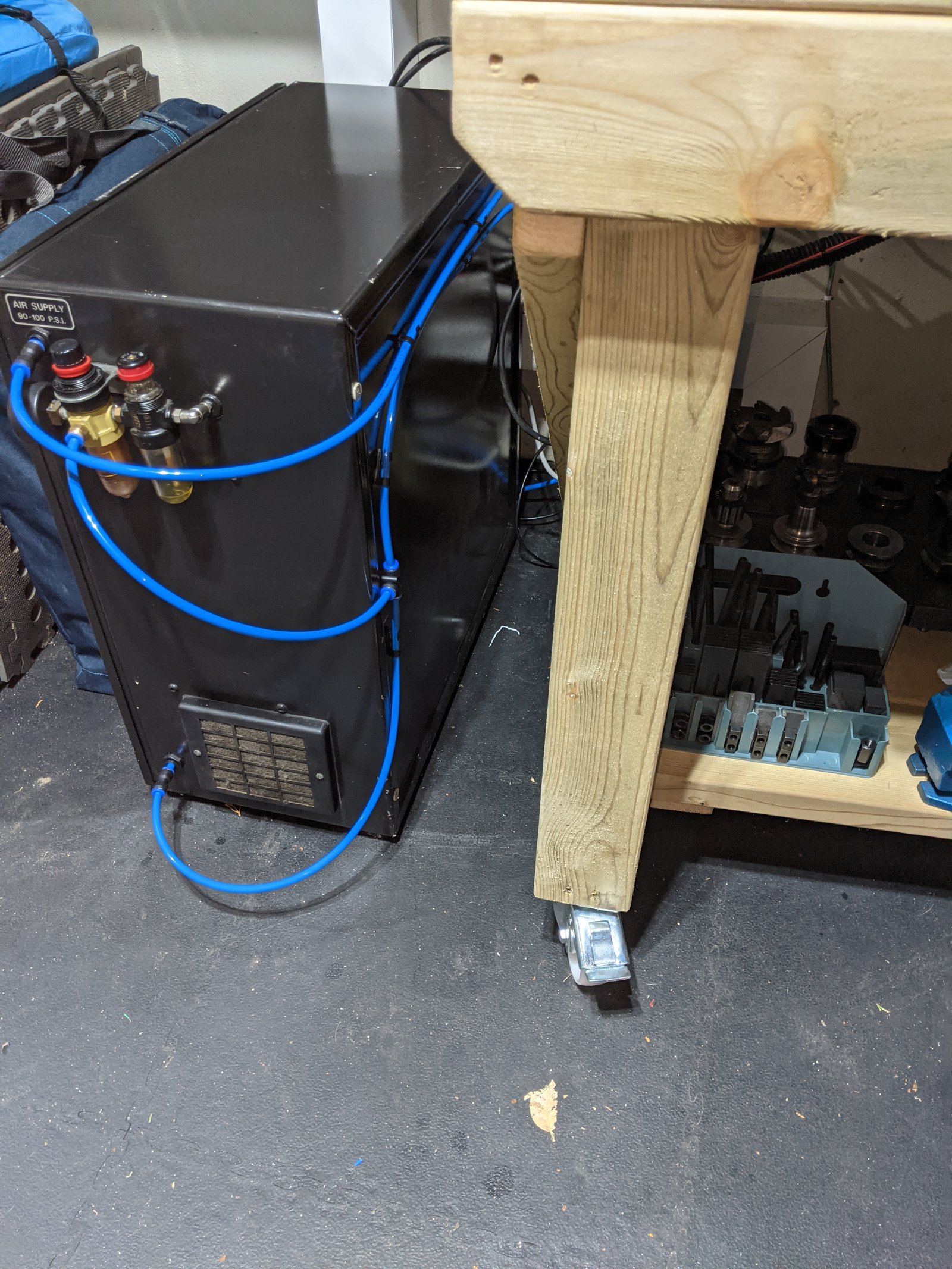

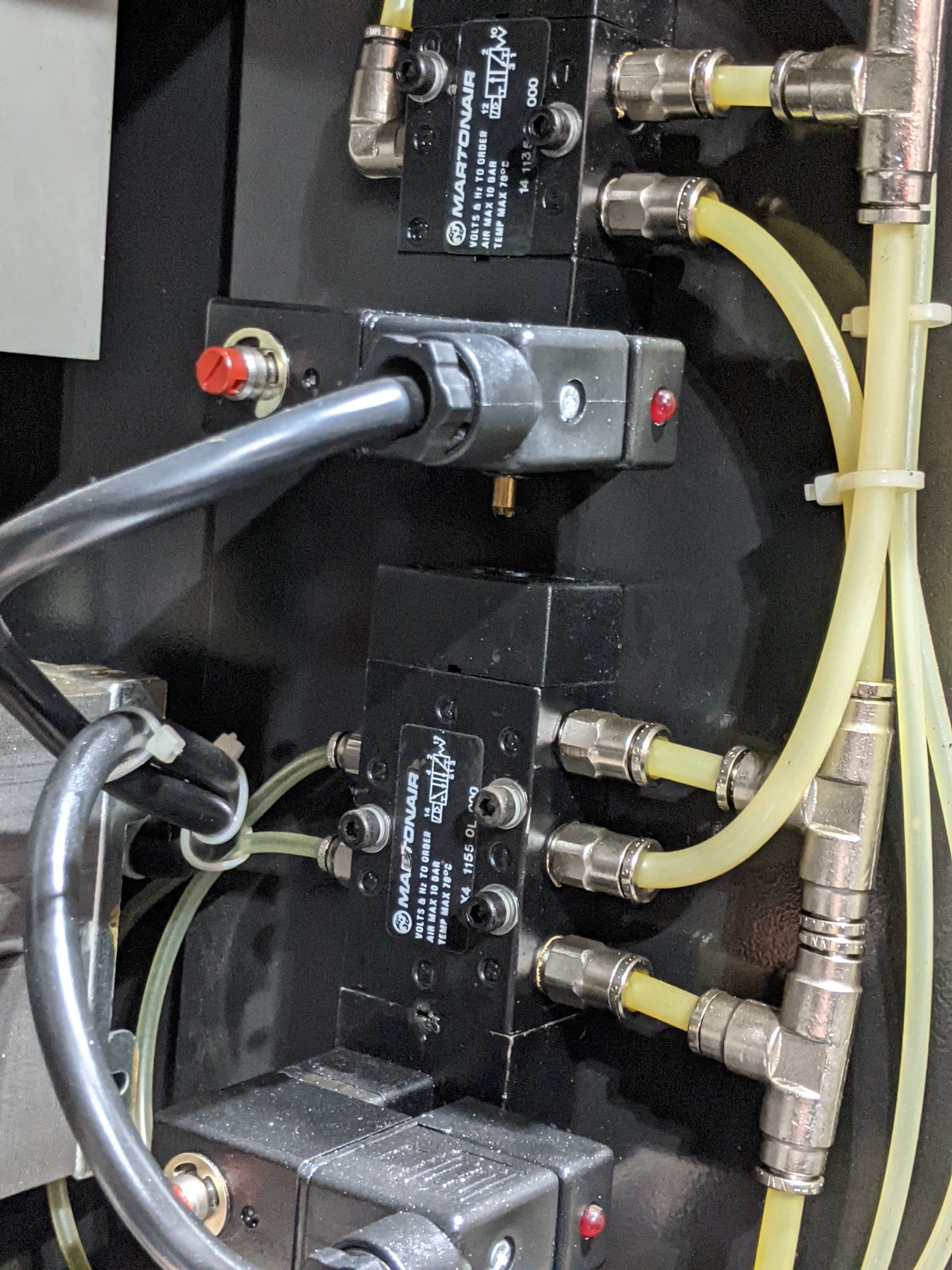

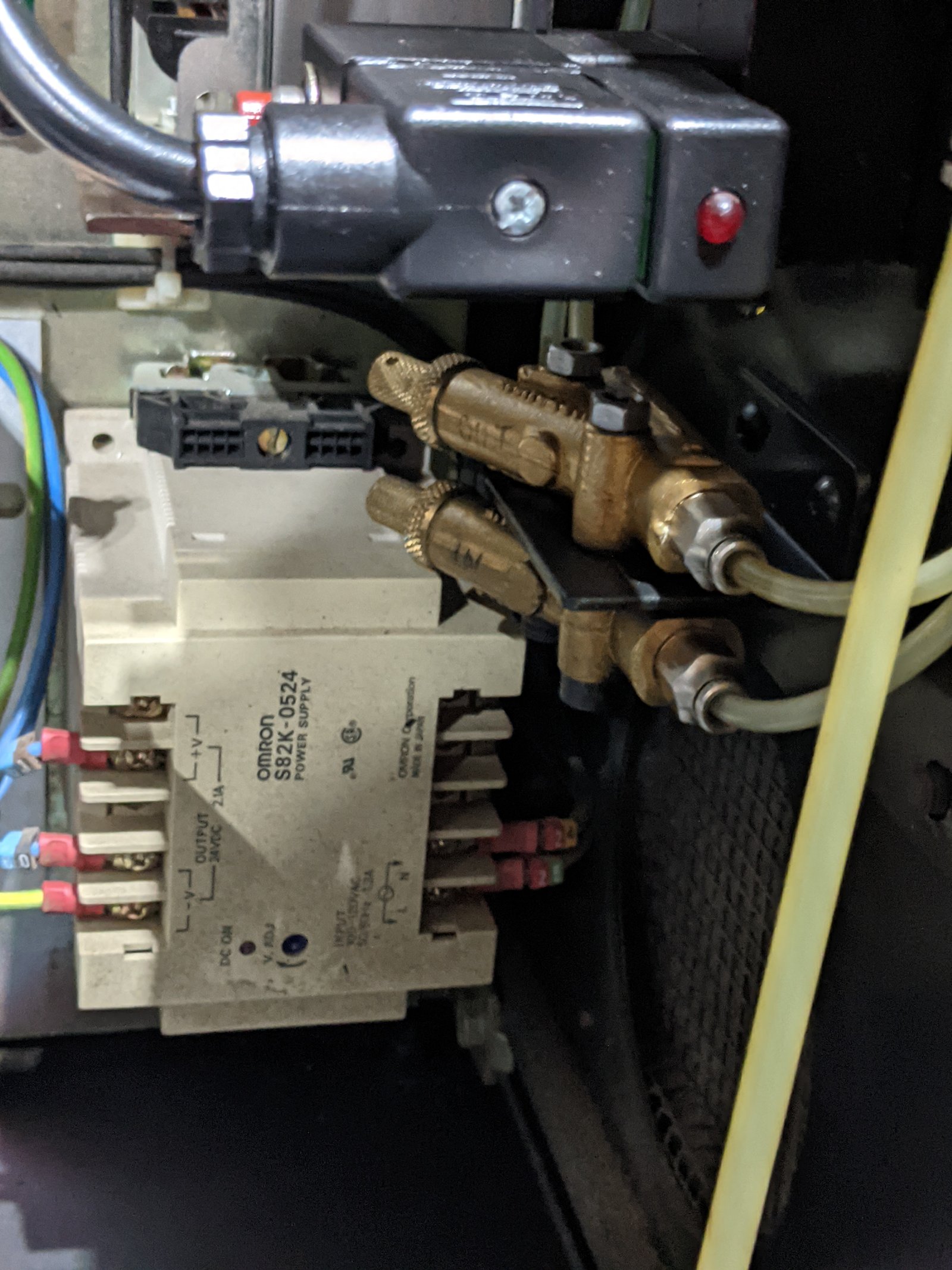

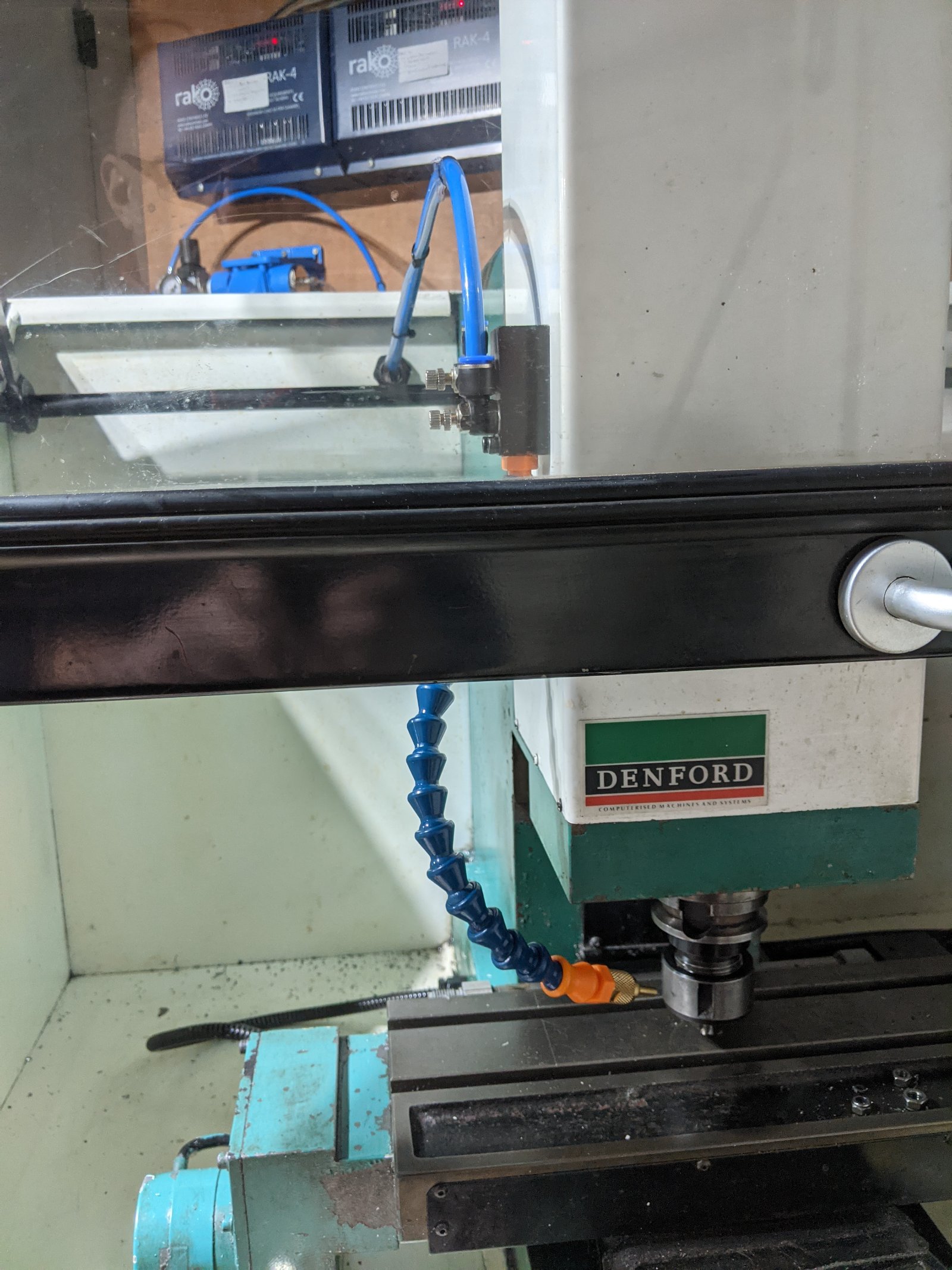

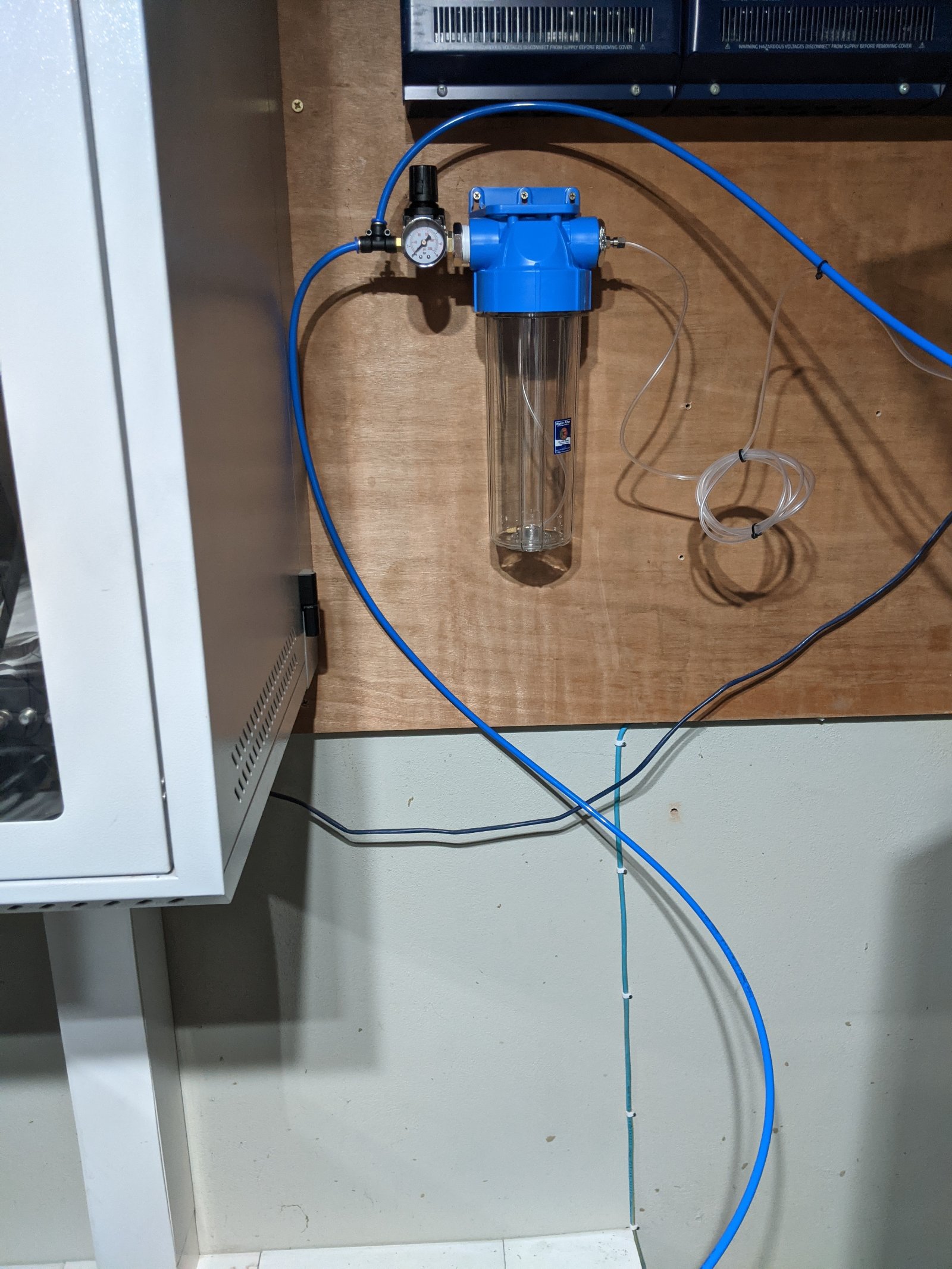

So quick update and some more pics.

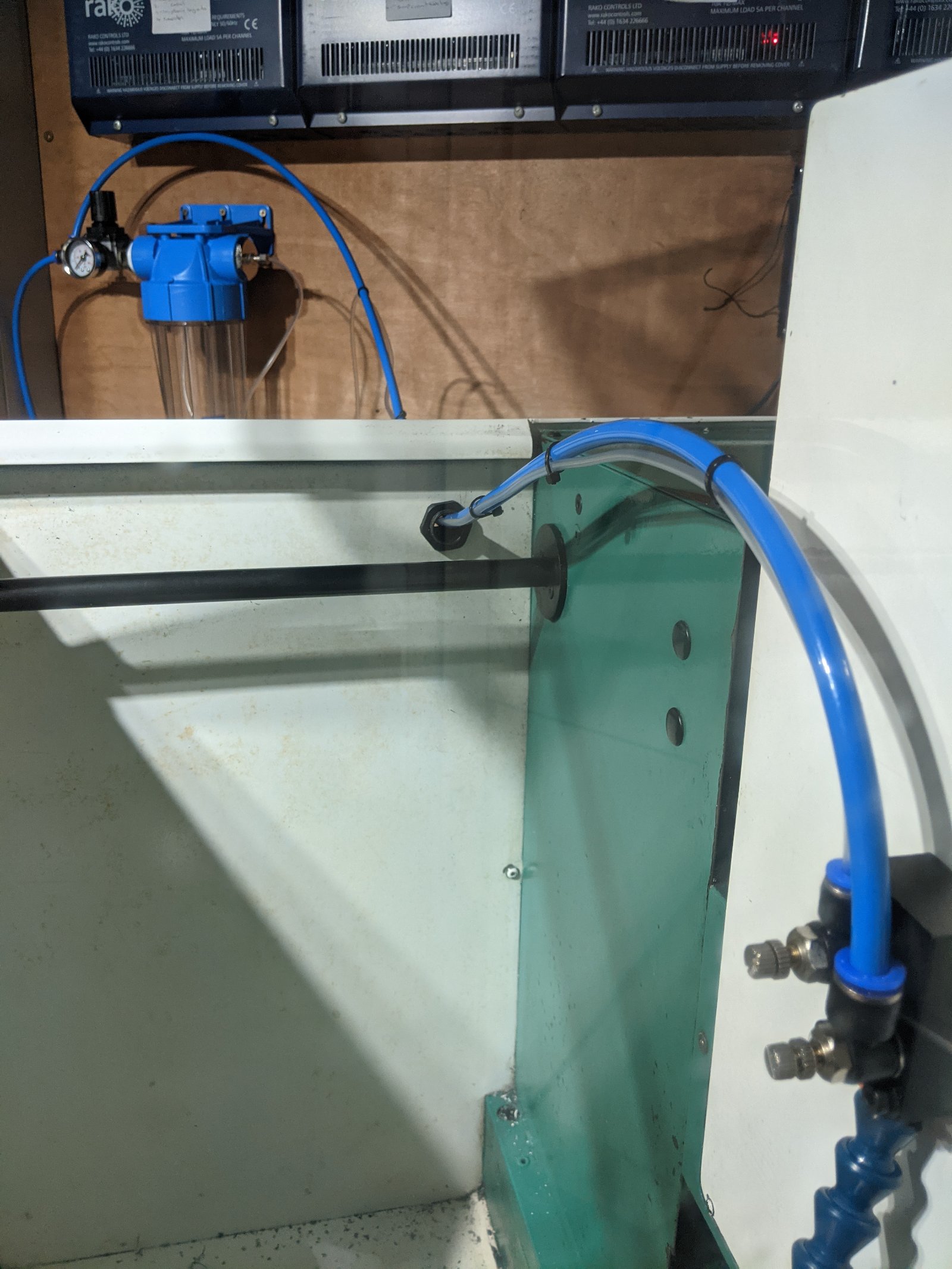

So all up and working , couple of things I should have changed , I should have got a 12,24v relay rather than 5v as the 5v in the cabinet is not wired up if it is I cant trace it as no voltage when tested . Not a big deal as the BOB has a USB input so I can run a usb cable either from the pc or from an extension lead that has a usb port.
Again the pics was whilst I was putting it all together and as you can see not much space to put the solenoid but managed to find a spare space :) and have the in/out for the compressor nicely located :)
When I have the coolant ill run it up and get a vid
The touch probe I have 3d printed a box with terminal connectors so I can swap it out easier, will print off a hold for the touch probe and a corner probe when I make it
