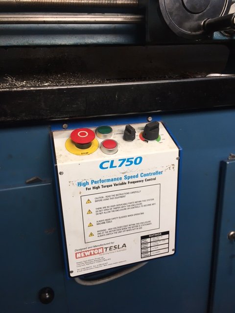

I've attached some pic's and a copy of my motor speed chart I made up.

Hi Richard I`ve just had another look at your pics as I was wondering where to mount the control box for the VFD. I notice yours looks to be over the motor door - do you have to remove it to access the motor - just thinking of if you need to change the belt position ?

Mine is mounted to the side of the motor door so no problem opening the door - just the angle of the pic.
It covers over the opening where the old control panel was mounted.
