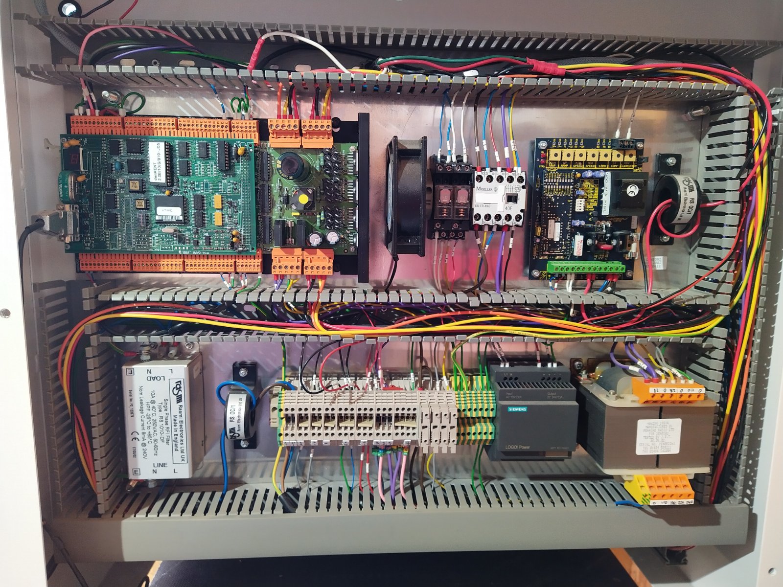

Here's how it looks
Re: Major Timeout Error
It all looks fine.

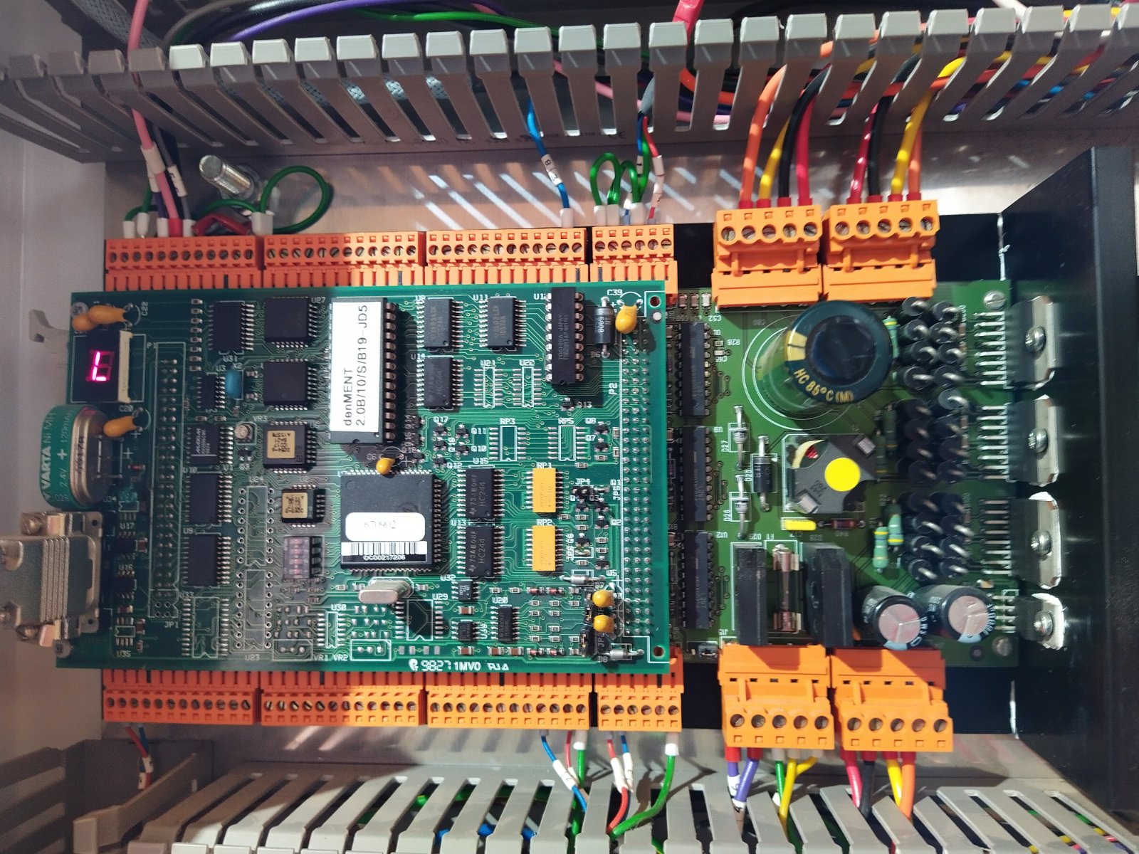

Could this be my issue?
Middle of the photo there appears to be signs of burning?
The leaking battery has caused issues in the past, there are many discussions on this (give it a search, these boards were used in most machines at some point. It is not needed and can be removed. I cant remember what you need to use to clean up a niMH 'spill'. You need to clean off the corrosion and nutralise the 'acid'. You may find this makes things work.
