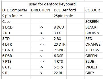

You might have all that correct and find the cable you have isnt correct for the DT. This is the pin out that does work on my DT
Hope that helps
Denford pin out Tutor keyboard .JPG (24.9 KiB) Viewed 5761 times
