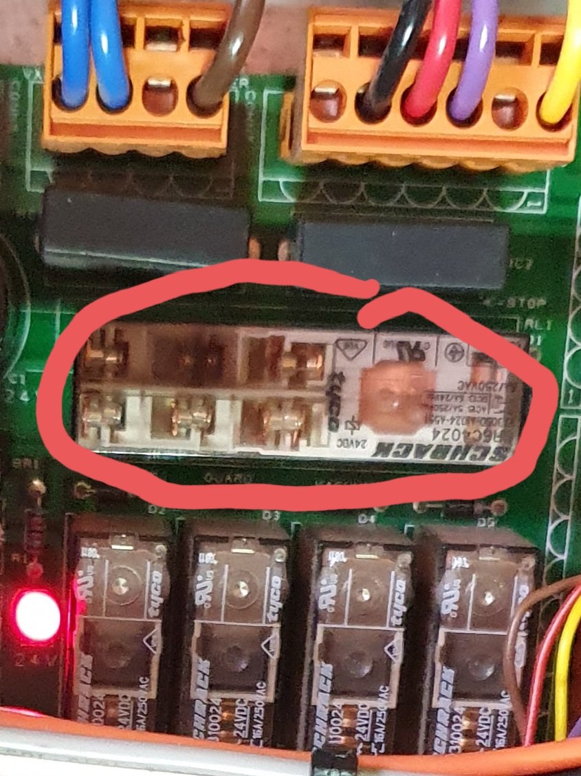

OK I have an issue when I fire up the machine it won't let the autolock release the door. I have checked the 7 visible fuses and all are OK.
I notice a slight darkening on one of the relay switches could this prevent the door opening. Any help would be appreciated 🙏

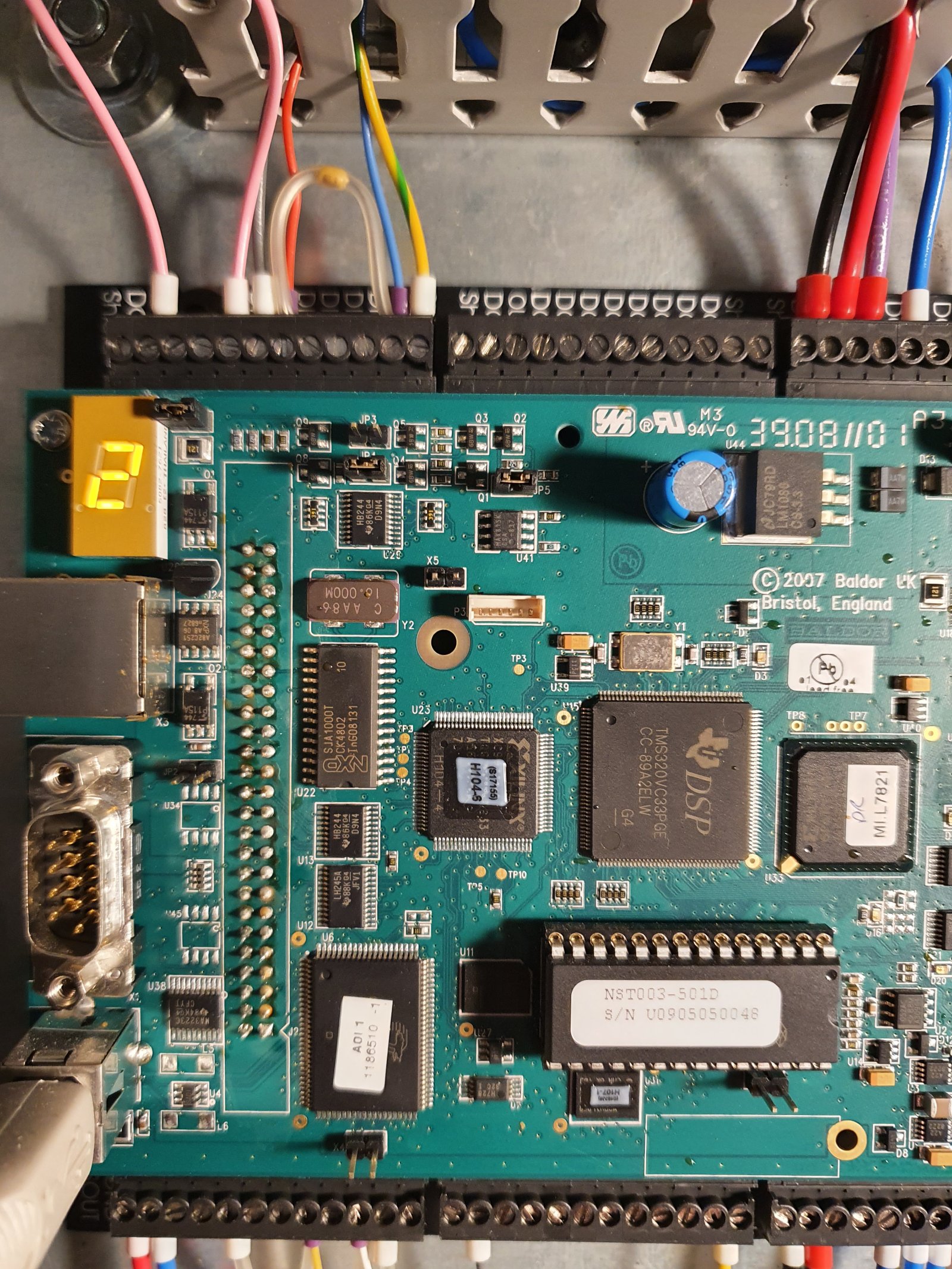

Just to get me going on the board at the top left hand side there is a yellow led number 2 is the normal ?
Re: All the gear no idea
the numbers are actually letters. There is a list somewhere on the forum to 'decode' what it is saying, Took me ages to understand the 'numbers' it was flashing up at me once was E 5 t 0 P, or E Stop, meaning the emergence stop was pressed!
Not sure is this is valid on the later boards but I think it will be https://www.denfordata.com/bb/viewtopic.php?f=54&t=3167
Now looking back through your problem and that display code looks like the E stop is pressed, if it is seeing that you can't open the door. So it looks like there is an issue on the E stop or have you gone and knocked the button and not released it?
