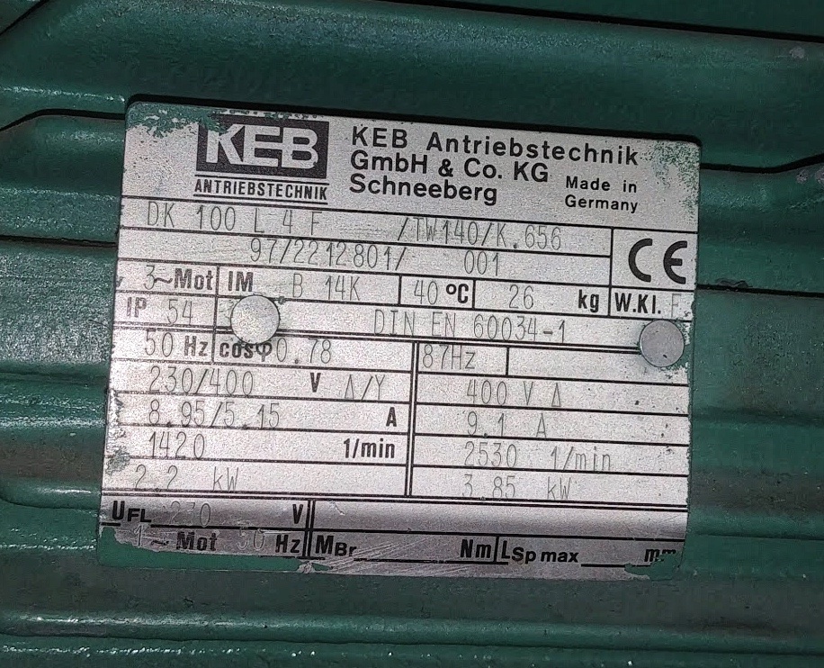

Here is a photo of the motor plate if anyone wants to see it:
You mention that they maintain constant torque to 3kW although on my machine plate it says 2.2kW. Does your machine have a higher rating?
I wonder if I would lose anything with 230V Delta as that has constant torque up to 2.2kW, the same as the rating plate on the machine?

Sorry, should have said 2.2kw.
There is no reason you couldn't.

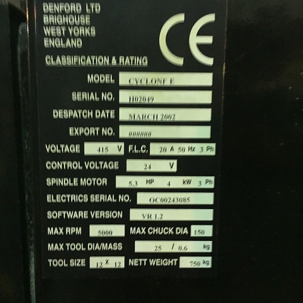

I spoke to KEB and asked them the maximum speed this motor is rated for and they said 3600 RPM. So why put 5000 RPM as the maximum on the machine when this is way over the spec of the motor?
I see there are 2 different motor specs for the Cyclone. There is the 2.2KW like mine:
Cyclone 2kw.jpg (128.15 KiB) Viewed 35671 times
And then there is the 4KW on this later example:
Cyclone 4kw.jpg (61.92 KiB) Viewed 35671 times
Could it be that both machines have the exact same motor and VFD but they only differ due to the settings in the VFD? My KEB F4 VFD is spec'd at 4KW.
Re: Cyclone TU150U spindle power clarification
On my spec sheet from Denford, it quotes the motor as 5000RPM 4KW, but I'm pretty sure its the same motor as yours, just originally run at 415v variable frequency rather than 230v variable frequency, both wired in Delta.
Also, you won't need a 4KW VFD if you are switching to 230v input, as the motor is only rated at 2.2KW in this configuration, so you could save some pennies and get a smaller inverter. I got the 4kw, because the KEB I took out was rated at this, but that was driving the motors at higher voltage, hence the higher power rating.
I have done some test cuts, only very lightly with my mpg wheel as I haven't fully got the CAM side sorted, but the motor didn't seem to drop in rpm any, again, if you were putting a 2mm cut on, it might be different... But it might be the wrong machine for the job anyway if you wanted to do that I'd imagine.
