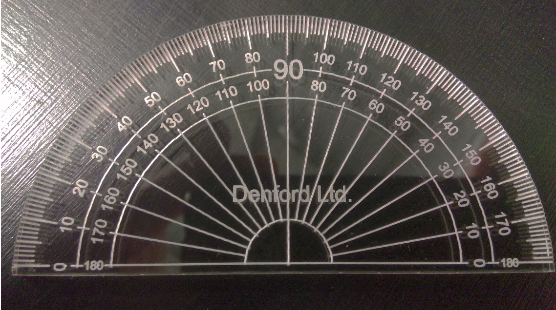

Laser Cutter project suitable for various materials, but ideally 3mm translucent acrylic.
Techsoft 2D Design.dtd file
Red indicates cut lines
Blue indicates vector engraving
Black indicates raster engraving
