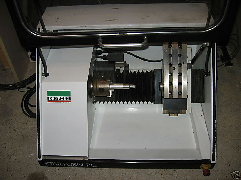

Would this happen to be a Starturn 5 ?
https://cgi.ebay.co.uk/Denford-Starturn- ... dZViewItem
Sorry about the length of the link :P
Starturn 12 - now that sounds interesting!!!!
Dave
Just for prosperity I have "nicked" the picture off ebay...
It certainly looks like it was JUST about to change into a Novaturn - the turret is the same -just the electronics were getting out of date.
