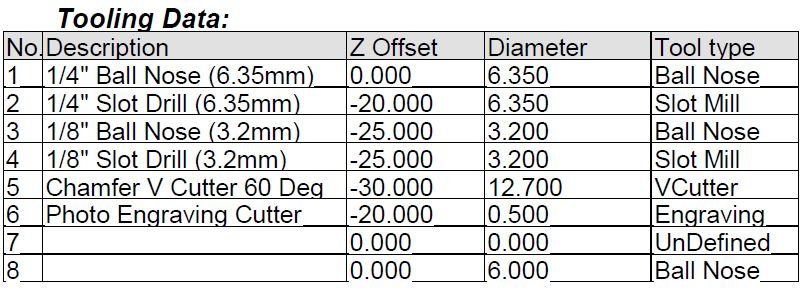

The tool rack project allows you to not only store your tools where they are clearly identified but allows you to refit tools and set the offsets automatically.
The Long series ¼” Ball Nose Cutter is stored as Tool 1 the reference tool and will have a zero offset the other offsets are set in relation to this tool and will have preset values.
Tool offsets.JPG (66.61 KiB) Viewed 18969 times
Using the Quick Change toolholders the tools can be fitted and set to the correct length then secured in position.
