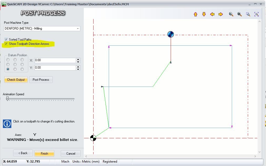

Pete,
Do you have QuickCAM 2D Design On the simulation page you can see the direction of cut.
If you click on the cut in question you can reverse the toolpath. Then postprocess
sort tool path.JPG (66.2 KiB) Viewed 19769 times
sort tool path1.JPG (59.6 KiB) Viewed 19769 times
