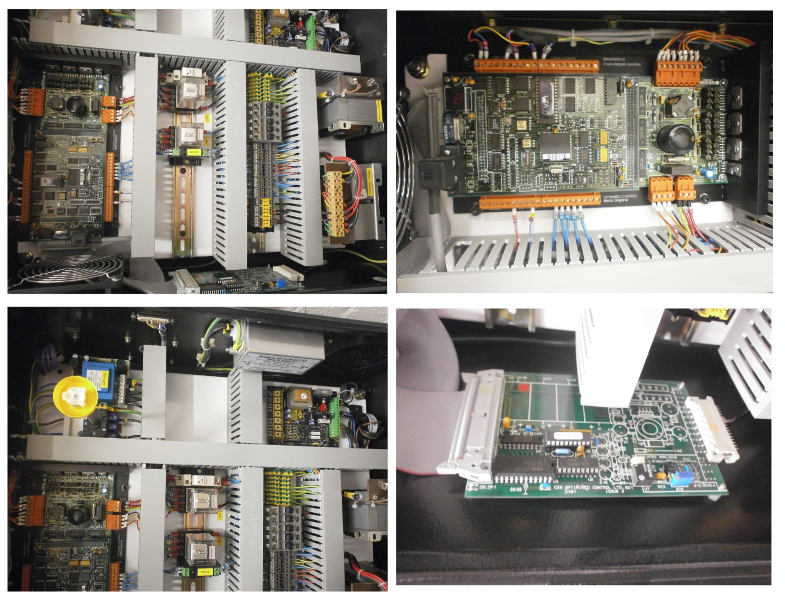

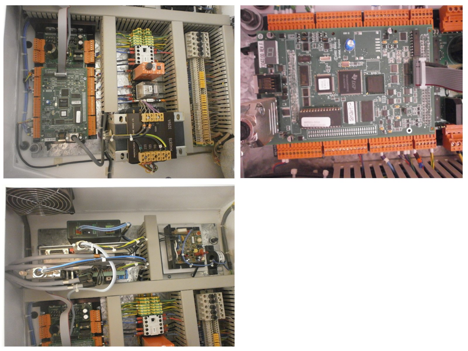

We have a 1996 Novamill
download/file.php?mode=view&id=4812
And a 2004 Microrouter Pro
download/file.php?mode=view&id=4813
I have to admit, I have little idea on what I am doing in order to get these running :oops: To make matters more complicated, the XP PC's that were running these machines have burnt themselves out. Fortunately, we have all the original software disks, dongles, an registration floppy disks, along with necessary RS to parallel cables. Problem, the computers we have, including the one we have reinstalled the software onto, does not have a floppy drive, nor a parallel port.
Microrouter Pro 2004.jpg (295.61 KiB) Viewed 21333 times
Novamill 2006.jpg (364.4 KiB) Viewed 21333 times

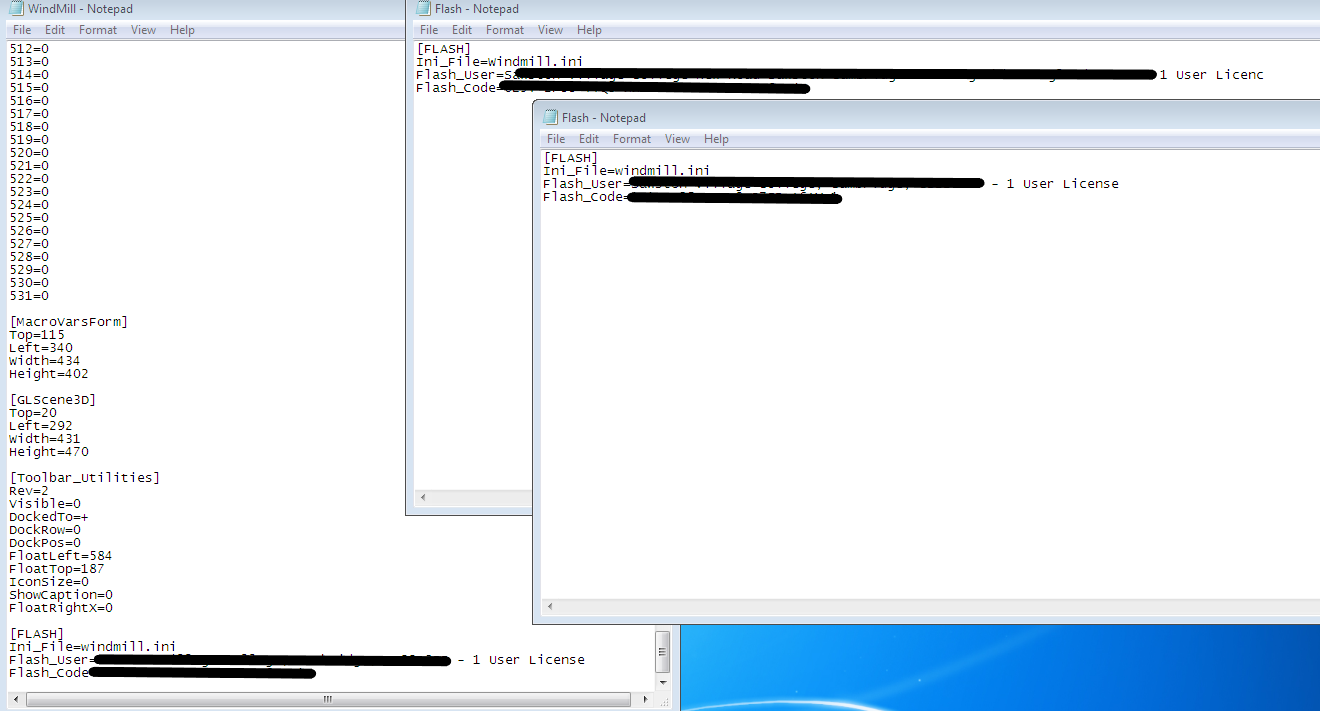

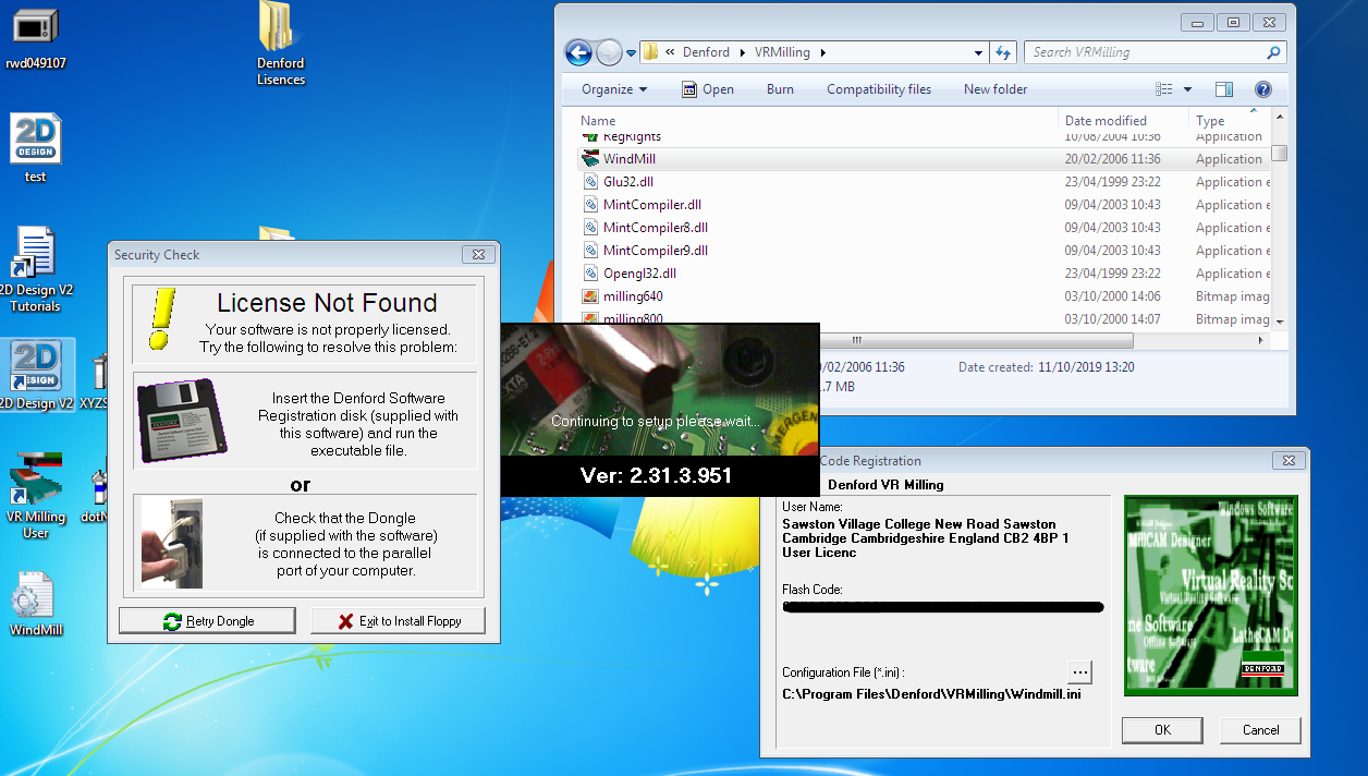

I was wondering if anyone had been able to get VRMilling V2 up and running on Windows 7 32bit? The website says it has full compatibility, but I am struggling to get the software to read the flash.ini files.
I have located the flash.ini files on the floppy drives and used the 1021 PDF file to copy them in to the windmill.ini text file, but the software continues to ask for either the dongle or registration disks.
download/file.php?mode=view&id=4823
download/file.php?mode=view&id=4822
I have also tried all the various compatibility modes as suggested by tech support.
Any suggestions would be gratefully received!
vrmilling attempt 2.PNG (114.04 KiB) Viewed 21302 times

Hi, I haven't got a PC with Vr2 on at the moment and a bit snowed under, I think I have a win7 PC still, I know I def have an XP machine, If I get chance I will run an install but it has been a long time since I last did it. Martin is normally great help for some reason I seem to think the flashed info within windmill shouldn't have the line ini_file=windmill.ini, I think that was just a line to say where to put the licence line into.
Re: Old Machines, Old Software, Dongles and Floppy Disks, Help!
Just had a look at a v2 licence file although not flashed onto VR milling, the Ini_File=Windmill.ini is the last line not the first eg
{FLASH}
Flash_User=xxxxxxxxxxx
Flash_Code=xxxx-xxxx-xxxx-xxxx-xxxx-xxxx-xxxx-xxxx
I don't know if the order would make a difference but worth a try.

It may be worth checking that VRMilling version 2 is only installed once.
Try searching for the Windmill.ini file to check.
If you want I can check your licence at Denfords if you sned it accross.

I have been emailing Graham from tech support too, he has suggested trying this:
"The only thing I can think of, is to modify the 2nd line in the FLASH listing and put and put the full path in to the Windmill .ini.
Ini_File=c:\************\windmill .ini"
So I will try this too!
