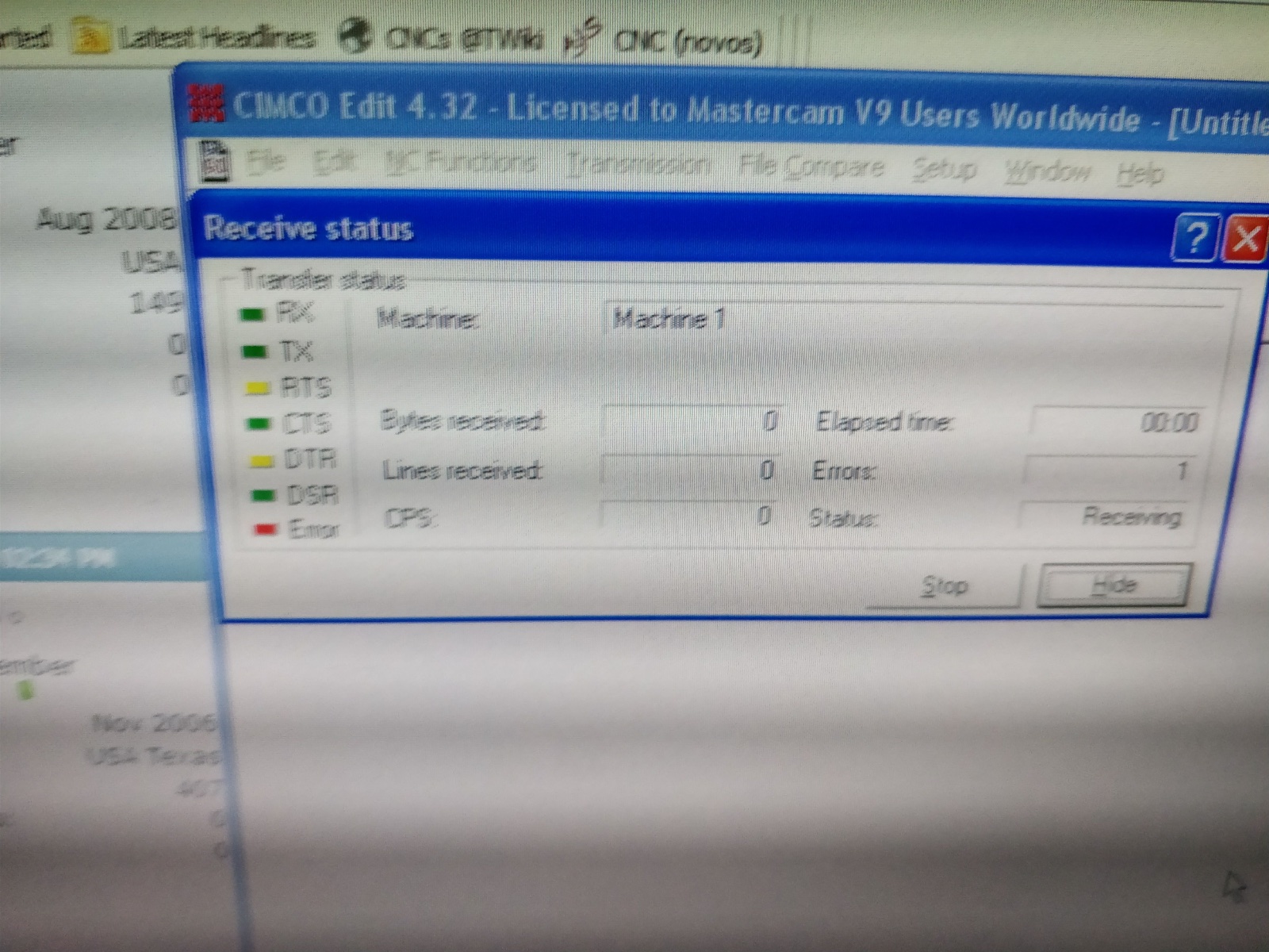

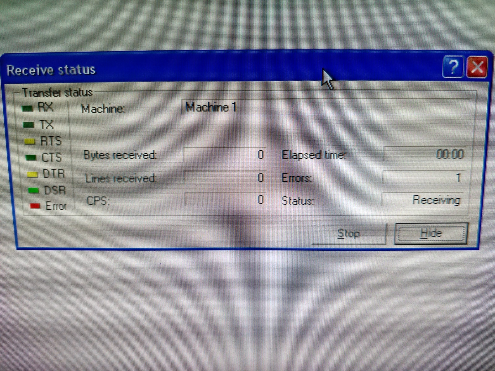

Now, from what I have been reading, the problem can be in the RS232 ICs, specifically the SN75188N and SN75189AN, that could be burnt.
Do you think this is what could be causing this error?
Attached, I send two images from the CIMCO error as well.
Thanks again for all the help.

Re: FANUC TRIAC SERIAL COM Error
First of all, let me apologize for the delay in replying, but I was on vacation and didn't see the post.
Answering @Martin, I have shifted the cables, so the only possible explanation will be on the CNC's serial COM side.
If I send any program, it does not show any error on the Fanuc, but it shows the error that I posted before.
