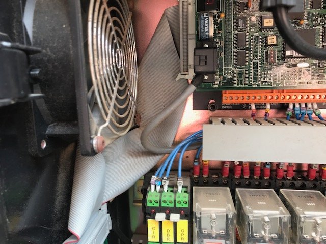

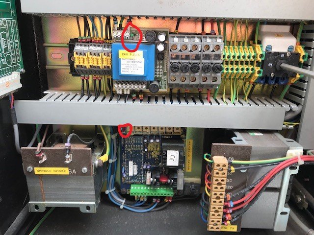

I have added some pictures not really sure if they are the ones you need.
the second image is marked where the LED's illuminate. The blue PSU 24v illuminates and the board at the bottom and the board marked spindle drive illuminates with a faint red glow.

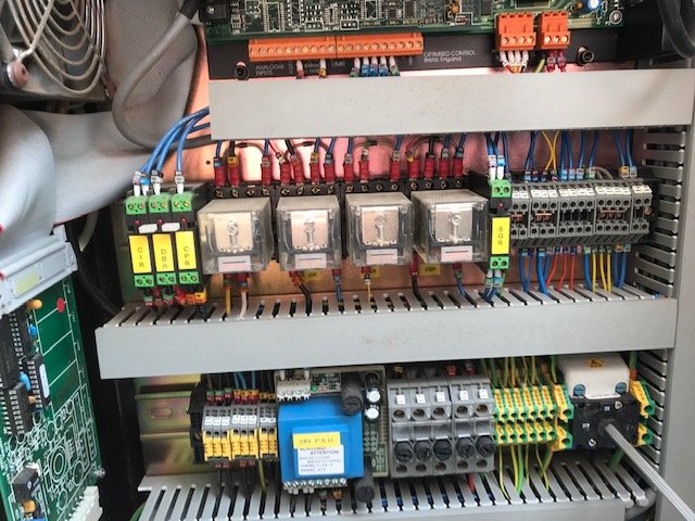

I have just gone through the whole cabinet and the following relay items are unlit also.
CPR
DBR
CIR
SGR
https://photos.google.com/photo/AF1Qip ... qG419WfpB
don't know what the abbreviations stand for either

The abriviations are Spindle Go Relay drawbar Relay carocel power and carocel in

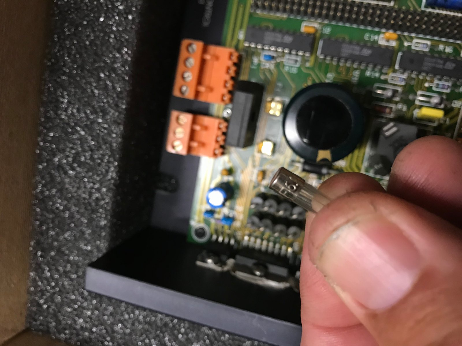

The fuses are "Littelfuse, 80mA Glass Cartridge Fuse, 5 x 20mm, Speed T 250v" replaced with the same from RS-Components part No.:541-4151.
Re: My Novamill won't run
Hi, The fuse on the board supplies the regulator and stepper motors so an 80mA fuse is far too small and will blow.
I have checked a smartstep card here and the fuse fitted is a 6.3A F rated fuse (Quick Blow).

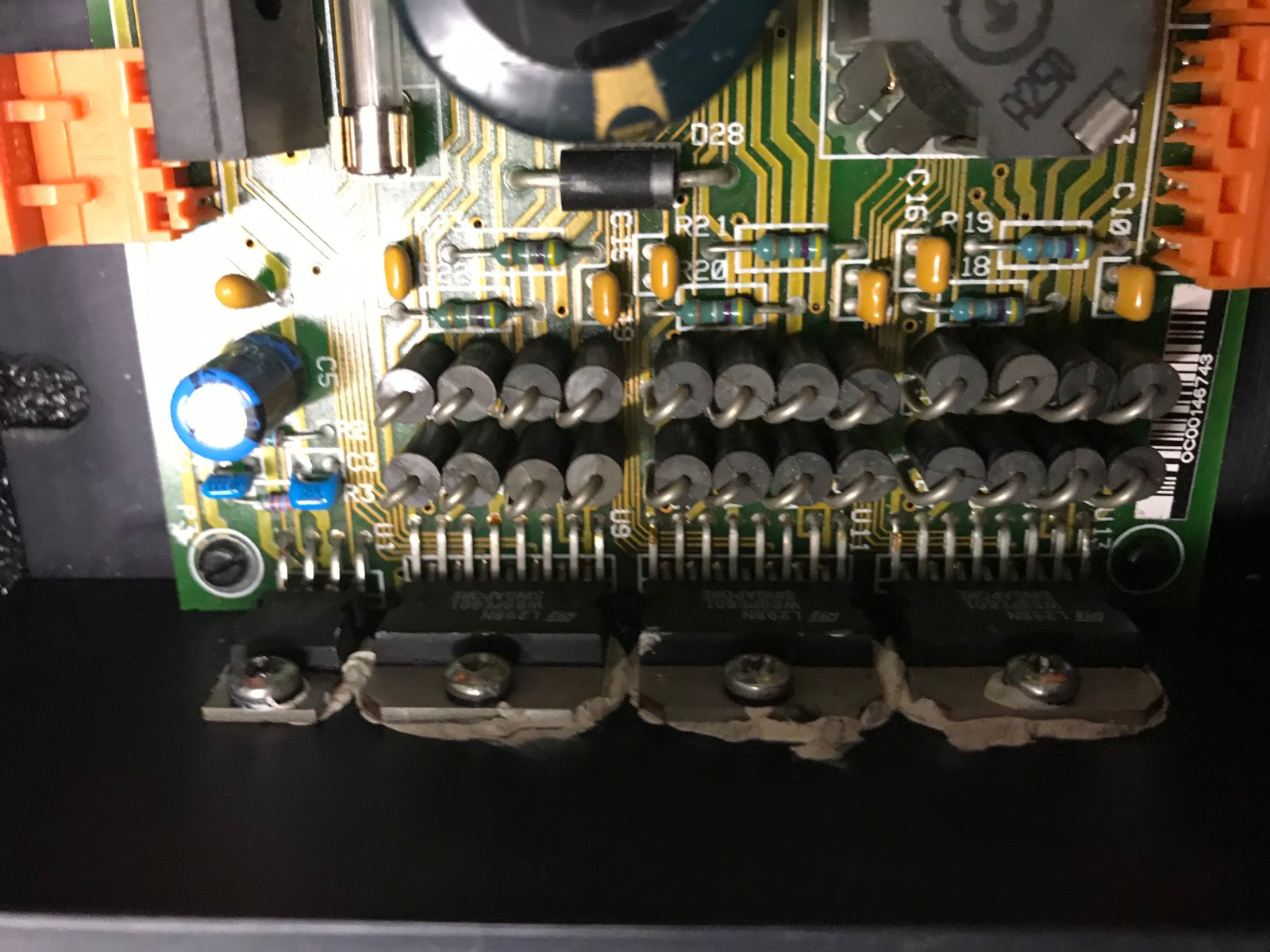

Fit the correct fuse and all may be resolved. If the fuse still blows with the connectors unplugged then can you check the stepper motor drive chips and regulator for signs of damage. If a stepper drive has a fault or the stepper motor wires are shorted out it will blow this fuse.
See pictures attached showing fuse and driver chips attached to the heatsink
