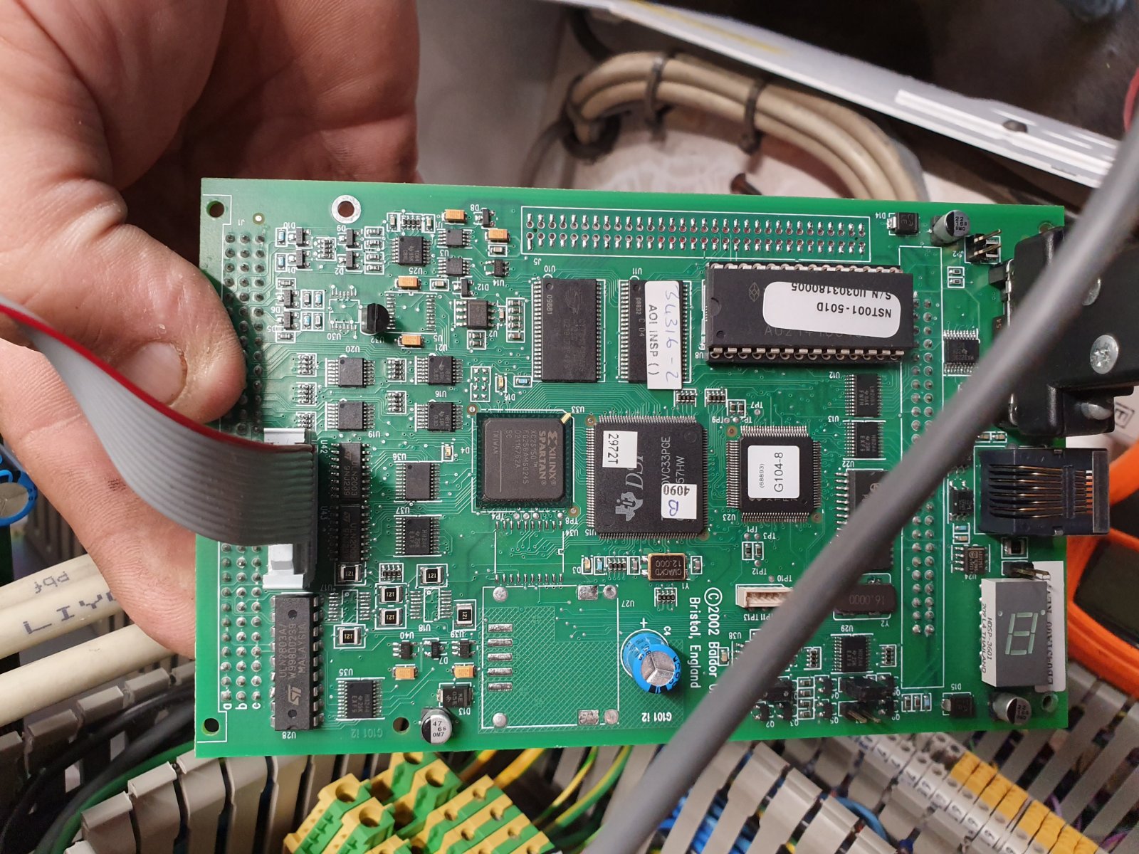

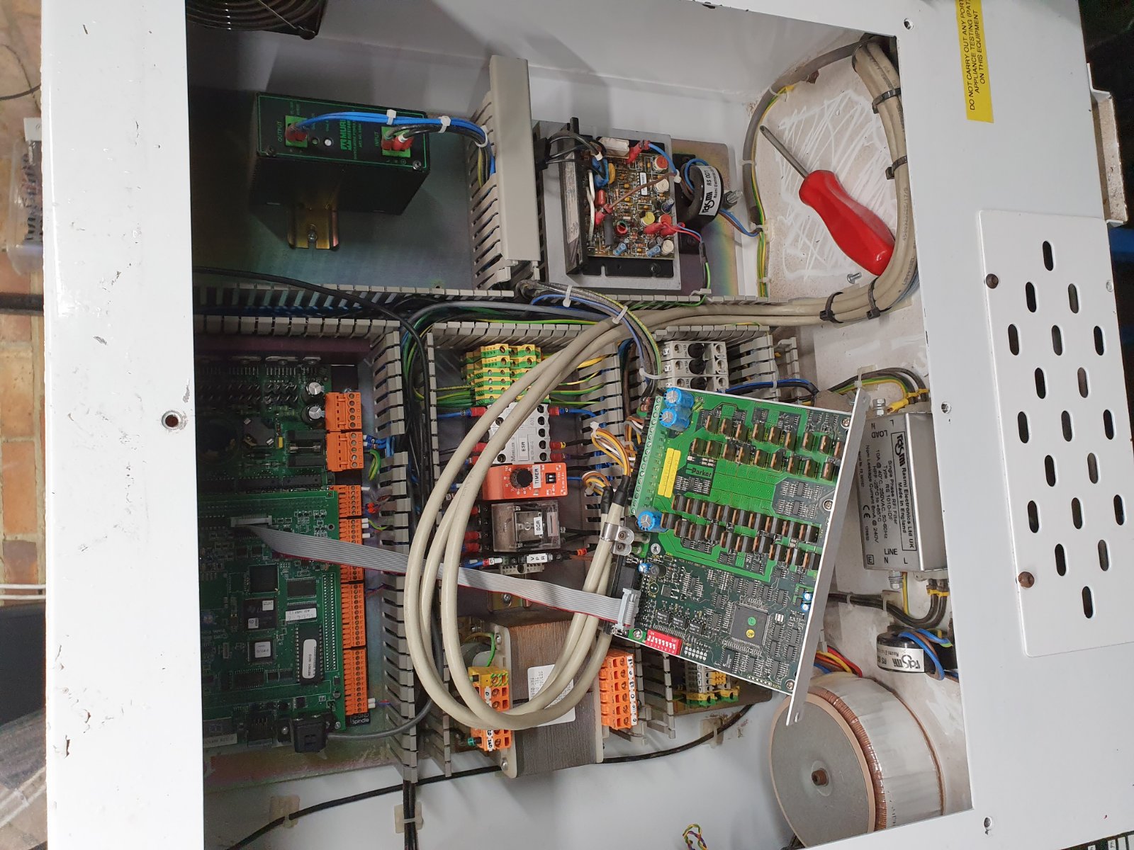

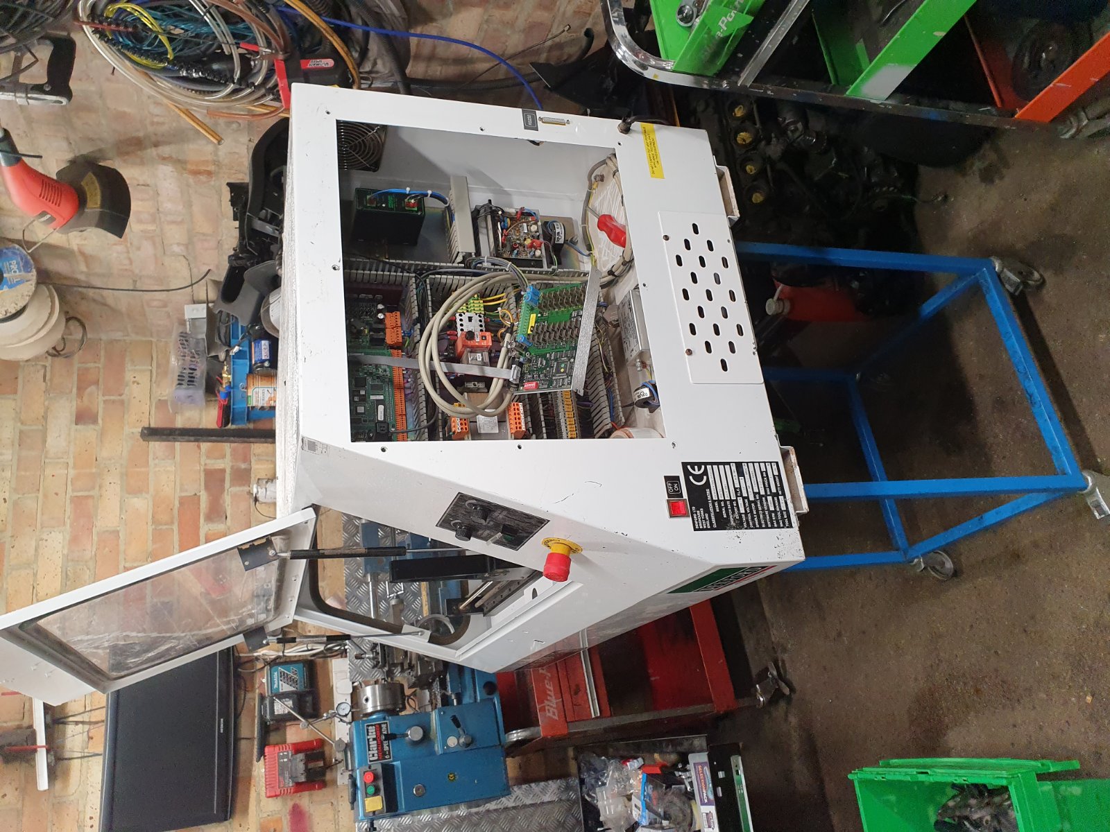

Hi all I have a microrouter v5 and I'm having a problem I bought the machine the other day it was sold to me as faulty I'm trying to diagnose it but cant find much info it has a next step controller board I think and a separate 3 axis driver board my understanding is when you turn the machine on it should home bat all it does is try and move all the motors it's like they are not getting enough power I have checked a few bits but to no joy can anyone tell me how much power cones out to turn the motors I'll try and put some pictures up any help would be appreciated thanks

Nothing should move on the machine until it's connected to VRMilling.
Does the green LED on the NextStep control card light up?

Don't hook up a PC yet, fire it up and you need to look at the top board and observe what the LEDs do and 7 Segment display.
Nothing should move, you should hear a clunk after a short period as the door lock opens to enable you to open the door.
If something is moving on power up, power it down and disconnect the ribbon cable from the top board to the drivers, that will give a better clue as to where is issue is coming from.

Sorry for the late reply iv fixed it it was the main board luckily I found a used one on ebay for 35 and took a chance now it's working fine I use a rs232 converter and have no problems at all just got to get used to this denford software now it seems quiet easy can you guys recommend what animals I should be using I'm new to all this but want to definatly have a play around
