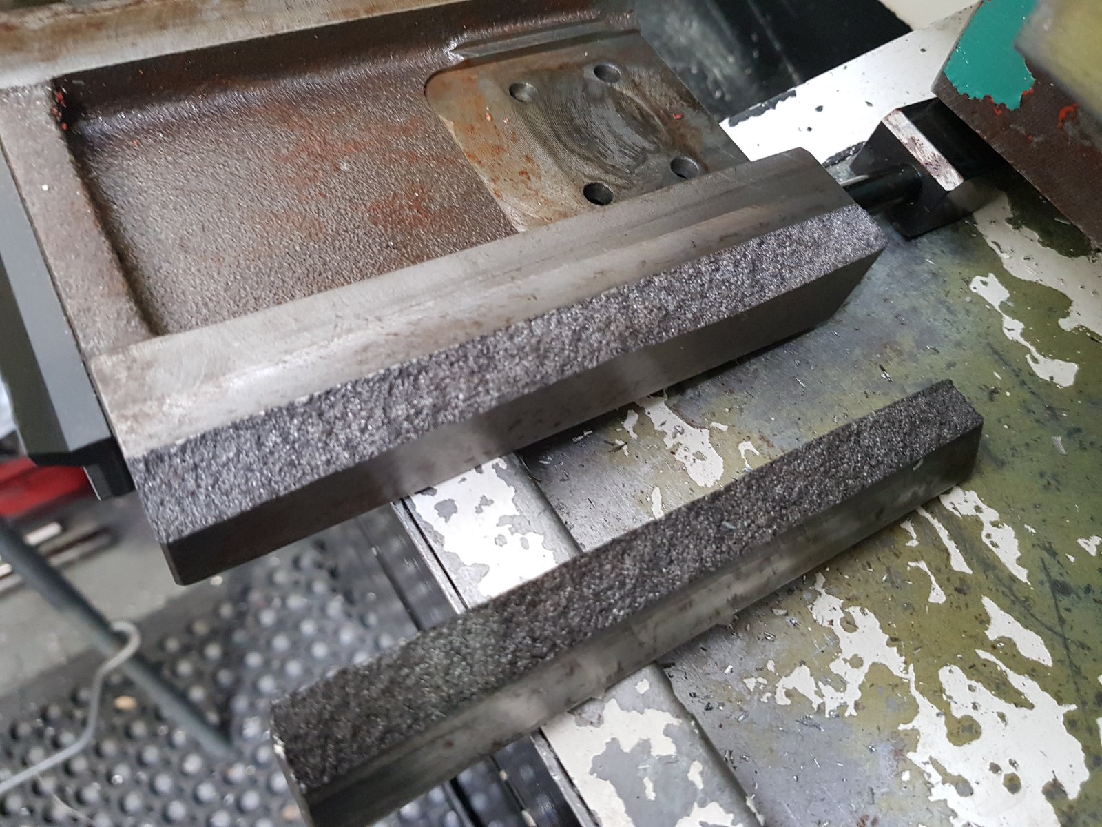

Had some problems with the lathe especially parting off, could push and pull the turret up and down about 0.5mm. Put clock everywhere and couldnt pin point where the play was, then the dovetail fell off, must have been cracked (probably tightening the Gib didn't help)
Milled away the bad part

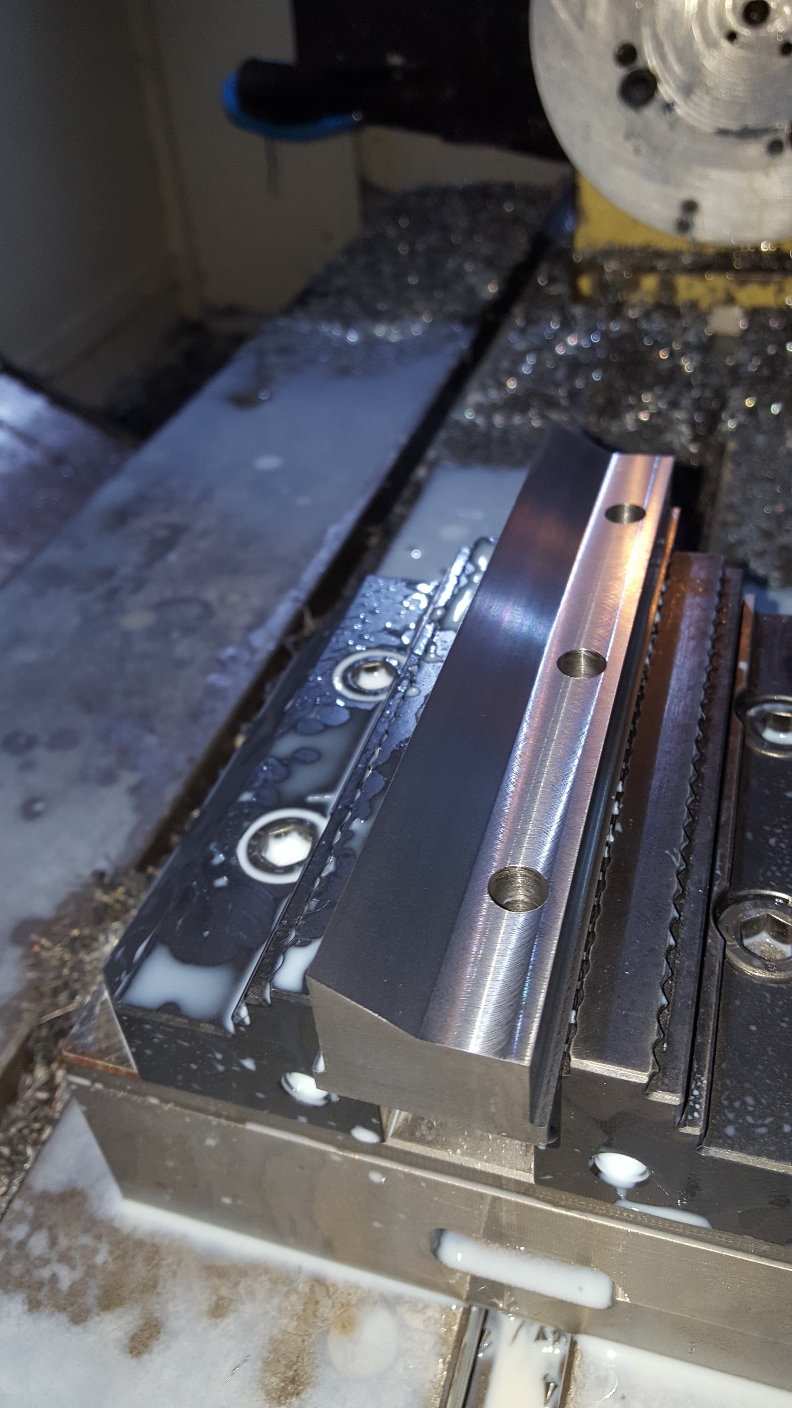

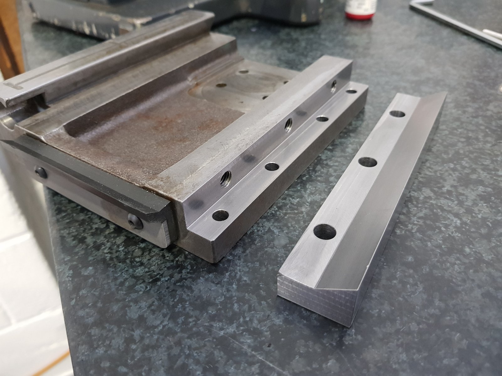

then machined an insert out of a bit of cast iron

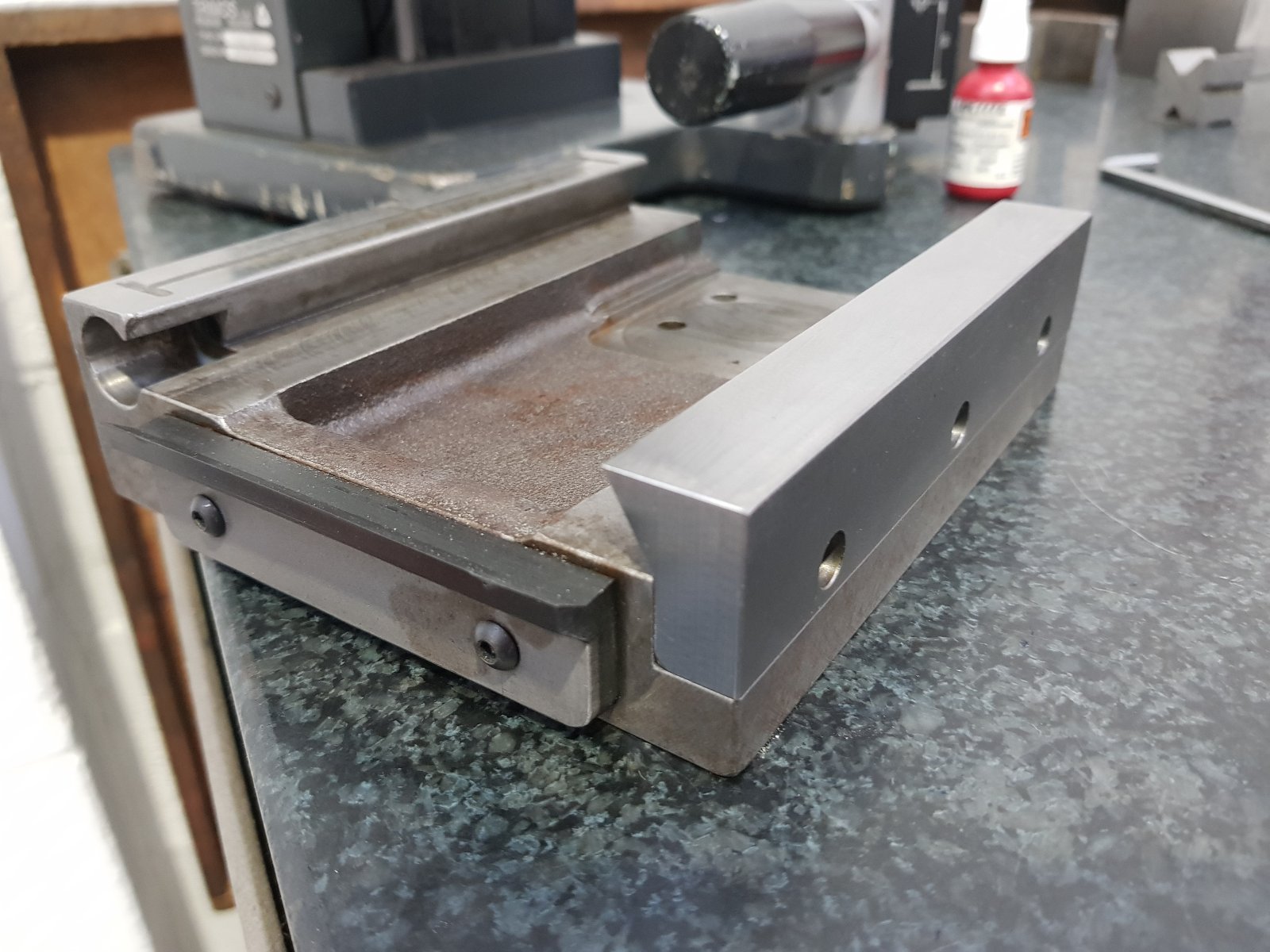

Finished assembly...

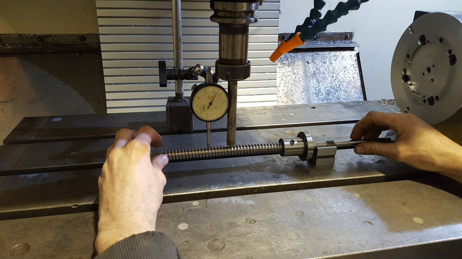

Ballscrew had a 3mm bend in it so had to straighten...
