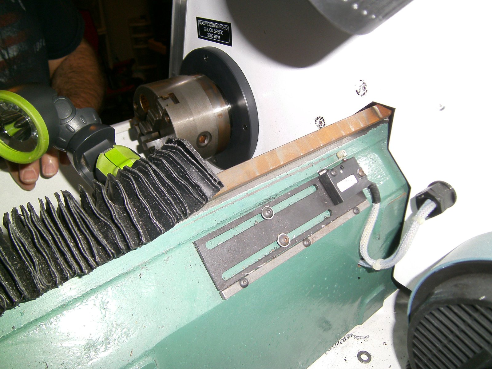

I removed the way cover to get a better look. Attached is what I was asking about. It appears there's a proximity switch on X and a roller contact switch on Z. So why is it like that? I'm assuming the proximity for safety reasons, but why use a contact switch that's subject to bounce and arcing issues. Is it the same on the opposite ends of each axis?
Re: Switches
The switch in the second photograph is the Z- limit switch which can be adjusted to stop the tooling crashing in to the Chuck depending on what's fitted.
If you look on the opposite end of the bed you should see the datum proximity sensor.
