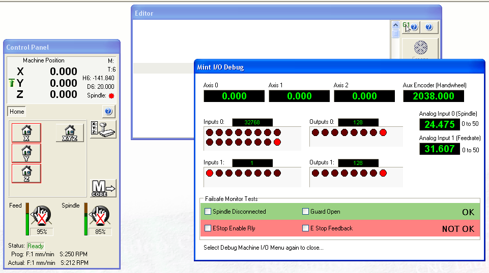

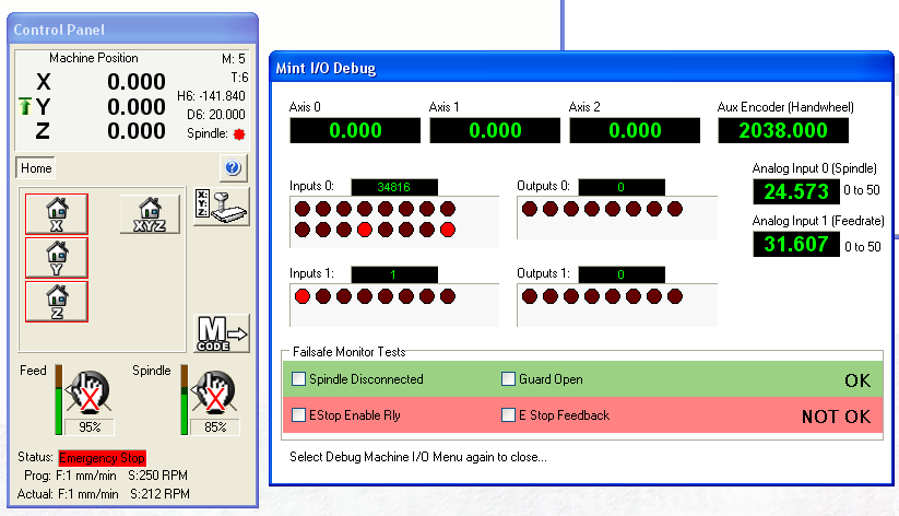

My VMC1300 will jog fine, but no spindle action. The Microflex LED is red on power up, then flashing red/green briefly before going back red, so disabled.
I checked the Debug Machine I/O page, and it shows the Estop Enable rly unchecked (see pic). I tested the Emergency Stop button, and can hear the relay and see the Control Panel status change. Tried on/off a few times, but no Estop Enable rly checked.
Estop test.png (69.81 KiB) Viewed 13608 times
Estop not enable rly.png (97.57 KiB) Viewed 13608 times
BTW, I tried to start the spindle on control Panel and by running a program.
Any suggestions for more diagnosis welcome

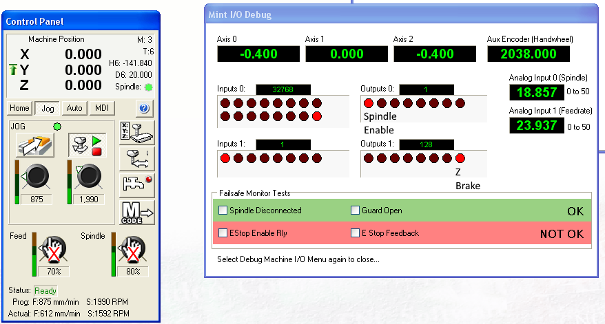

I thought it probably helpful to include an image when the spindle is "started". No rotation, but I heard a relay click. Indicators annotated based on a post "INPUT AND OUTPUT ALLOCATION ON A VMC1300"

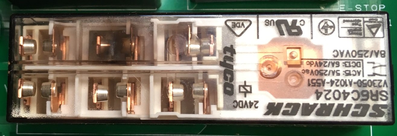

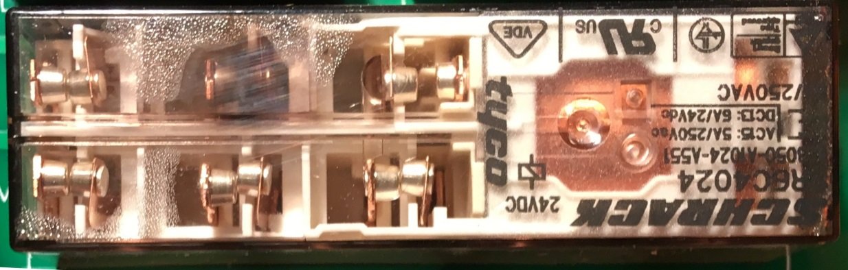

I'm still working on my lack of spindle. Given the E-Stop error in first posts, I've been examining the E-Stop relay. 2 images, one with no power on the machine, the second with the spindle "on" via V5 Milling (but not turning). Confirming the MicroFlex led is still red when the spindle is "on"
E-Stop no power.jpg (104.97 KiB) Viewed 13592 times
E-stop Spindle on.jpg (101.33 KiB) Viewed 13592 times
I understand from other posts I found, that the spindle contacts are the lower row, both left and center connected in parallel
