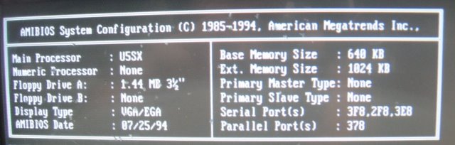

At switch on the built in PC's BIOS shows that there are three com ports, which is correct.

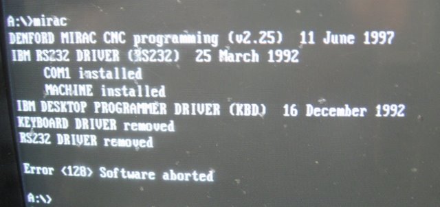

If I run the Mirac DOS software, as downloaded from this site, it aborts with error 128 after installing or perhaps attempting to install the keyboard drivers. Does anyone know what causes this? Error 128 seems to be all embracing and is also reported if the drivers are not present on the installation disc. If the PC couldn't talk to the Eurocard wouldn't I see error 50?

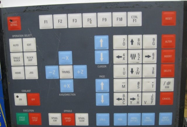

Does my mirac.go file specify the correct keyboard driver? The machine has a built in mirac 1451 keyboard, not a tutor keyboard. I get the same error message if I edit the mirac.go file to use the denford1.kbd driver.

Hi Ive just been hunting back through posts as I had this issue with a Starturn, it was a coms port error (in the end TX/RX lines in lead needed flipping over for me) BUT the 128 error and then it removing the drivers is just and indication it couldn't talk to the machine so it stops loading it all.

I have a DOS utility which can detect com port hardware and whether a serial device is connected to the port. It correctly reports the presence of com ports 1, 2 and 3, which I assume use the standard address ranges. It can also detect the keypad on comport 2 $2F8 and Eurocard on com port 3 $3E8. If I disconnect them at the end remote from the PC they're no longer detected. I have no idea what form the detection takes though. Possibly it just looks for some conditions to be looped back. There is no facility to check and configure interrupts in the BIOS, so I assume they're selected by links on the com port cards. I cannot imagine they've been changed.
