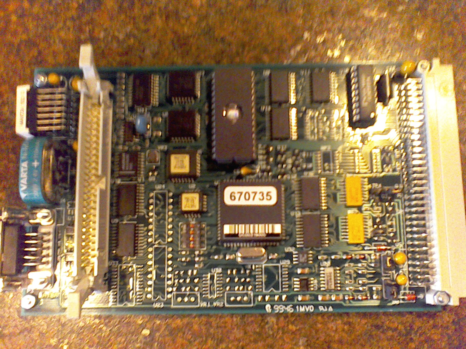

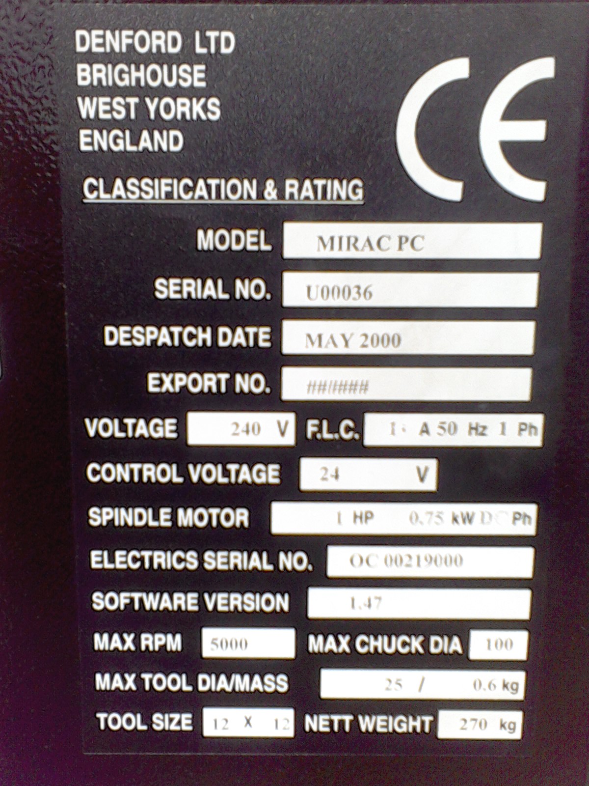

Do you know exactly what you want? If it is VR milling or Turning? you will need to supply info from the machine plate but I would also open the cover plate and get the software version off the eprom; they got upgraded over time but it might not be updated on the machine plate. You need that so you can get the correct version.
Re: Response time
I was looking for info on turning. Attached are the data plate and eprom.
Re: Response time
Is there anything else I needed?
Re: Response time
No that's all they should need, the only thing is the 32pin eprom (chip) with the little glass window should have a sticker on it saying the software version. without that it is hard to be sure if it has ever had an update. The sticker is also meant to be there to stop UV getting to the internals of the eprom, When you want to erase what is on it you expose that section to UV. I would put a bit of black tape over it.
