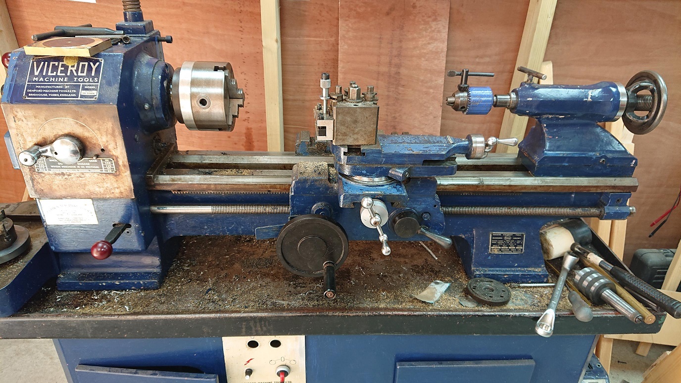

I've recently acquired a viceroy, stamped TDS3 M&WL, I understand was once in a school. Overall it seems to work well, however I have one problem I cannot work out how to get the power feed leadscrew to run. I can joggle the red handle on the front, and inside the rear inspection cover for the headstock gearbox I see a dog clutch engage with a chain driven sprocket. All that lot turns, but the leadscrew itself remains still.
Could someone have disabled the feed, or is there a shear pin I can't spot which has sheared?
It looks like quite a project to disassemble to investigate, so I am hoping for a few tips which might help.

I'm not sure it really helps, but here's a picture, from the best angle I could manage!

Hi MrKev,
Put up a good photo of the front of the lathe, showing all the controls.

As requested, here's a couple of pics of the front

I am sorry but unable to be specific as to the cause of your lathes problem, but most of the Viceroy range I believe have a shear pin in th lead screw
drive and I suspect that is causing your problem. I think the lower lever on your machine is a possibly for leadscrew foward neutral and reverse.
If everything turns inside the rear drive unit then you need to trace down to the inside end of the leadscrew and try to see if there is any sign of a
shear pin.
BTW Tony at Lathes UK is requesting pictures and info on the combined wood and metal turning lathe especially if chain driven as yours is.
John

As to the lever, I only get two useful positions, and no obvious way to reverse the feed. Regarding the shear pin, that was I was imagining, but as to actually working out where is is, and for that matter how to get to it... It looks like quite a project to disassemble the head, even just getting to the two cap head screws inside looks like a challenge. More modern machines which have a shear pin have it outside the headstock, so you can easily replace it.
Hmm
Kevin
Re: Help with powerfeed
Posted: Sun 09 Sep , 2018 19:24 pm
by MrKev
It looks like the same location design as the other TDS machines, so I hoped someone might have found the shear pin / key on another and have a pointer. Certainly I can see where change gears might go instead of the bowl turning nose.
