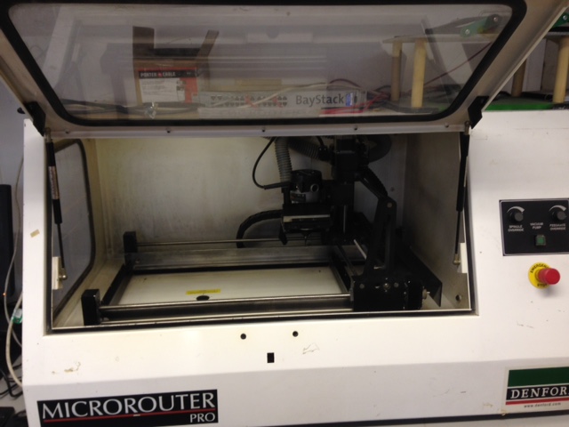

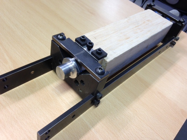

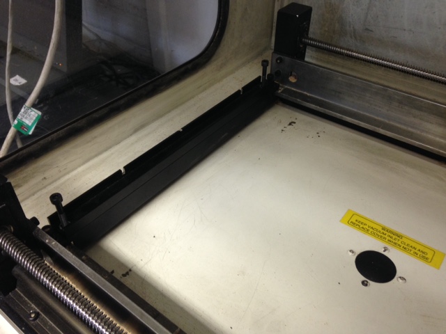

Our school is very keen on taking part in this prestigious event but, like many, our budget is very tight. We have been lucky in obtaining an old style F1 jig that, with a little modification, we hope will see us being able to participate. However, our router is not fitted with a T Slot table/bed so I wondered if anyone has experience of fitting the F1 jig to a Denford router without?
The jig we have looks as though it needs a couple of L angle brackets (see images) which I assume we can purchase from Denford but what else would we need to secure it to our router? A description or a picture of how this is secured would really help.
I have attached some pictures of the various aforementioned in order to clarify what we are working with.
Any help or links would be appreciated.

If you take a look at the attached manual on page 37 you can see how the fixture is fitted.
If you can't find the original rails you may be able to modify the manual clamps you have. You may also need to cut down the side bars to suit the F1 car model block.

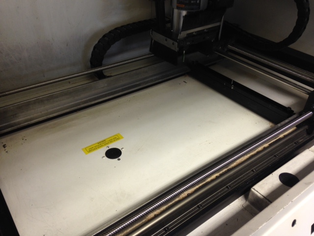

The image is a little dark but it looks like the jig sits between the two Y axis rails. I assume they do not simply push together to clamp it in place as it looks like there are bolts securing the jig on to the LH ‘Y axis’ rail?
Our ‘Y axis’ rails have no holes in them so a quick modification should get us up and running.

They are slightly different rails with clearance holes in.
I did have a quick look in stores but was not able to locate any so it would be easier to adapt the ones you have.

Looking at your machine, you have quite a build up of dust and a word of warning you really need to keep on top of cleaning down and lubing up. I have just had to fully strip 2 machines that had been used for F1 projects as the axis were binding up on them and they were unable to travel fully and were loosing position due to this. The dust gets right inside the 'nuts' that are held in each axis travel by 3 screws. these nuts are what run on the screws you can see driving each axis.

I inherited the m/c which originally had a sacrificial bed. Under which I found hard (almost solid) sawdust. Any tips on cleaning and lubrication (type etc) would

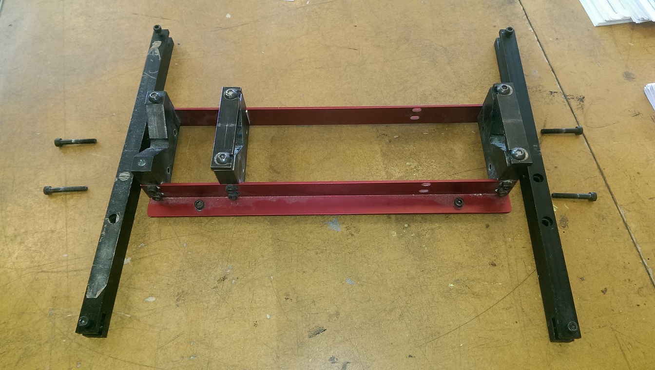

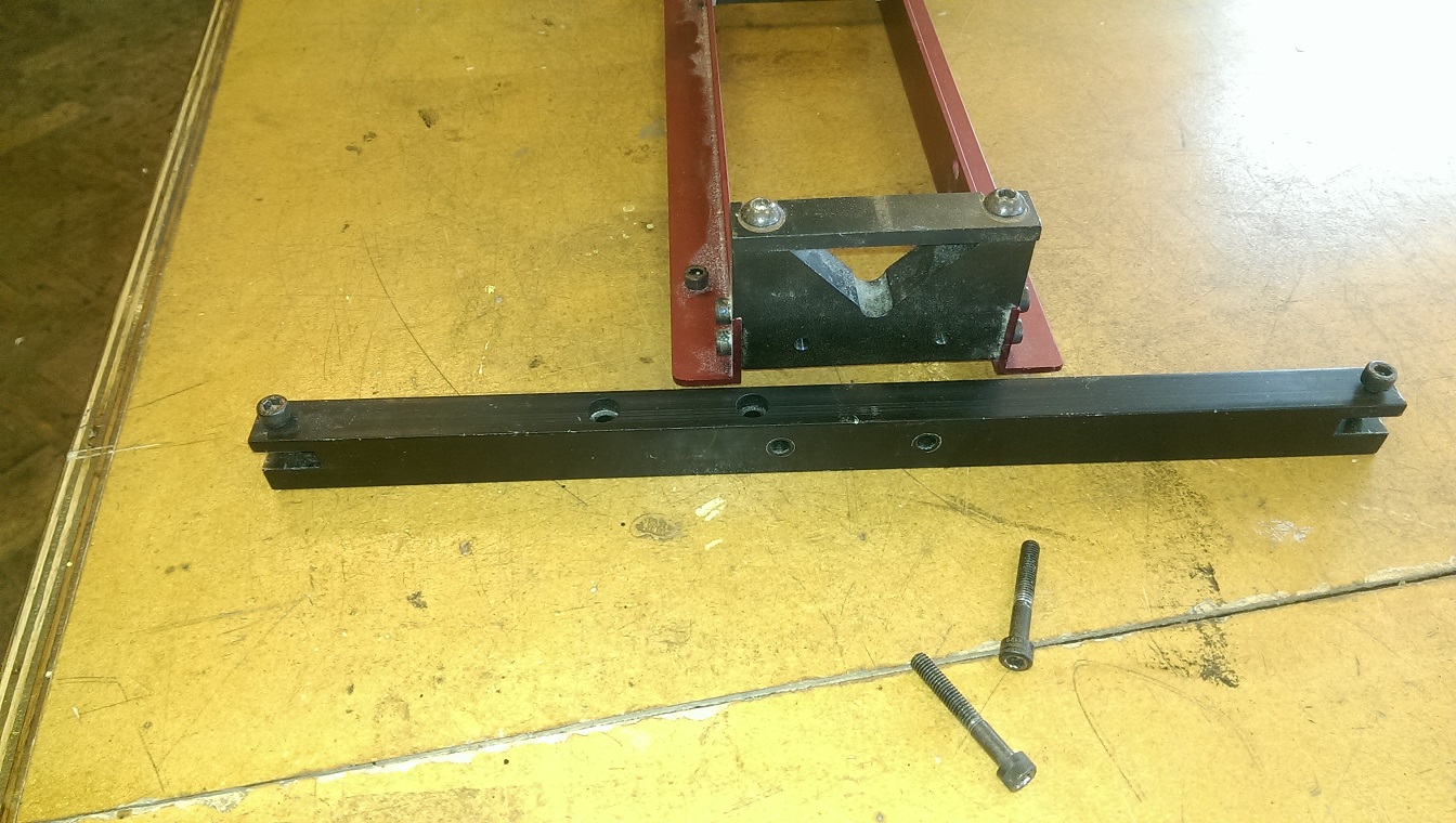

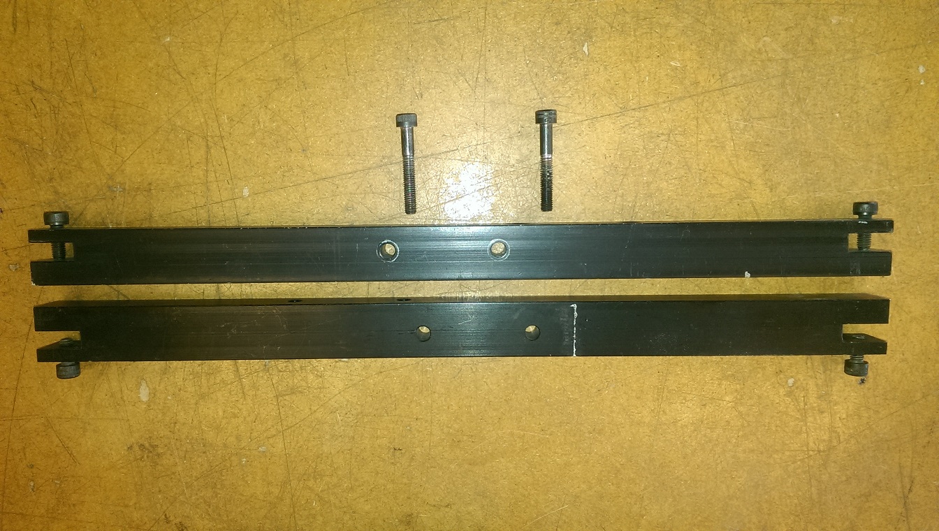

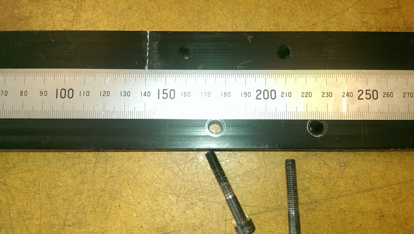

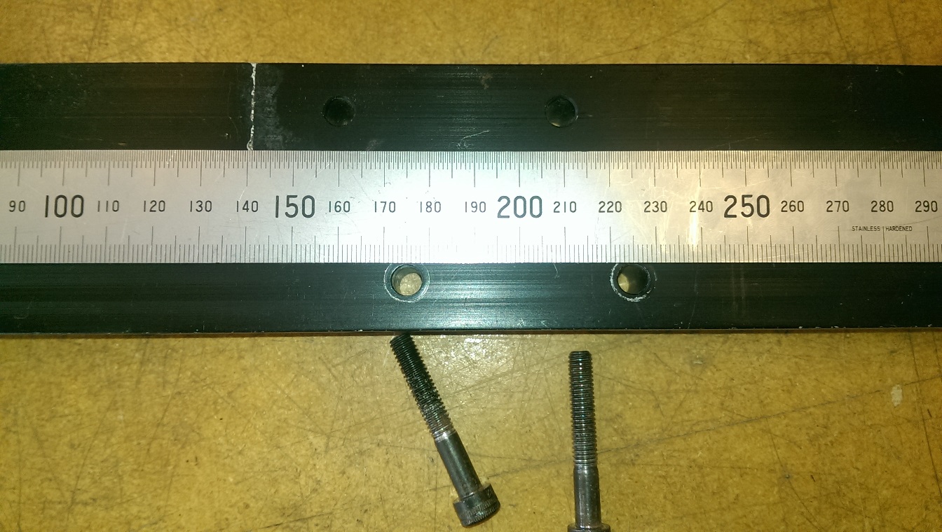

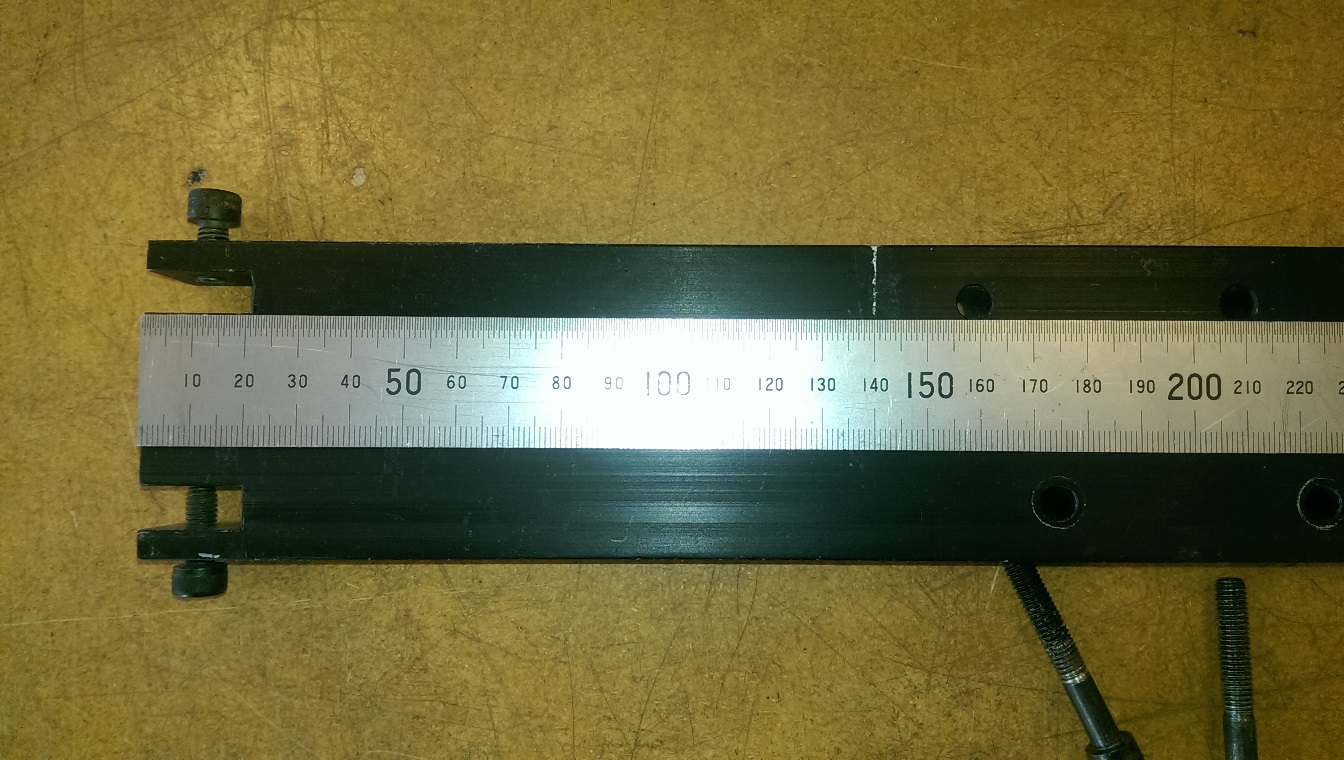

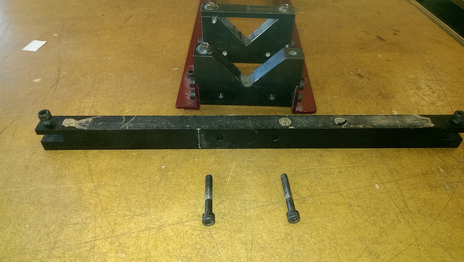

Here are the pics, My frame has an extra 'V' block, you could just cut down the L angle so you can fix direct to you blocks. For some reason the end bar mounting holes into the V blocks are not centred. I can't see this being an issue as you have to zero the cutter to the job anyway. In the microrouter where the end bars fit onto the aluminium rail mine has had t bits of aluminium glued to the top edge to make it easier to re align the F1 set up when it has been removed to do other work.
Hope it helps.
indication of hole centre distance
Indication of distance from the end to holes
End rails showing offset to each other as one is flipped to indicate they are not centred
Whole frame, you can see for yours you just need to cut the L angle down so you can mount into the V blocks
End view of Frame and fixing holes
