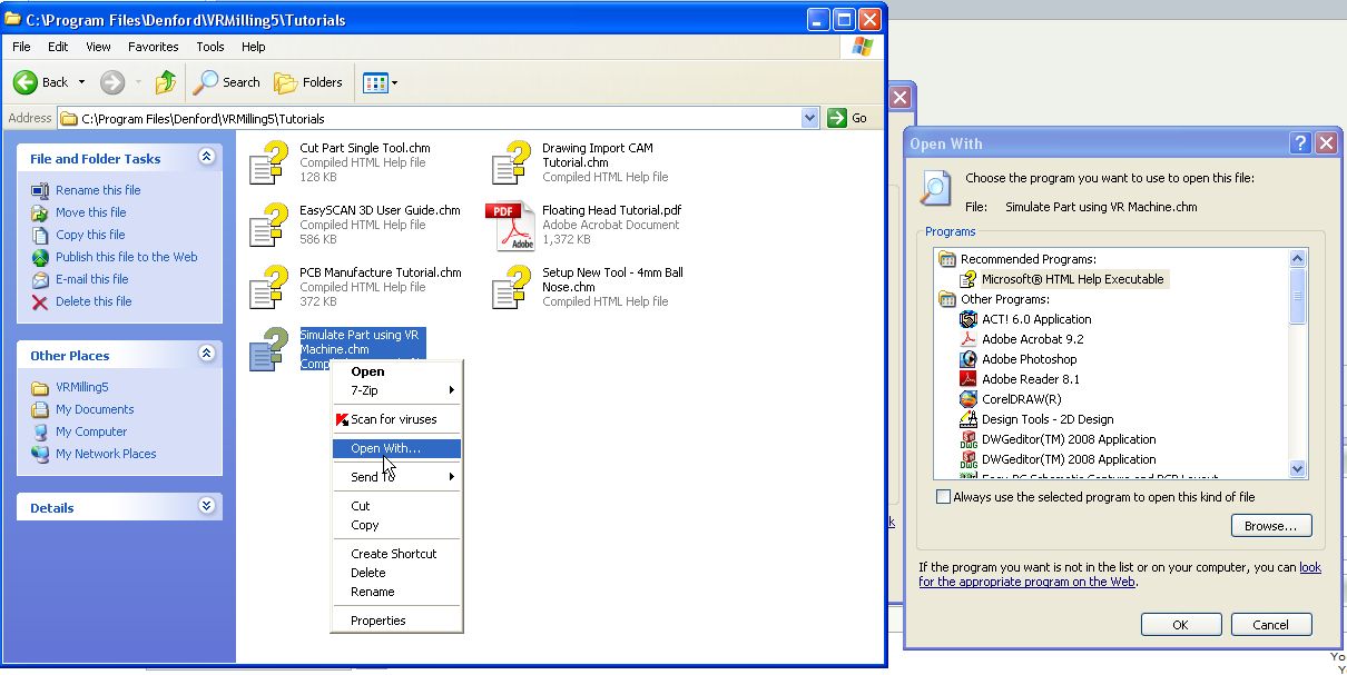

Go to the C:\Program Files\Denford\VRMilling5\Tutorials folder and see what is opening the file by default.
See attached screenshot
Can you open the ttorials by double clicking here?
