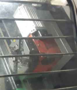

My turret before disassembly and cleaning:
Disassembled:
DM08 or what?<br />The housing _was_ red before cleaning, the paint didn't like my solvent.
DM08 or what?
Looks very much like the DM08 except for the parts marked with red.
Is this some version of a standard turret, or perhaps a previous owner have been creative and replaced those parts?
At the moment I'm unsure if I should replace the turret with a different turret, a manual tool post, or try to repair this one.
Repair would for sure have been much easier if the parts would have matched the drawings posted earlier.
Suggestions are welcome!

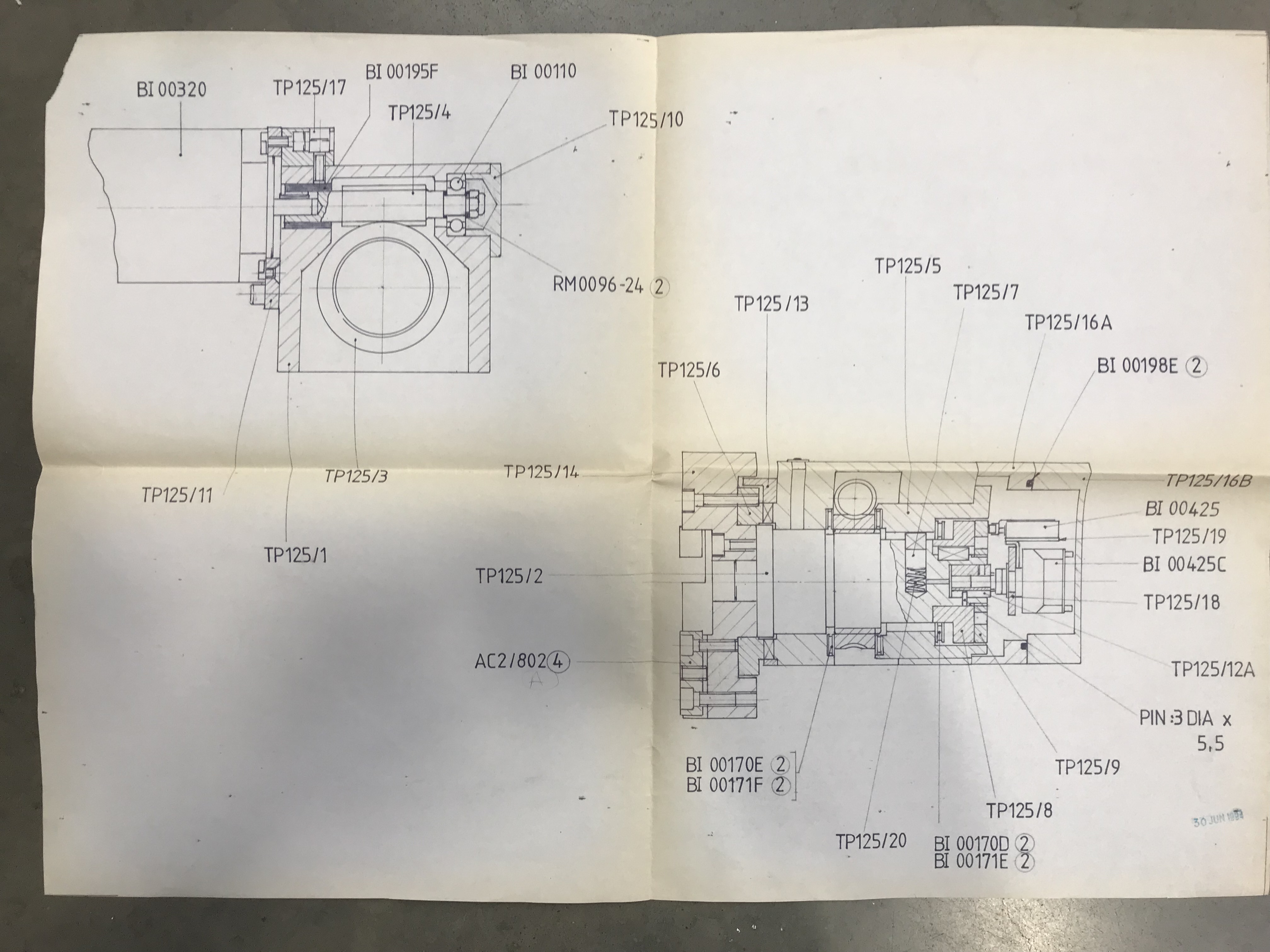

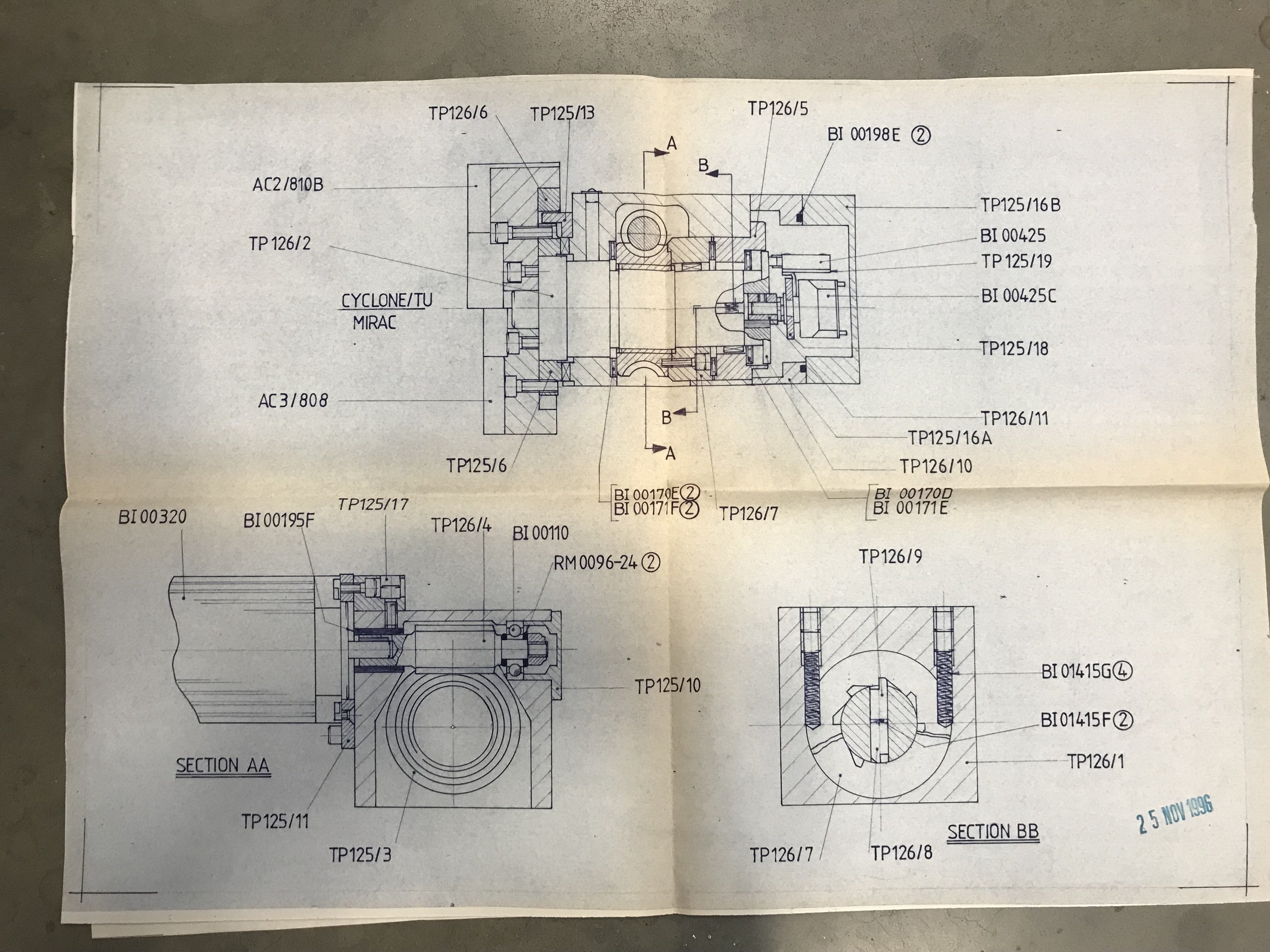

Re: Miarc EO4368, DM08 turret internals? Alternative tool po
Hope these help.
I had to photograph the drawings.
It's fine to add whatever you make think is helpful on to the forum.
Thanks a lot!
Someone hand a good hand with the pen back in the days.
For sure its the older turret.
I could use the drawings of, or even better, the actual parts:
TP125/4 Worm
TP125/3 Worm gear
TP125/8 "some name"
No hurry at the moment, but those parts were quite worn so will need to replace in the future.

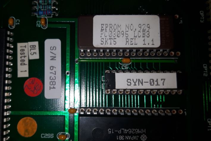

Works with at least this version of controller:
