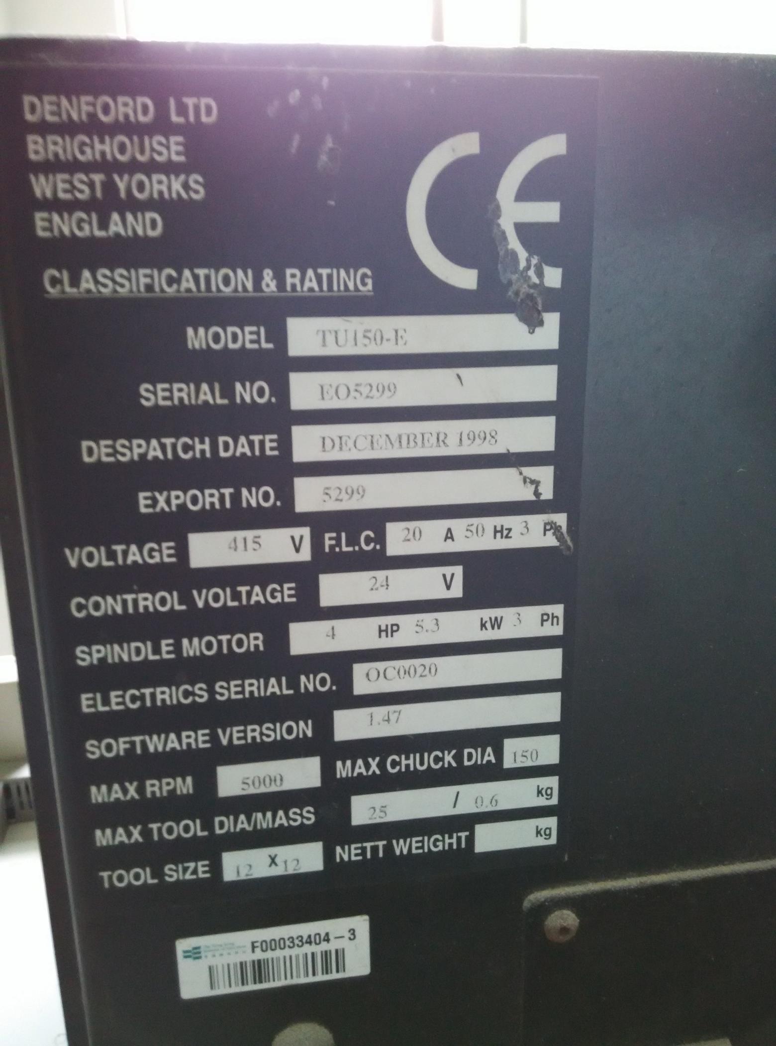

I see you have the serial number EO5299, I have the same machine with serial number EO5266 manufactured in November. Small world I guess. Mike

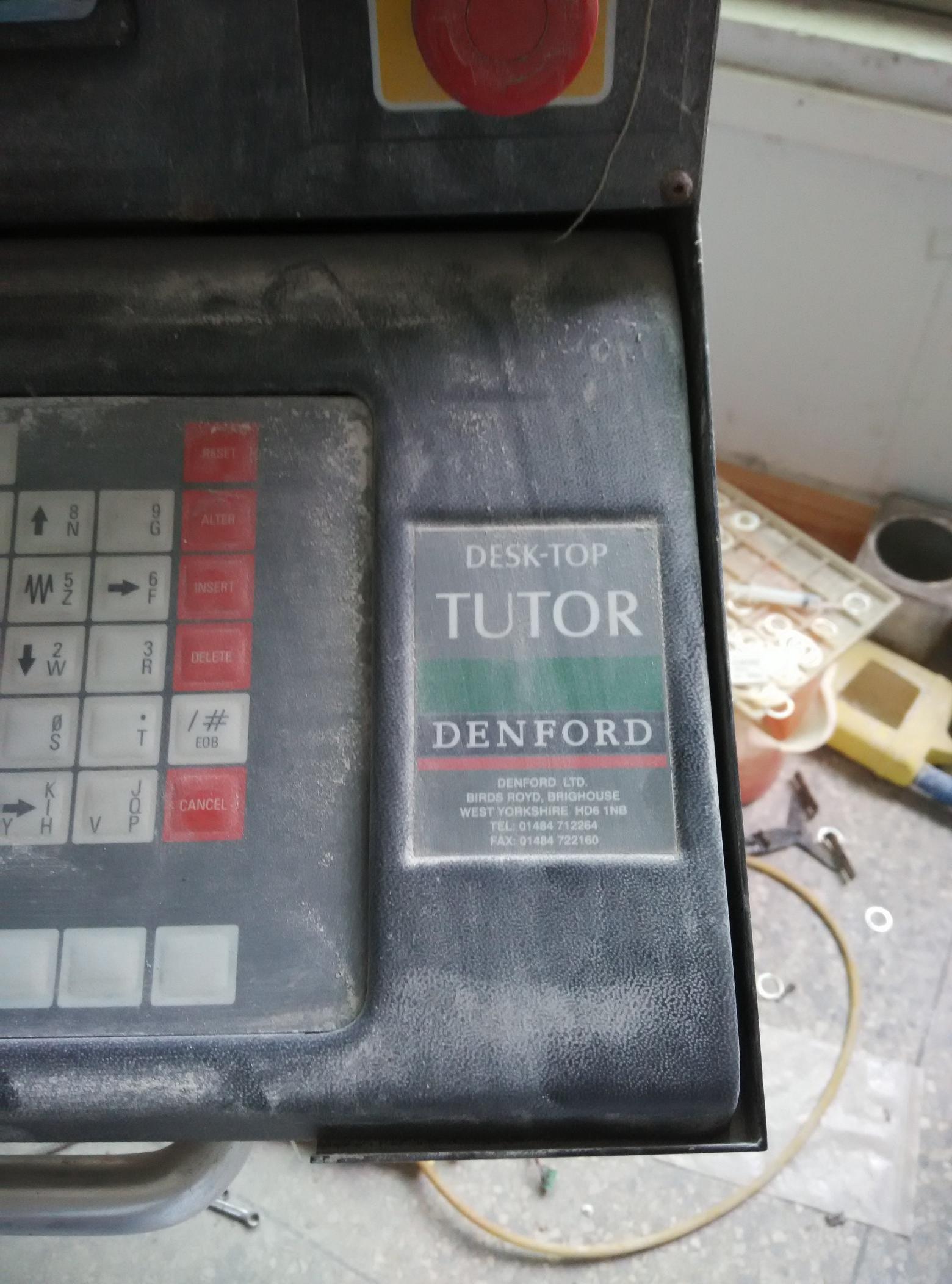

I have created DOS on harddriver and boot ,decompress "drivers2" and "flstep" to C:\denford .Which drivers in "drivers2" do i need to
load for the motion card(link to com3) , and keypad on desk-top TUTRO (link to com2), what should be add into "autoexec.bat"?
