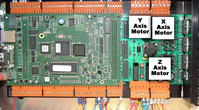

The two motors in the top right of the card are the Y and X (X at the end)
The one at the bottom of the card is the Z.
Some machines may be different but I think this is correct.
The Plugs also have black pegs fitted to prevent positioning in the wrong place, you may need to pop these out to allow you to switch over the plugs.
Make sure the power is off when you disconnect the plugs. Yo do not have to plug all the motors in to run the card so you could try disconnecting one at a time to confirm which is which.

See picture below
Where to find the nextstep board motor connectors. NB, this has a NextMove top card (Green seven segment display)

Many thanks for your help, Steve, have swopped motor board connectors and the stepper motor runs sweetly, I presume it is the board. By the way it follows the configuration of the board in your picture but has a red 7 seg display!? Can you tell me how to get the board repaired. Many thanks, Martin Field
