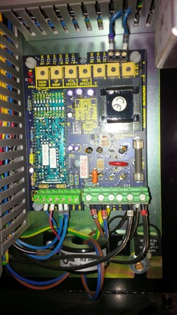

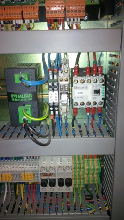

I cant see any ribbon cable and I am not sure what an IDC plug is. I have checked every plug visible to me to sure it is secure and I didn't find any not attached/inserted loosely. I took some photos of the inside to let you see what I have. Thanks for your help.

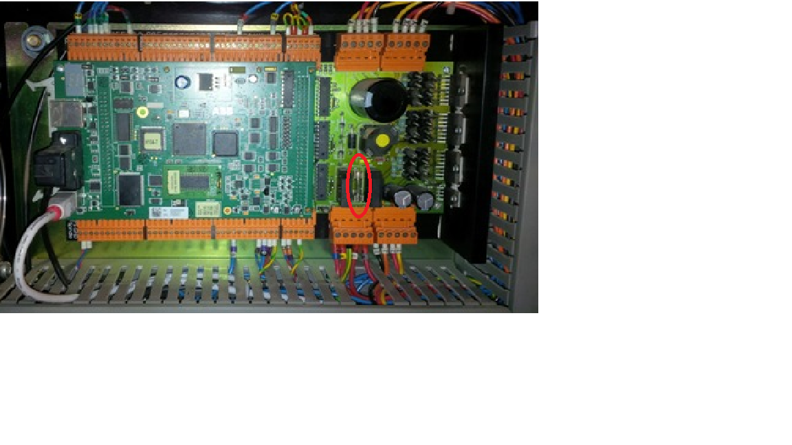

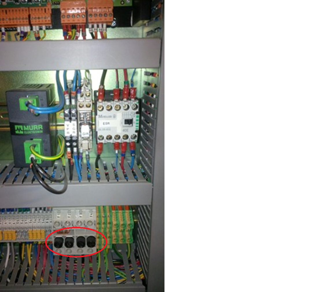

Re: V3 not working since upgrade
Check the fuses as shown.
Just checked the fuses. The fuse on the top board is blown! Hopefully replacing it will cure all the problems ok.

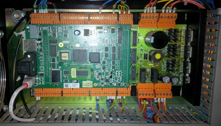

Hi Martin
The fuse in the top photo is the one that has blown. The technician in the workshop door has checked everything and reckons the two bridge rectifiers on either side of it could be on their way out. He is away till Friday and has asked if I can take the board out in order for him to replace them. Does this sound right to you or could there be something else wrong instead?

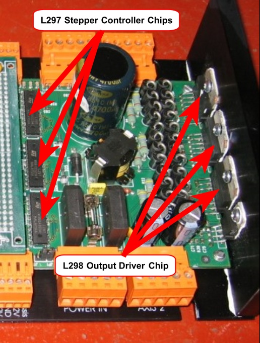

It would be very unlikely for the rectifiers to be the problem.
Most likely one of the stepper driver chips.
Have you done anything with the machine itself? To damage a chip it would take a short circuit from one of the motor wires to ground.
Check the 3 L297 and L298 chips for damage. These drive each axis. If any axis is shorting to ground then these chips will be damaged. You could test by measuring from each motor wire to earth to see if there is a problem.

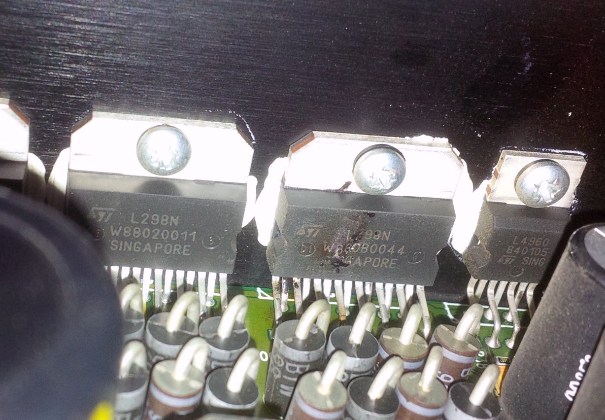

We have checked the boards and the bottom L298 is knackered as can be seen on the photo. We havent had the board out to check if anything else is blown or whether this has caused the fuse to blow. Dont know if one component can stop all the steppers from working.
