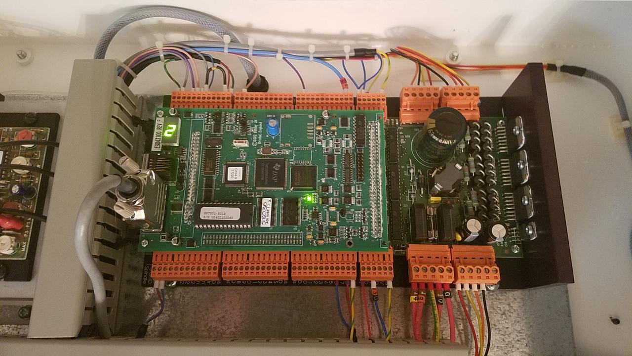

I got the cover off and powered it up.
The front door interlock seems to be engaged also. Having read the manual, I will pop off the bottom cover and release it manually for now.

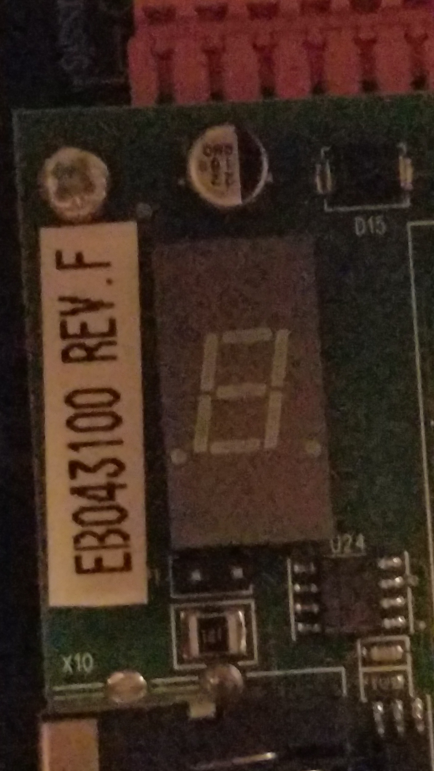

There is a label beside the Segment LED.
EB043100 Rev. F
The seven segment display is GREEN.
When I power it up this is what happens on the display.
1. It shows a Solid 8
2. Then the Middle Horizontal segment lights solid with the Dot Flashing
3. Finally it It displays a SOLID 2 (Not Flashing). The dot at the lower right of the segment display is NOT ILLUMINATED
This is everything I know at the moment.

Not aware of a trial version. As for the sequence on the LED display. Ill flip the panel off ours in work tomorrow and fire it up. Ours is the Microrouter Pro but I think the board is the same.
I found this if it helps. Someone was having issues with a machine
"Does your board have a USB communication port?
You may need to try and connect the card to the computer to get the display to read correctly.
Where did the new card come from? What machine was it previously fitted in as it may need to have firmware updated
What colour is the 7 segment display? If its Red then its a Denstep control Card. If Green or yellow a nextstep.
stuff/NextStepLEDSWEB.htm
viewtopic.php?f=54&t=3167&p=16305&hilit ... ent#p16305"
Do you have the 23 way RS232 connector on the side of the cabinet or the USB? If the RS232 you may find it has a USB on the board just below the LED display.
You really need someone like Martin to come along and comment on that side.

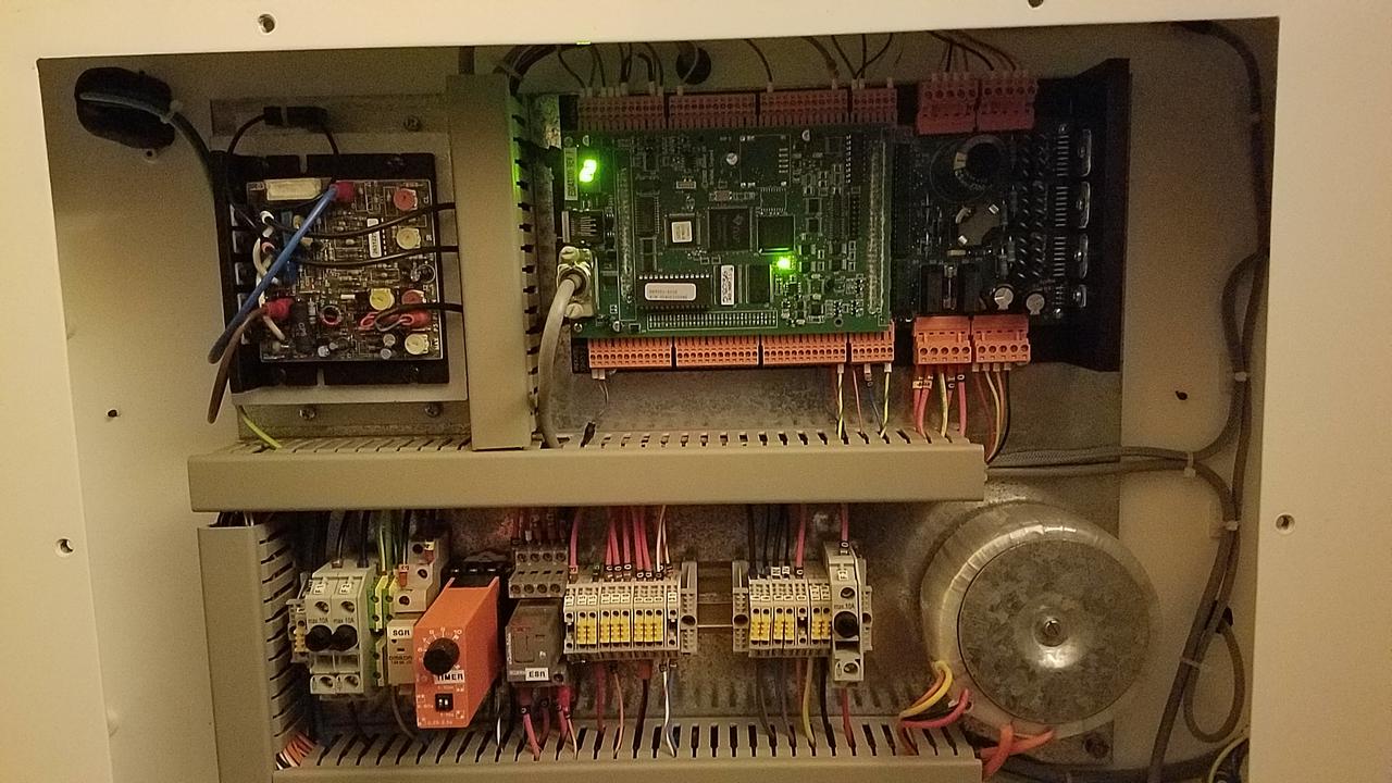

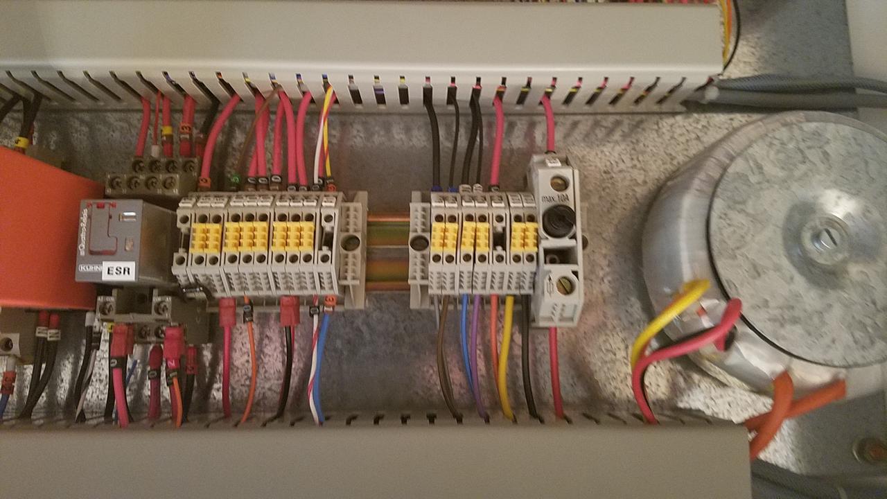

Here are a few pictures of the Cabinet, just so you can be clear about what I have.

I have been studying the cabinet and comparing it to the wiring diagrams.
Where I can I am checking for voltages to get a sense of everything being as it should.

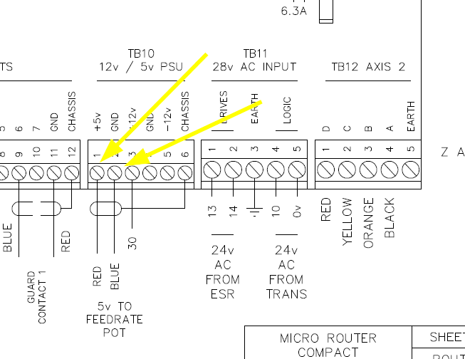

I noticed this.
On the TB10 block, The wires for the 5V Speed Pot are not where the drawing says they should be.
Please see the two pictures below. The snippet from the wiring diagram came from the diagrams linked here on the forum.

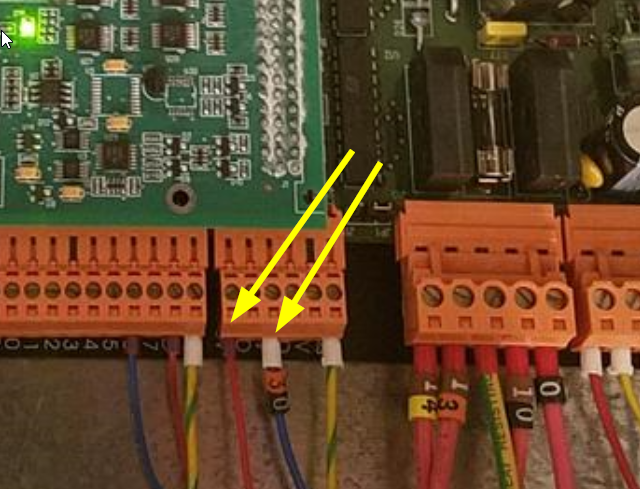

On the TB11 block, the 24V AC wires for the ESR Relay are reversed on the board from the wiring diagram too. I am not sure if this matters or not.
Does yours match the drawing of the Cabinet?

looking at the section on the wiring. its not that the wire is in the wrong place, the blue wire has 30 tagged on it as per the diagram. it looks more like the gnd wire to the speed pot has not been fitted back to the board. it may well be that the gnd has been picked up off another point. it would be worth looking at the pot itself to confirm this.
you have the rs232 version so you will need with an rs232 port, for the wiring of the lead

TDIPower wrote:looking at the section on the wiring. its not that the wire is in the wrong place, the blue wire has 30 tagged on it as per the diagram. it looks more like the gnd wire to the speed pot has not been fitted back to the board. it may well be that the gnd has been picked up off another point. it would be worth looking at the pot itself to confirm this.
You know, I was thinking the same thing after the fact. Out of curiosity I checked the voltage at the pot itself and I have the 5V. I will call that good then.

Re the no 2 on the display, did you not take a look at this link? stuff/NextStepLEDSWEB.htm
depending on when No2 is on the display it can mean 1 of 3 things. Given yours is on the display whilst powered up it looks to me that it is normal.
