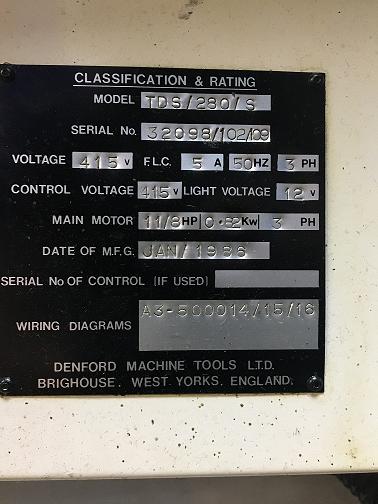

I have recently purchased this 280 synchro. It has developed this issue of the contactor vibrating on and off. I have identified a small relay on the board that seems to control the main contactor in the control box, that seems to be alternating on and off. I have taken its cover off, forced it on and everything works fine but unfortunately it doesn't stay on! I have taken a picture of the label on the control box. I have had a look on the forum but I have not been able to find the right wiring diagram for my lathe so I wonder if anyone is able to provide one or help with this problem.

No, the machine is on 3 phase. I have now taken the control board out. The markings on it are : PC0469 GSM Ltd 1976

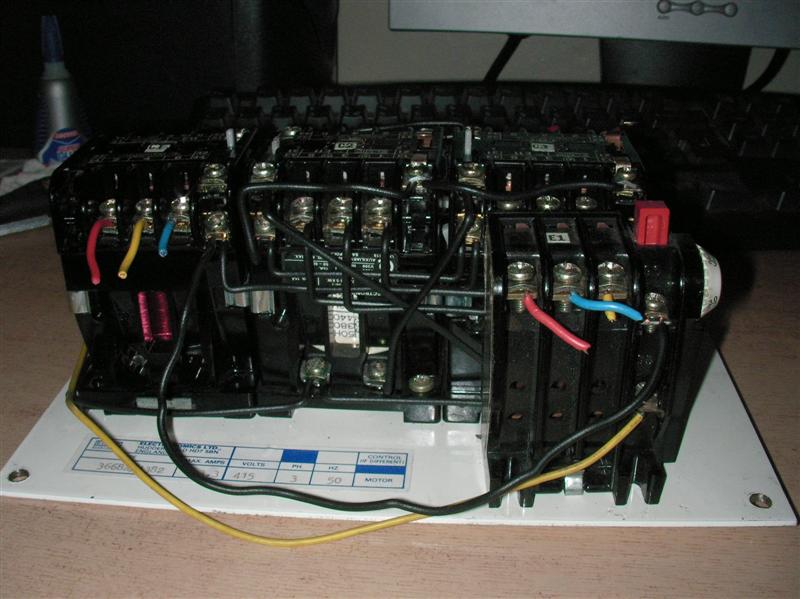

I just noticed you said a relay controls the contactors, Mine didn't have any relays the buttons acted directly on the contactors themselves. Here is what I had in my Synchro.

The contractors you picture are not the ones I have an issue with. There is another control box under the bed which has a pcb with 4 relays on it ( one of these is the issue), two transformers and two contractors.
