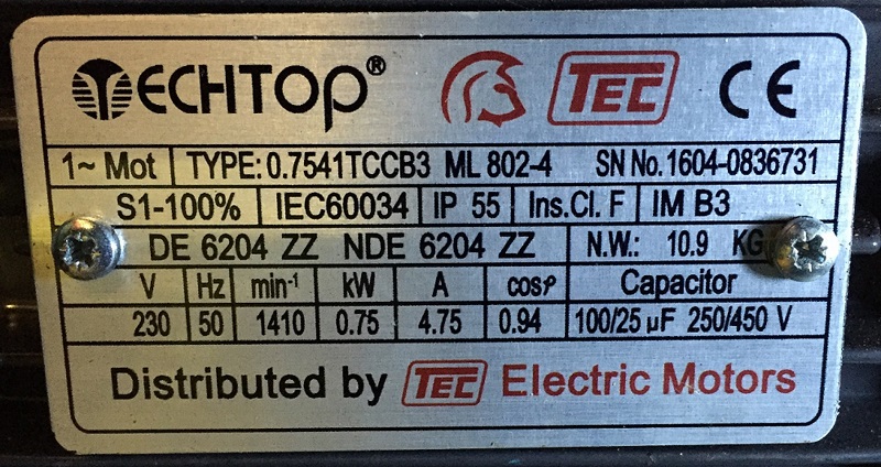

FYI this is the name plate of the motor, don't know if it gives any clues!
Thanks again!
Alex

Hi Alex,
1) Where there is a chance that a motor could be stalled in service a type of motor called an "impedance protected " motor is used. This just has a greater amount of iron in its construction so that the core does not become saturated magnetically, even when the motor is not turning. The little synchron motors found in CH spring return zone valves are like this. They just run open until they stall, when the power goes off they run closed. Mining belt conveyor motors used to be like this as well, but are now protected electronically I think.
2) Yes, load changes affect the motor temperature. Traction motors often have separate blowers to cool them when under heavy load. Sometimes the wrong kind of snow blocks up the cooling passages.
3) Yes, the wrong/faulty capacitor can cause a problem or prevent the motor from starting at all.
One thing you could check is that the speed switch is working properly, if it was jammed it could keep the start capacitor in circuit, this would not be good and might produce overheating symptoms.
I'm not a motor expert but google is your friend, there is a lot of information available.
