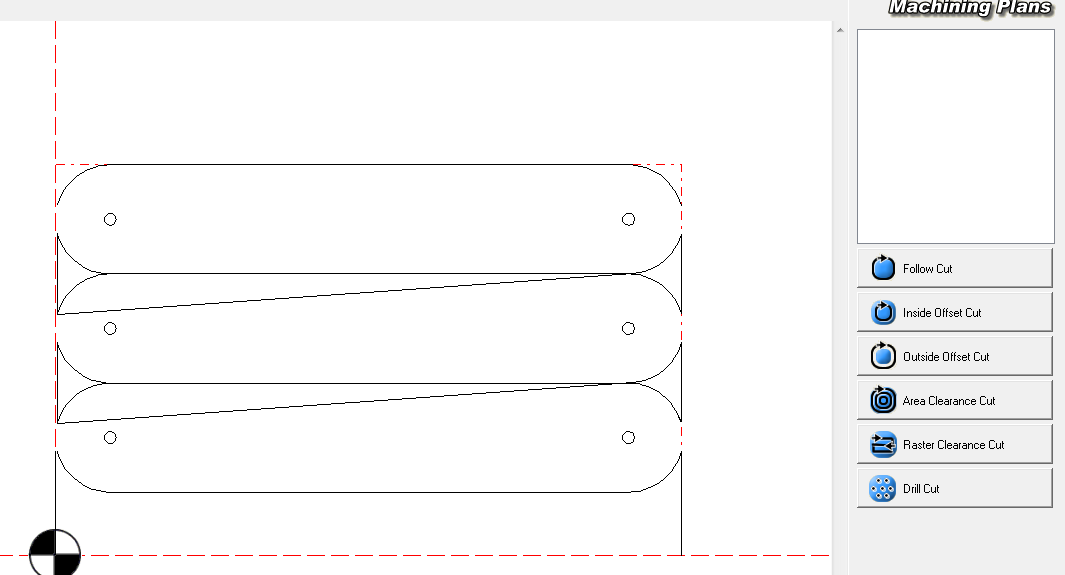

Hello, I am generating a toolpath using a DXF straight into VRMilling. However, when I switch from screen 1 to screen 2 some extra lines are added which we do not want to cut! Can you help us? (Please view attached images; the second screen is above the first screen)
Thanks.
Denford Novamill
VRMilling version 5.63.0.680
Windows 7 Pro
When we go to the second screen we get these extra lines :(
screen 2.PNG (31.3 KiB) Viewed 18531 times
First screen, with required toolpath...
screen 1.PNG (24.37 KiB) Viewed 18531 times

The problem is that the design drawing is incorrect and the vector is not closed so the software closes it automatically Check your design and make sure there are no overlapping lines. Select all the lines and join them together.
