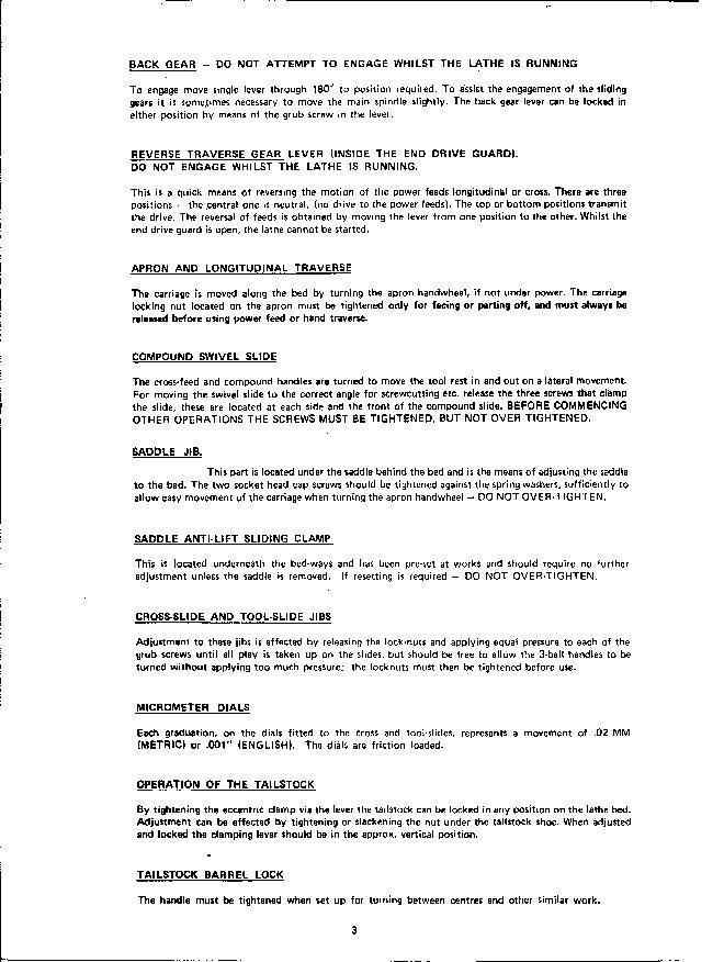

You reverse the leadscrew drive using the tumbler gear, under the end cover.
(See pictures- Note-not my lathe)
If it only goes in one direction it might be because there is a problem with the drive train.
I think a pin can shear in such a way that it transmits the drive,but only in one direction.
Viceroy manual.jpg (106.3 KiB) Viewed 10542 times
