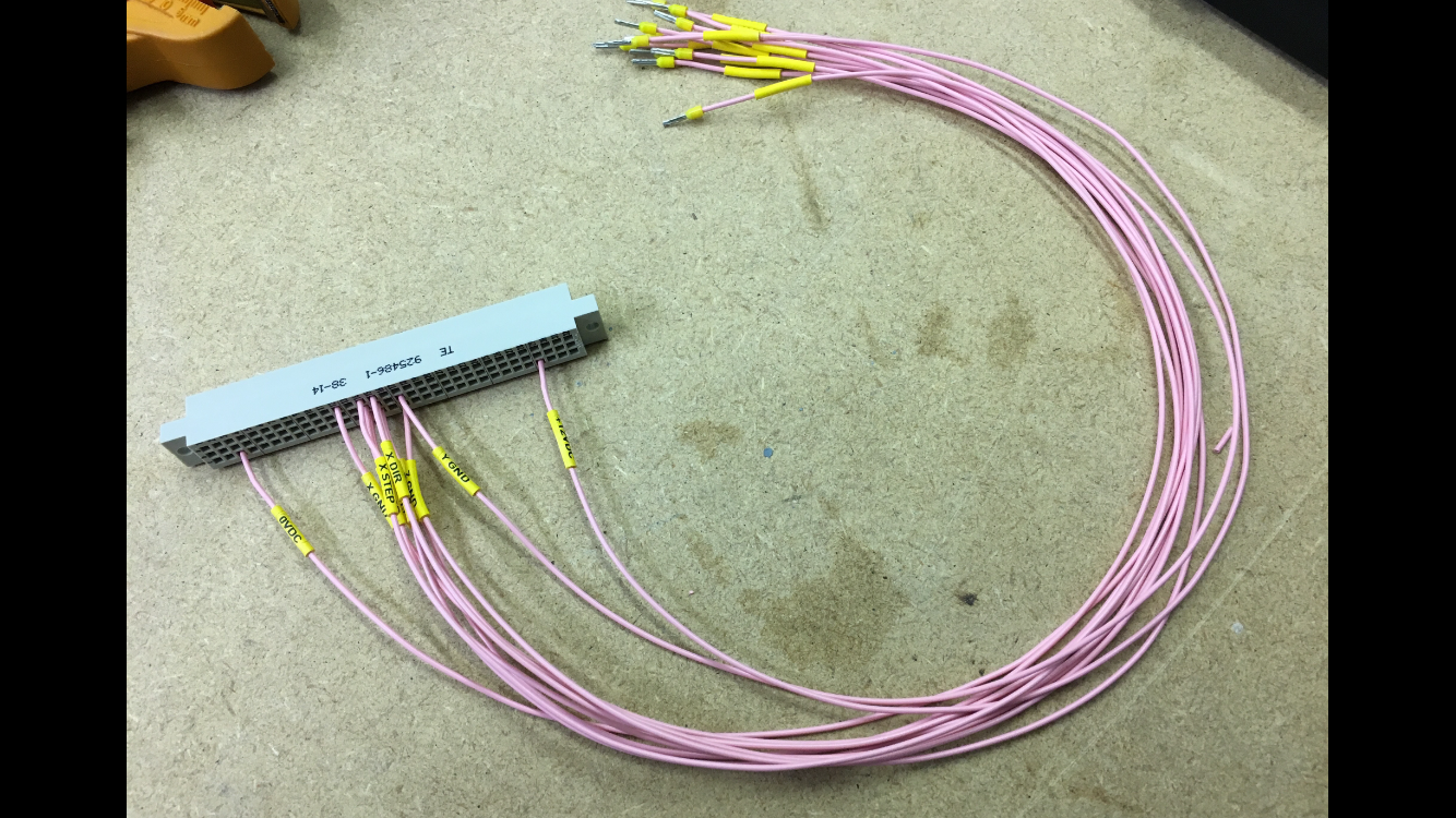

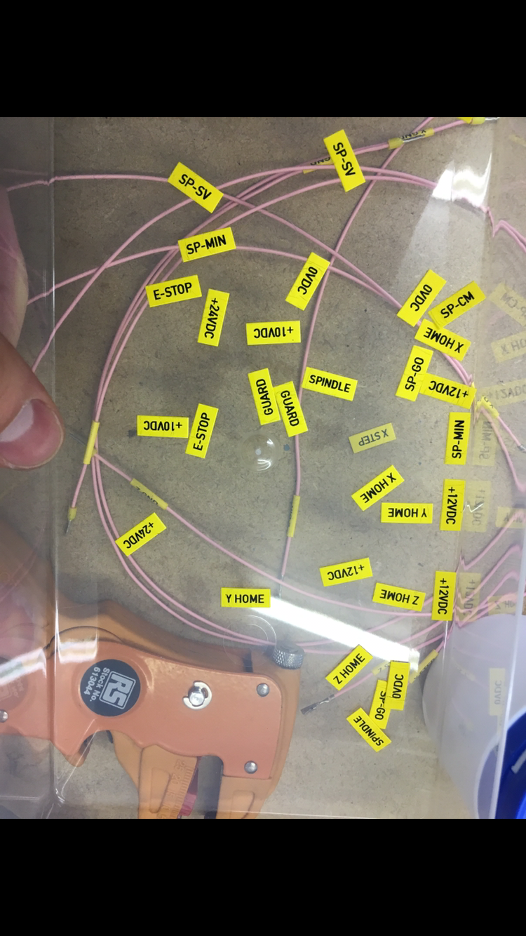

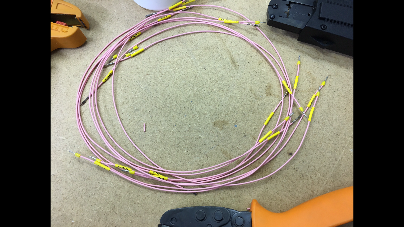

New cable loom to plug into the Eurocard 96-way plug.
TE connector housing with TE crimped connectors. Printed heatshrink (yup, have the machine for that) and will be using mesh wrap once the loom is complete.

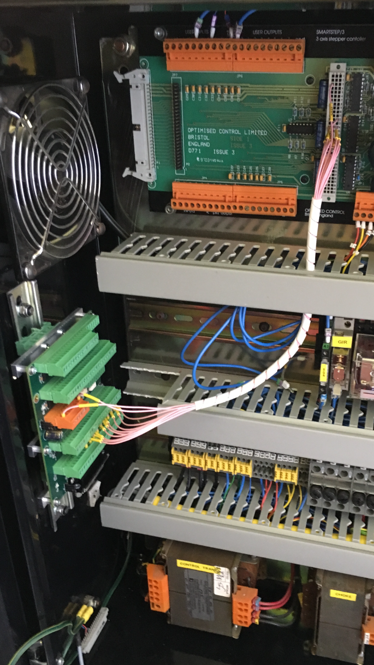

So, wiring loom fitted...
One snag, I found the 96-way plug on the Baldor had badly soldered pins so the connector wouldn't go on; some pins higher than others and some at angles. I ended up removing the board and heat sink and removing the board from the heat sink to straighten and get even pressure behind the PCB to avoid damaging the solder joints or PCB itself. Connector went on easily enough...
All hooked up, with the MESA 7i76 stepper I/O board fitted to DIN rail mounted in the position the original spindle isolator board was located. The 7i76 features and opto-isolated 10V analogue output, so no intermediary board is needed; making space and reducing complexity.

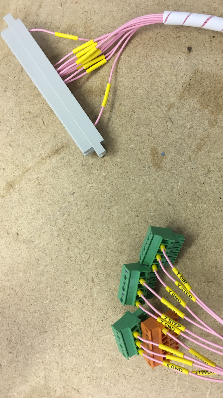

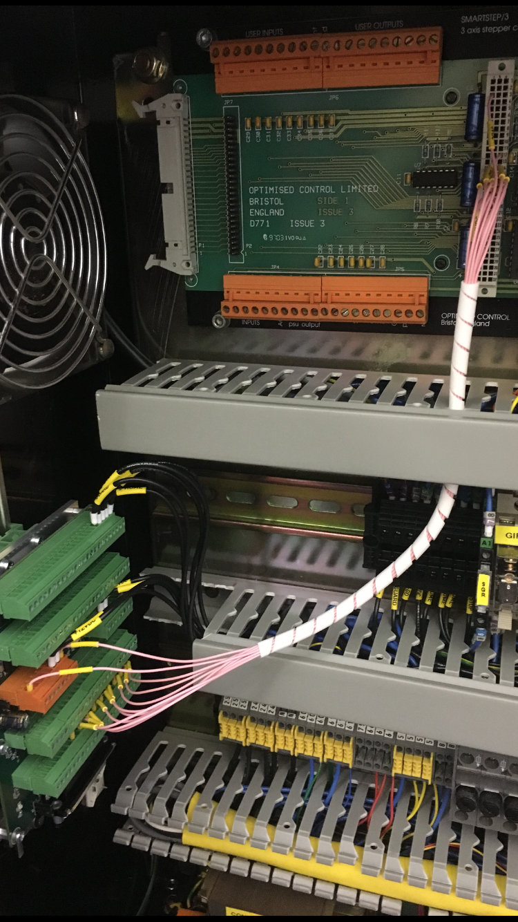

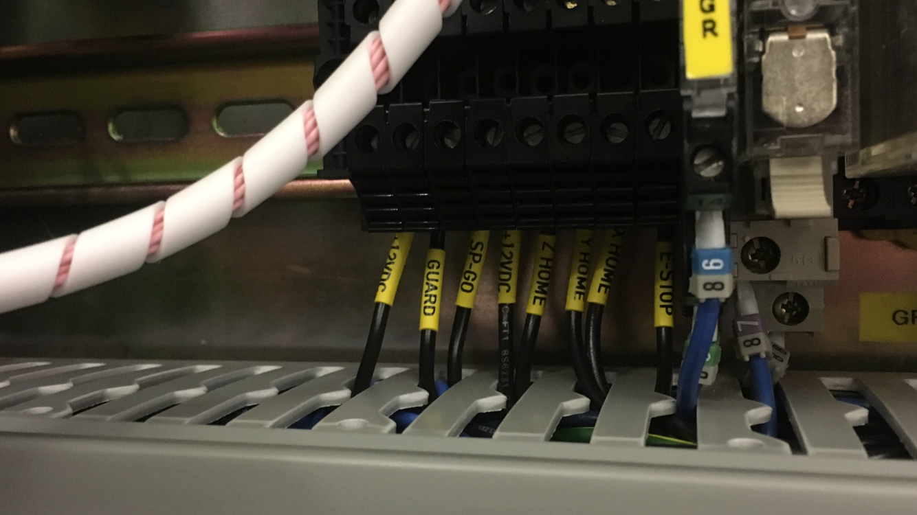

New block of terminals to terminate the home limits, e-stop and guard loops. All seems well, but this X axis limit issue is persistent.
I traced the length of the X home limit wiring and tested continuity at every stage, without any issues. It seems to only flake out when the panel is powered, indicating maybe severe noise or damage somewhere. The switch is open all the time; when powered off, continuity tests show the switch and wiring to work. Bizzare.
I've got to run a 3-core shielded cable for the analogue spindle control, and then I'm done in the "direct" conversion.
Playing with some controls, I'm not entirely happy with the quality of feedback from the interlocks. At present there's no feedback for the spindle, so if the guard is opened whilst there's feedback for that, LinuxCNC won't actually know if the spindle is rotating or not. Since opening the guard kills power to the spindle, LinuxCNC will need that logic to automatically pause the operation, which I don't entirely like, as the lag may cause issues. Would much rather the guard be soft interlocked, so LinuxCNC stops the motor, vs power being cut. Handy so chips etc can be blown away without having to worry about pausing the program (the guard will initiate pause which in turn stops the motor vs the guard killing the motor and LinuxCNC only knowing "because" the guard is open). Or maybe that's dumb. Either way, current logic will prevail. The MESA has lots and lots of IO, so I'll be hooking up a touch probe and a tool setting probe, tool release valve (for power drawbar conversion), maybe even a multicolour beacon for visual status of the machine. Also want mist coolant (I think flood is pushing it - how can I drain it without coolant getting under the machine or through the chip covers and have it flowing out the rear pulley cover?).
Anyway, all working sans X axis. May have to run a fresh X home shielded cable if it's damage or noise.
