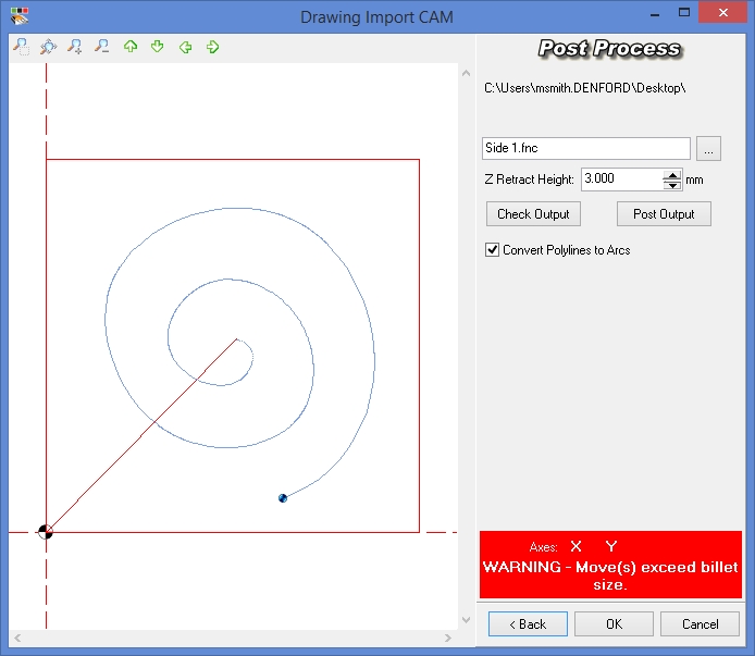

i am trying to cut a simple spiral from a bezier curve. although vr milling shows the correct path when selected the outcome is nothing like the original. see attached pics
Any ideas?

Hi. When the DXF file is imported into the latest version, 5.64, the output path appears to be followed correctly.
This is produced using a single 'Follow Cut' path. Can you try the latest software version please?
