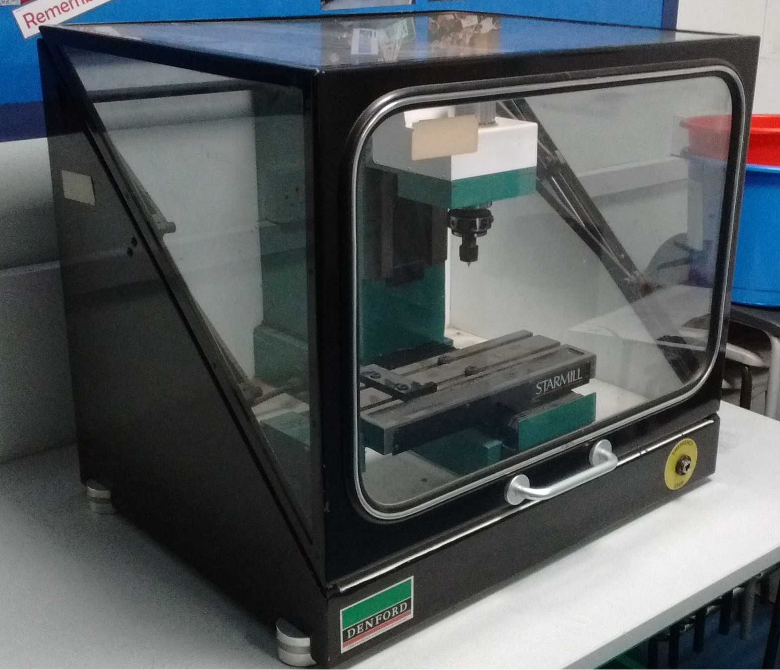

Hi, long story reasonably short I am an A level student and my school has an old Starmill CNC milling machine which has been sat on a table for the best part of a decade. (Picture attached)
My question is first does anyone know the pin out for the connector shown in my second attached picture? It is seperated into two connectors, the top of which I would assume is for power seen as it only has 4 pins? Again I would assume it is for GND, +12v -12V and +5v? But I have seen some mentions to 24v on some circuit diagrams I found.
My second question is f I could make a cable to get this machine to function what would it run on? DOS? BBC maybe? And where could I download the software? :mrgreen:
Sorry about the terrible quality but this is the connector on the back of the machine.

Re: Starmill Setup Help
Jimmy,
Welcome to the forum.
It would be useful to know what control your machine has. If you don't know this, then a serial number and photo of the control card can be useful.
Have you had a good look through the 'Starmill' section under 'Machines'?
There have been several threads previously about connection cables and pin-outs.
The plugs you have shown should plug in to the electrical control box. Have a look around for it. It should say STARMILL on the front & have a serial plate on the side showing the software version. Without the box you will not be able to do much.

Ahhhhh, this makes a bit more sense, I managed to find the desktop tutor box and I thought there must be some part I'm missing, i'll go have a hunt around the department for this but I don't know if it was supplied with the unit, I would imagine these by themselves are quite expensive?

Thank you for your responses, I managed to find this box and with the help of one of the technicians moved it to where the mill is, tomorrow I will hopefully have time to try and clean out the unit and see if it will run :D
