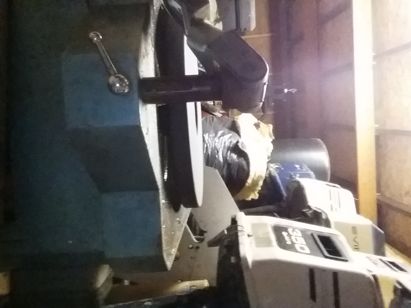

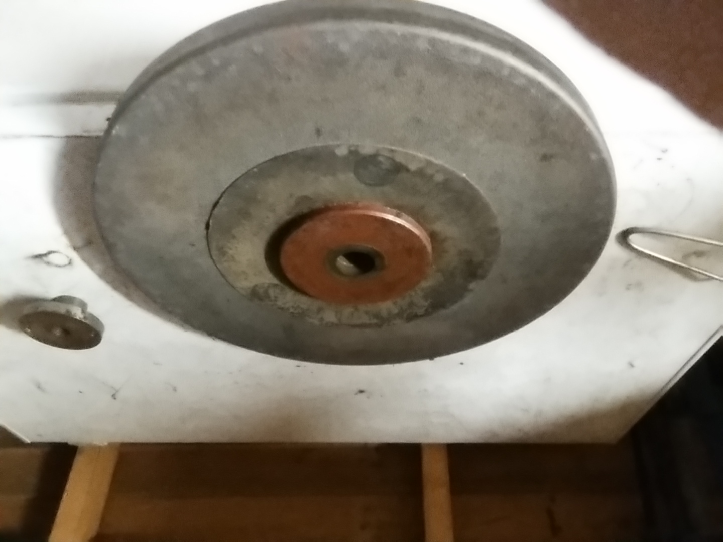

Photos of viceroy sharpedge
Gearbox
Gearbox
Gearbox
Gearbox
Well
Well
Wheel
Wheel
Wheel
Wheel
Wheel
Wheel
Re: Viceroy sharpedge problems
A picture is worth a thousand words!
Comparing the photo of your bearing mount to the drawing, it looks to me as though someone has replaced the bearing mount with a home-made one at some point.
With that great big block on top, it is no wonder the wheel is sitting so high.
I can't quite imagine how the original could get so damaged that it would need replacing like that ...
If you want to try to build one back to original dimensions, I might be able to find the detail drawings (if they are not already in the scanned files).

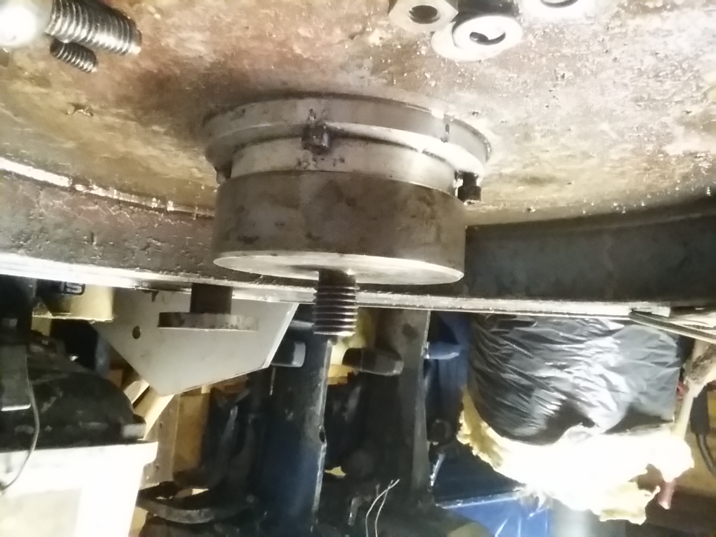

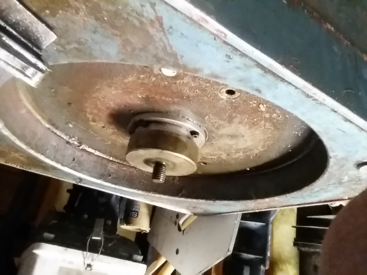

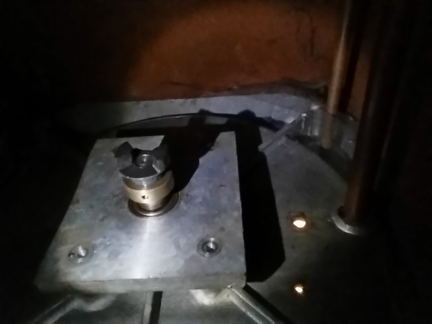

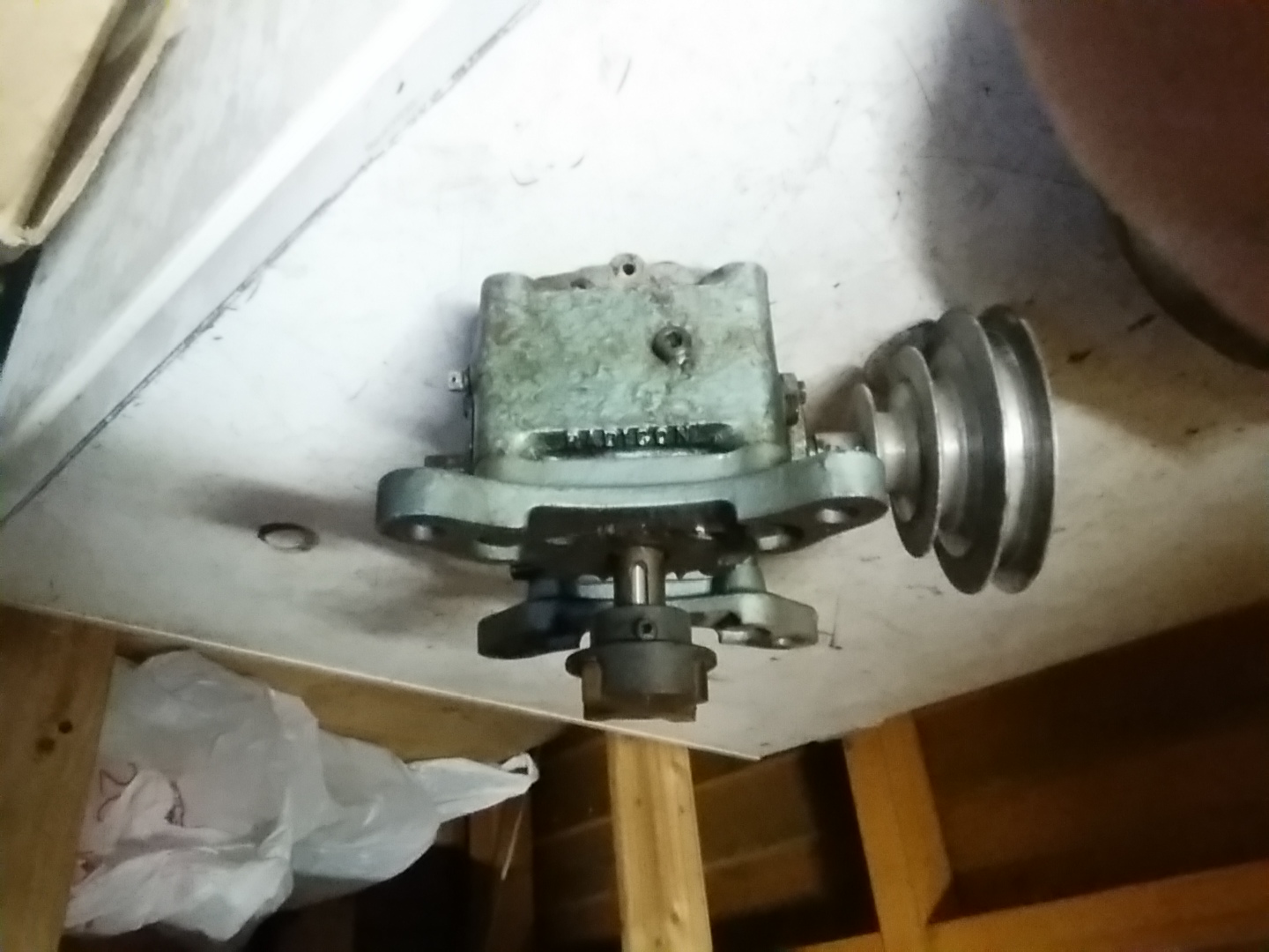

I'm having a few problems stripping it so far I have took the wheel off and dropped the gearbox but a bit stuck from there the part at the bottom of the shaft had a grub screw in it I have removed that but all it does is spin the brass looking part above it also had a grub screw in it and that seems to be on a thread but only winds up and down a couple of mm the big disc on top just spins and the aluminium plate is held on by four bolts that I can't unscrew and even if I could they would not come out all the way because the disc on top needs to come off first
Any idea how I remove the part at the bottom because I feel as though if I remove that then all the rest would follow

Photos
My first guess would be that the grubscrews have made burrs on the shaft (if no flat was machined onto the shaft) and those burrs are stopping the parts from sliding off.
Do you have a gear puller?
If you don't, maybe make 2 pairs of wedges if you have some hardwood offcuts and use a couple of G clamps to pull them in?
I assume you're having to work upside-down in the cabinet, so you can't see much or get both arms in easily?

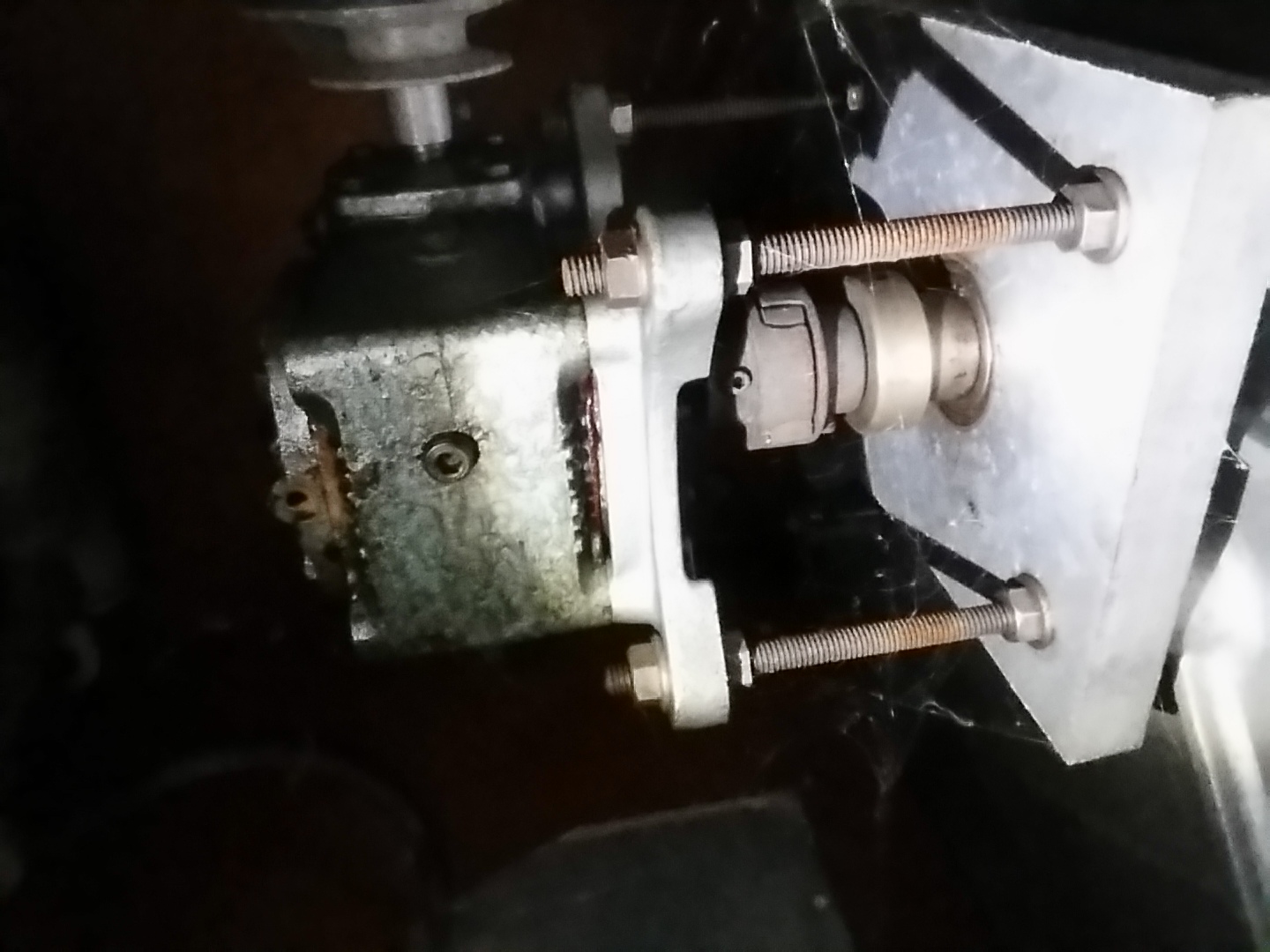

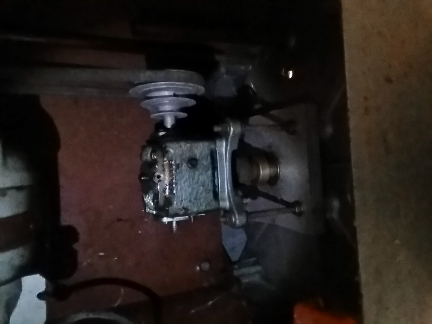

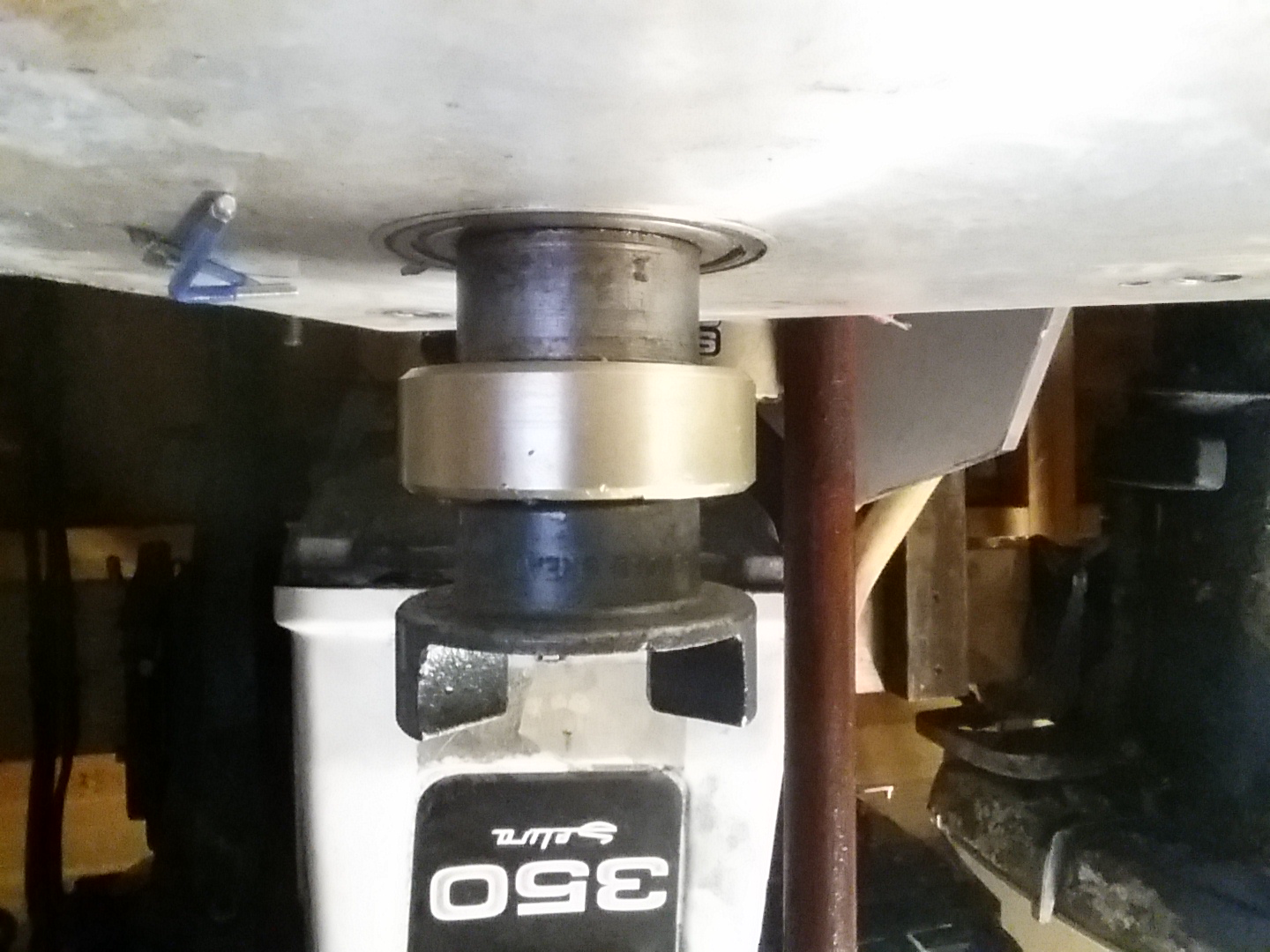

This is the part I am struggling to get off
I would check that you haven't got a grub screw locking a grub screw in that coupling, ie have you removed one grub but there is still one in there. I ran into that the first time on a Bridgeport mill and only realised it when I had pulled the pulley off with a puller and saw the damage to the shaft and had a look and saw the remaining grub screw. No big deal as no real damage done but a learning experience.
My experience with a Sharpedge is with one that got converted to a flat lap for grinding glass. From the information here it was an early one with a Radicon gearbox but no flexible coupling, it lacked the intermediate plate on the underside of the upper tray casting and instead the Radicon gearbox was fitted to the underside of the upper tray directly with 4 bolts and the wheel shaft fitted directly to the gearbox shaft with a couple of grub screws. It had been badly maintained and not cleaned so the lap silicon carbide grit had gotten into the oilite bearing and then the gearbox, the bearings were trashed but the gears OK and replacement bearings sorted it along with a new upper boss and oilite and a new shaft. Interesting to see the details mentioned here as I used some 32mm chromed ground bar I had for the shaft and a matching oilite and that is very near the 1.25" mentioned in the drawings
Regarding a lower tank that is likely the oil tank which the upper tray will drain into. IIRC the motor shaft should have an eccentric on it which drives a lever type fuel pump as used on cars of old to feed oil back up to the stone, I think the vertical drain tube was partly shown in one of your earlier photos.

Thanks David I don't think there is another grub screw in there because it seems to spin quite free like it is on its own bearing buy it won't pull off but I will check tomorrow when I get home from work I'm just hoping after getting it all apart that I can figure out what parts are needed and hope I can get hold of them
Just had a look and there is definitely no grumpy screw holding it on so I think next step is to get a puller and try that
