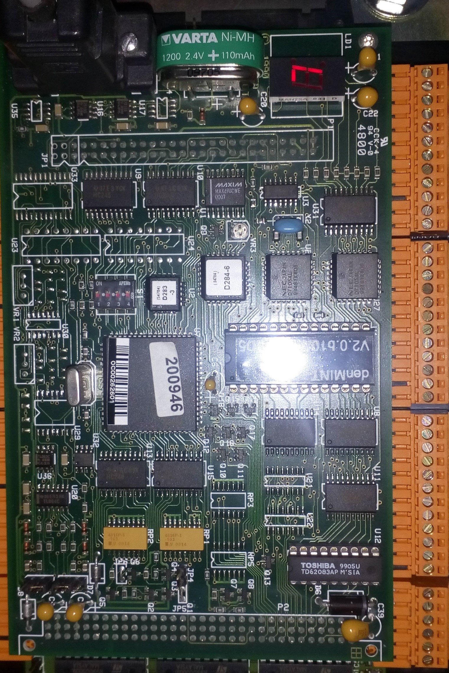

Yes. If you can open the black box & take a photo of the card on the top left it should help as well as the serial plate.

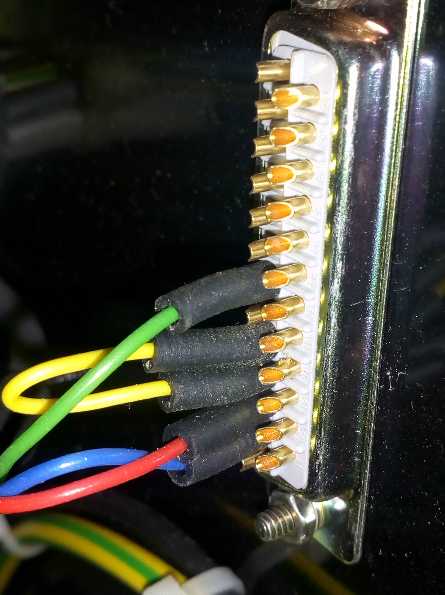

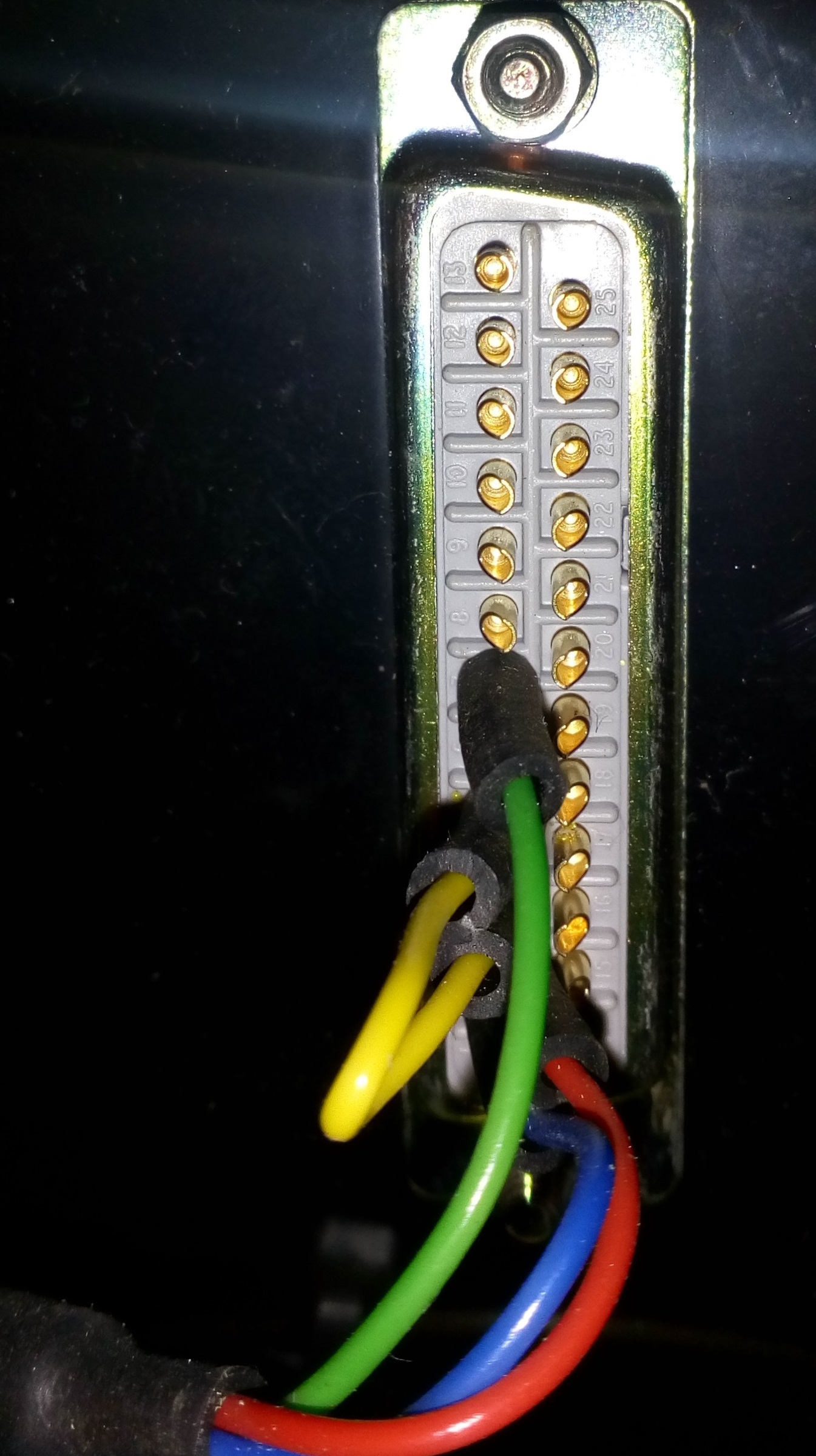

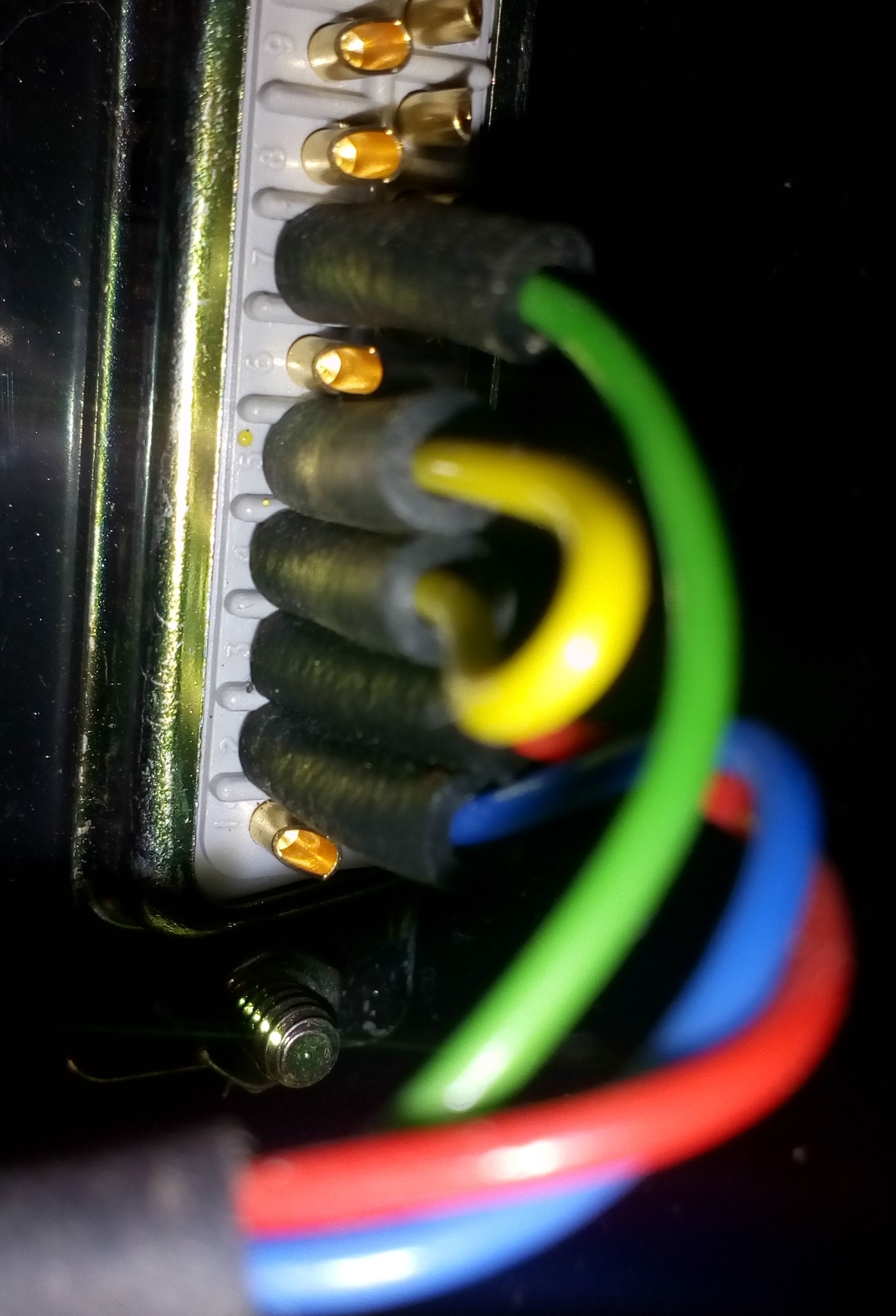

hi all,
I'm still having trouble connecting my machine.
I was given a diagram of a pin configuration which i used but isn't working. I have since opened up the big black box to have a look.
The attached pictures are what i have found.
Can someone please tell me what the make up of the rs232 cable should be based on my wires going to the port in the big black box, Only pins 2,3,4,5, and 7 are used, of which 4 and 5 are a little wire loop?
Any help would be great
Re: Microrouter connection problems
You say you have a 25-25 way, looking at your info you say win7, Looking on the back of the DELL computer what colour and sex is the 25 connector you are trying to use (if it is purple and female sockets it is the parallel port!)? Is there a 9 way D type (green and with male PINS) that is the serial. I have a feeling that the 25way you are trying to plug into is actually the parallel and NOT the serial. I haven't seen a 25way serial port on a PC since the mid 90's (a PC of that age wouldn't run Win7)
The communication between the PC and Microrouter is only done on 3 wires, TX, RX and Ground (pin 2, pin3 and Ground on Pin7 in your photo) the loop back pins 4 & 5 is on the RTS/CTS request to send / clear to send and this is sometimes put in to the plug on the lead.
The easiest way to get it working would be to get a 9 pin connector to fit the PCs serial port, a 25 way to fit the 'black box' in the 9 way link pin 7 and 8 (replicating the loop back that has been set up in the microrouter). Link pin 5 on the 9way to pin 7 in the 25way (ground) Then link 9way pin 2 to 25way pin 3, and 9 way pin 3 to 25way pin 2.
The last part can sometimes be the issue as it all depends on how the 25way is wired in the microrouter. Basically you need to link the send from the PC to the receive on the Black box, and vice versa. So if the machine wont talk to the PC try swapping the wire so you are linking pin 2 to pin 2 and pin 3 to pin 3.
You also need to make sure the RS232 is set up on the PC, if the PC was working with the microrouter in the school then that should be fine. I have seen several issues with school setups, the PC gets replaced (not set up correctly) the person that knew how it all worked left, the lead get lost and staff are to busy to work it all out (don't know where to start). There is a page on here somewhere which gives the full cable pinouts, this cable has a lot more connected and plugs from the PC directly onto the control board if all else fails you should make one of those up that way you can focus on getting the PC setup correctly.
Hope that lot helps

When I wired up the RS232 cable, it was based on a diagram I had been given, i'm now looking for one of them based on what I have in the pic. Ideally i'm looking for someone to tell me what pin from the 9 female side needs to be linked to the 25 male side and where any loops, cross overs ect should take place. i.e.
