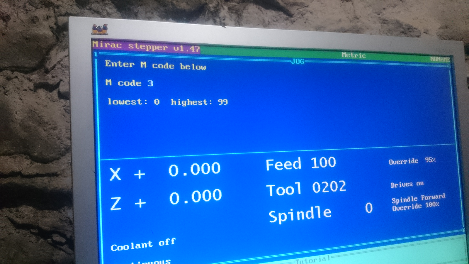

A screenshot of the problem...
The spindle is turning, and I've no speed on the display. Any ideas??

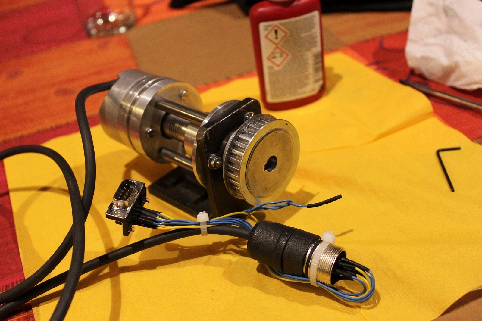

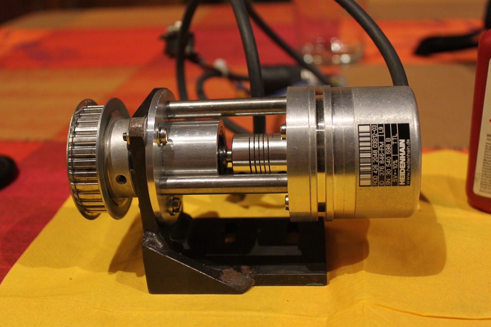

First, I've received my oscilloscope and it appears that I've broken the "british" encoder.....
So I bought a brand new HEIDENHAIN encode: ROD 426 2048 3S12
I tried it , putting the shaft in the chuck, and wiring directly to the eurostep board.
And it work fine!
I've turned/milled some parts at my job for adapting the encoder, the shaft is too short, and I don't want mechanicals stress on the encoder.
ROD426-ADAPTATOR
ROD426-ADAPTATOR
I connect it into the harting plug with a RS232 homemade adaptator.
ROD426-plug-adaptator
And It doesn't work.... :evil:
I plug it directly on the eurostep board, and it work!!!!!
I think there is something wrong into the harting wires...
In the future, I'll add a RS232 plugs between the lathe and the cabinet for the encoder wirings.
