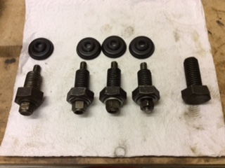

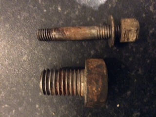

@Twoberth that is amazing information! I have been trying to figure this all out for ages! Would there be any chance of you posting some pictures to accompany your description? Specifically of the fixings attaching the lathe to the cabinet?
Many thanks,
Rob.
Re: Installing a TDS 1/1GB
Hello,
Attached photos.
I only inherited one levelling fixture, so I made the others by drilling out some bolts (5/8th WHIT) making the studs and buying the Dowty washers.
Hope this helps, Duncan
