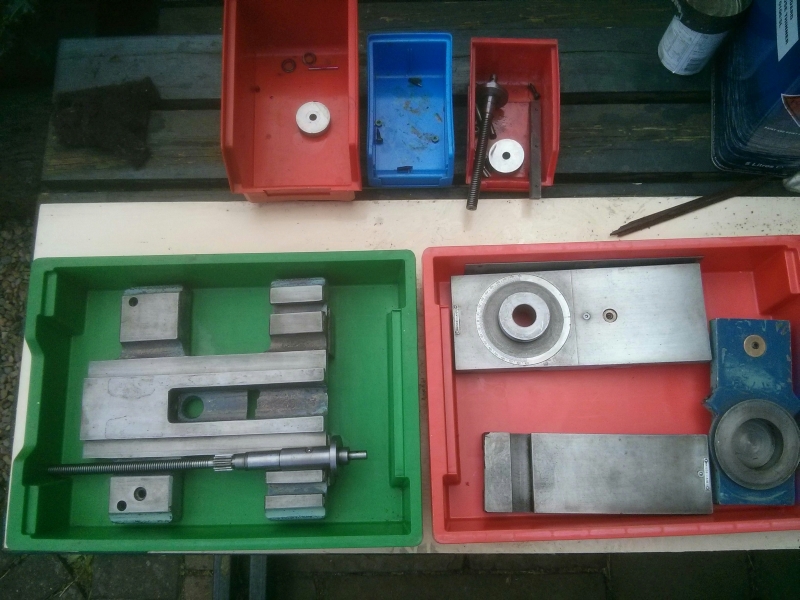

I'm now current custodian of a rather neglected, ex-school, Viceroy 280VS. It's needing a fair bit of TLC (and some spare parts).
I'm getting through the cleaning stage. She's mechanically sound underneath all the crud. Needs a rewire to take a VFD but I'm concentrating on the 'metal bits' first.

Things looking better after a lot of elbow grease.
