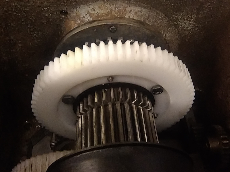

I stripped the top of the lathe today after draining the oil overnight . It seemed the more I looked the worse it looked , Oil covered glasses on I think on first look .
There seemed to be a tight spot on the shafts when spun by hand , as I inspected it,it seemed to get worse , The gear selector lever was getting tighter ..
I removed the shafts with very little effort seems the last man in there had a 5 year old tighten everything up .. Not a hint of grabbing on the way out really easy . decent size hammer and a bit of hardwood persuasion and spindle shaft came out nicely.

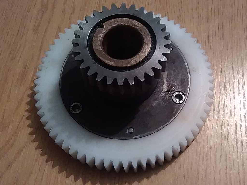

The lower plastic gear is in a sorry state , , At some point some fool tried changing gear with it running and took away several teeth edges on one side .. Then someone decided to turn the gear around ,
for some unknown reason the holes didnt match , so then the holes for retaining the gear were redrilled into slots . I kid you not . this left the gear eccentric of the shaft .. Thus causing the binding . Voila .

Don't be too hasty to condemn the holes as ham-fistedness. The original gear made from technyl 90 that came out of my machine also had ovalised holes and the register was also over-sized. I don't think the material is so well suited to long years of exposure to oil, or perhaps just not more modern oils than when the machine was new.
Turning the gear around should not be possible and have it fit right, the sides are not machined the same depth, though I guess it's possible to re-machine it to fit (which would go to explain the runout since the drawing shows one side a close fit and the other side a clearance).

Hi mine too has the transducer gear , if you mean the hall sensor pickup ?. Yes Pete the gear is really sloppy on fit , And when I say elongated holes you can see were he missed drilled it in 2 spots .. Absolute numpty who touched it . Is there a drawing relating to the plastic gears . I saw that the original size was revised on OD ? ( in another post) . I was expecting the retaining plate to fit better and at least some kind of centralised location for the gear to the shaft . On mine it's all over the place good 1.5 mm float all round . Thanks for the replys .

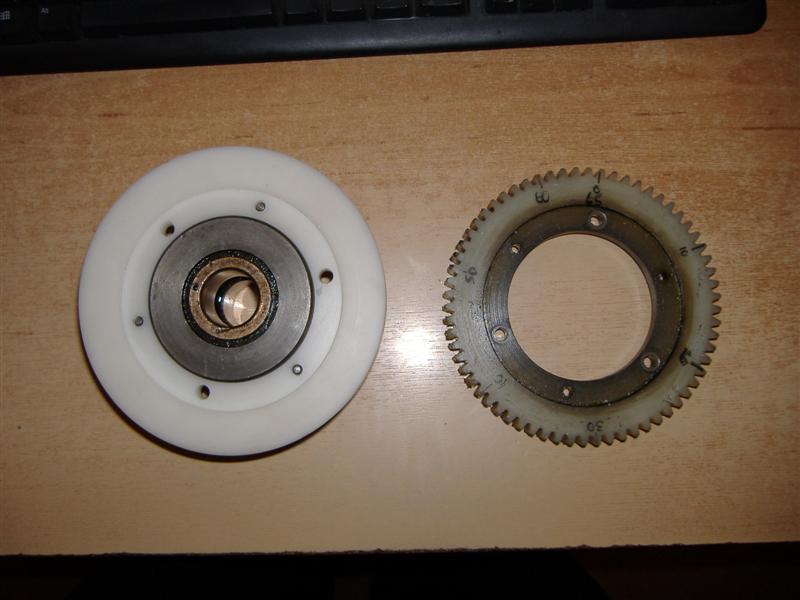

The drawing for the gears is attached here. The larger one on the spindle is 68t and the smaller but thicker one on the layshaft (the one which gets chewed up by changing gear in motion) is 65t. I've attached a picture of the last one I made, you can see it's a nice snug fit on the hub.

I've got a photocopy of a file note dated 15th December 1978 (must have got it off this site somewhere, just where I can't remember) which notes that the PCD of the layshaft gear is reduced from 5.417" to 5.397, and the OD from 5.583/5.579 to 5.563/5.559 'as advised by Green's of Sutton' because of the co efficient of linear expansion of Technyl 'A'90.
At the same time, the thickness of the gear was altered from a dimension of 7/8" to 0.875"/0.870." As a fractional dimension, the gear thickness could have ranged from 0.885" to 0.865", and I have read that some lathes did have issues with the gear binding in the shift fork.
The PCD and OD of the plastic spindle gear were reduced by 20 thou at the same time.
I checked the OD on my spindle gear, and it seems to be the original, larger size, but to date, I haven't had any binding issues.
Without dismantling, I can't get down to the layshaft gear to check that, but I presume thats the larger size too. I must be lucky, and mine are lower end of the tolerance range for OD and thickness.

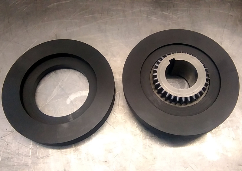

The gear was worn loose in every direction, the hub ID and the holes. I think the ID was at least 1/16" oversize. I machined the new blank for a good fit on the hub OD and the flange OD. This is the first one I made.
This is the 68T I made about 5 years ago, still looks pristine so we know that acetal is perfectly tolerant of running in hydralic oil.

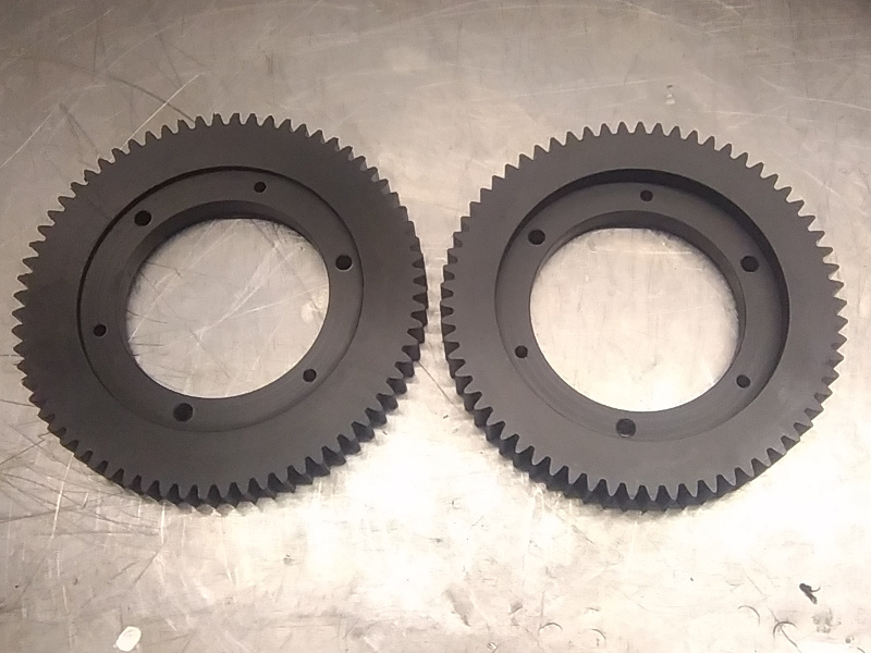

Yep, gear blanks are ready for gluing the teeth on tonight :lolol:
Soon as the glue is dry they'll be in the post :lolol: :lolol: :lolol:

Gears are done.
