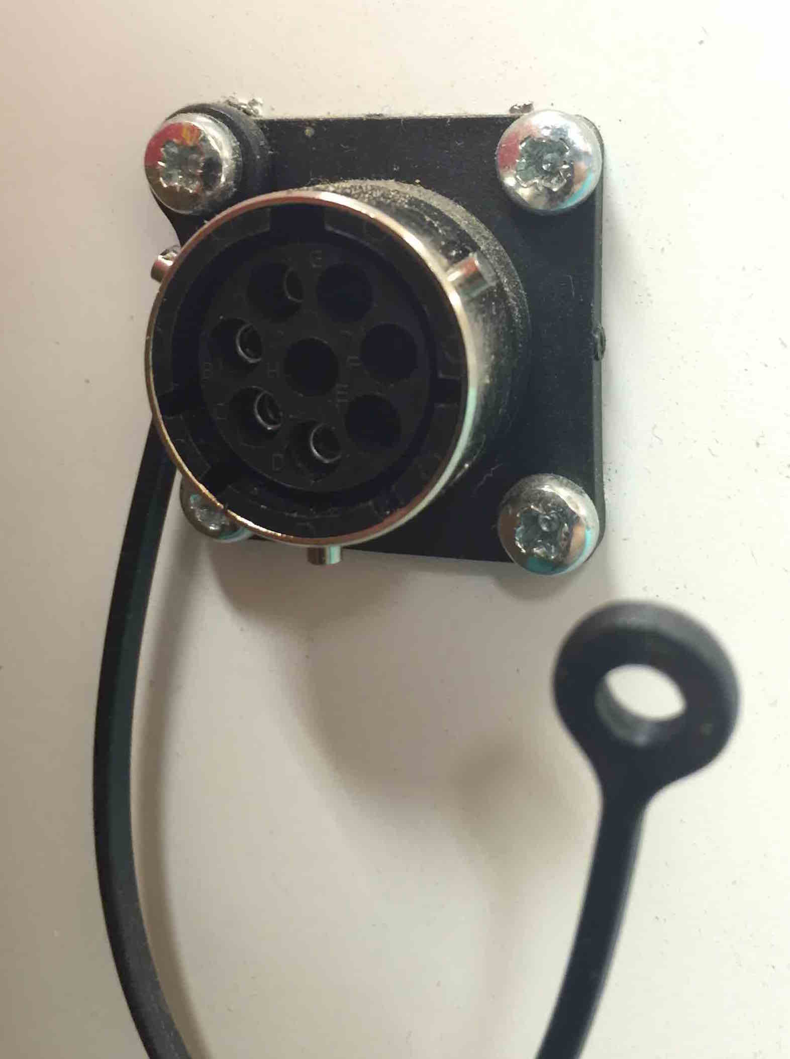

Left side plug
Left side plug
Power Cable 1.jpg (98.79 KiB) Viewed 22272 times

It should be a Micromill.
The socket you have in the picture is the robot port. The only power it should need is the 110volts kettle plug.

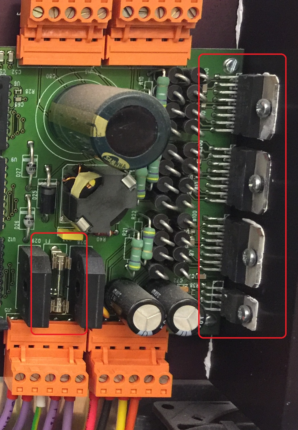

Can you check Fuse F1 on the Denstep control board.
If it has blown then check the drive transistors on the right for damage.
